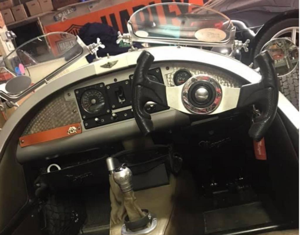

Like when I had an MTW, I find that I don't really like the original steering wheel of the MS3 coffee :

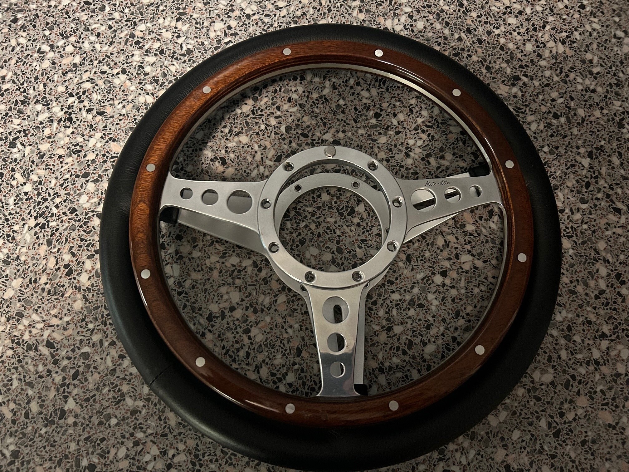

I plan to install a 12 inch motolita steering wheel dished, Dark Brown finish, to follow with the Brown Velvet dashboard :

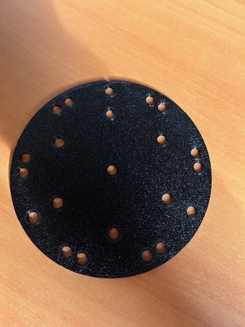

However, I will have to create a new plate, because the original steering wheel has 6 holes, the Motolita 9 holes....:
J'ai commandé ce modèle chez Motolita :

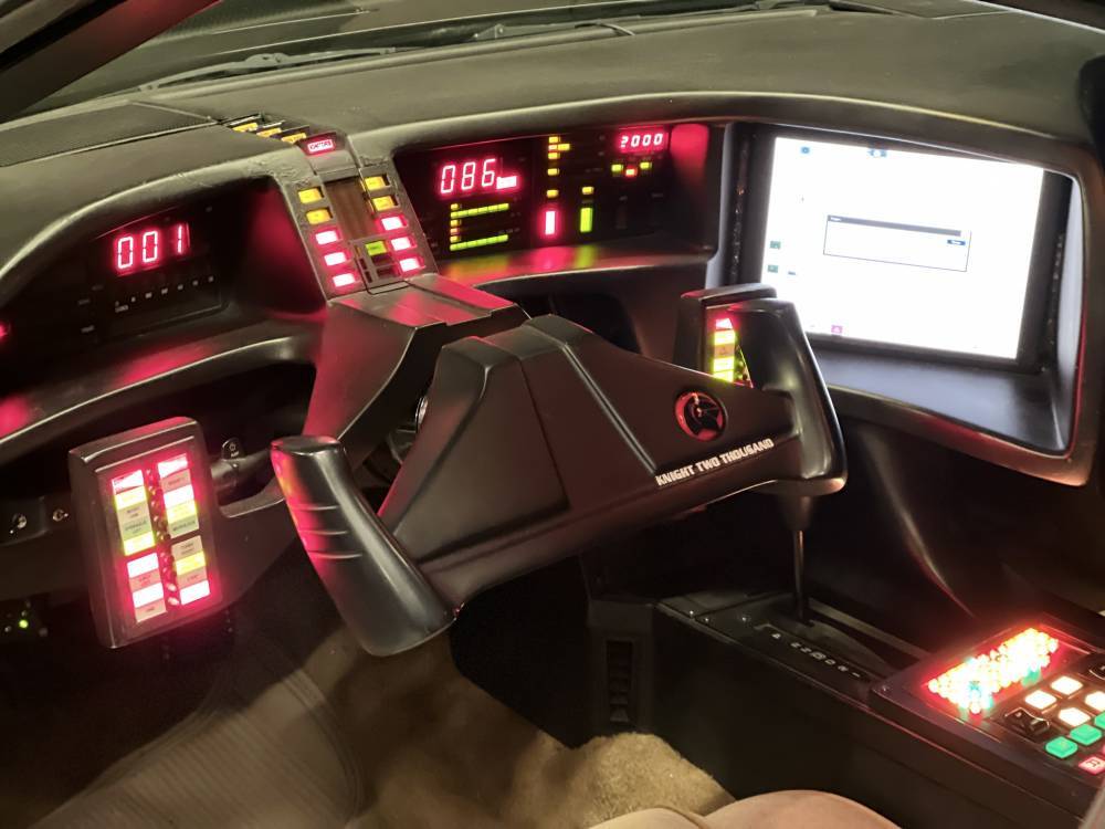

Like K2000 drive

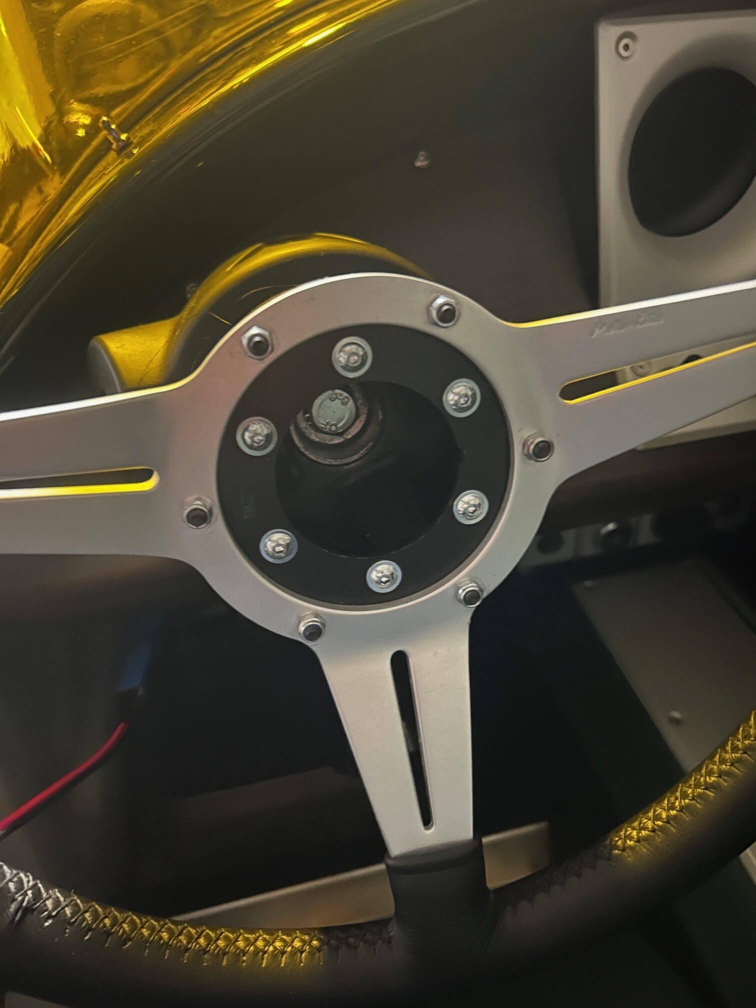

adapter plate for 6 and 9 hole steering wheel :

Like K2000 drive
Knight Rider for the rest of the world wink

Not too unlike the dash and steering yoke in Tesla`s design...?
Though I suspect that electric steering control may be necessary to make compensations, that direct drive might otherwise limit..?
Posts: 8,678
Likes: 491
Posts: 8,678
Likes: 491
Looks like his Windows 98 login screen has just crashed innocent

edition of the part in 3D printing before manufacturing in laser cutting coffee :

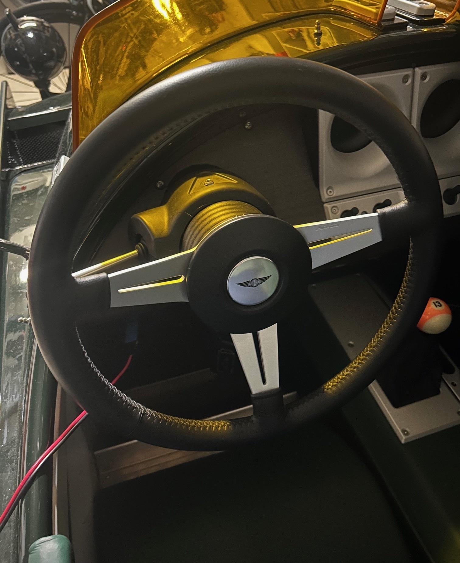

stainless steel 20/10 :
