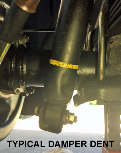

I thought I'd firm up the shocks while I had the +8 on the ramp. Turns out the nearside one was shot and had a dent in the top shroud tube so I couldn't compress it to adjust. Prices for Koni replacements are ridiculous, around £140 each! I've just ordered some made to order aluminium ones from Protech, fingers crossed. PS: I can't think how the dent arose, there's no damage to the timber frame adjacent.

[quote=CJB]I thought I'd firm up the shocks while I had the +8 on the ramp. Turns out the nearside one was shot and had a dent in the top shroud tube so I couldn't compress it to adjust. PS : I can't think how the dent arose, there's no damage to the timber frame adjacent. [/quote}]
It is a typical dent from a severe bottoming out. They can appear at either end of the damper. It eventually happens to all shocks, even the right ones, when they are old and they no longer offer as much compression protection. See another pic I just downloaded from the internet on a general shock dent query below, next to yours. It is not from a Morgan but it is the same.

Sorry to see you damper damage CJB. Is that a scuff to the paint on the body if you look really closely? Perhaps just an unlucky external clout.
Unfortunately selecting new rear dampers for a trad is not necessarily straight forward. There is so little suspension movement to start with and each car will have build differences, even from side to side. Also the attachment points have moved over time so very unlikely that one size could ever fit all. When I was doing my Morgan damper investigations I saw several of the popular brands offered with less than ideal lengths for my car. Regardless of which manufacture is chosen, its critical to have the right open/closed lengths to suit the car to avoid constraining the suspension movement, damage avoidance and comfort.
Just for the record, when I removed the ‘budget’ factory fitted dampers from the my previous car I recorded their lengths. Whilst the quality was not the best , the open and closed lengths were really quite good and hard to find a match. Open at around 11.75” and closed around 8”.
