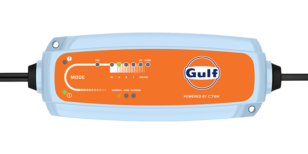

Mine is a Ctek CT5 TIME TO GO GULF UK
Ctek - Gulf Edition
This has an AGM function which is what I have always used on the Aero's, I charge via the cigarette lighter adaptor as that seems to be the best way for me and never had any issues with the old one being left on 24/7 - so I can only presume the battery or starter is a dud!

Nick you mention using the AGM setting? I am not aware of the S1 Odyssey model but the S2 onwards just used a normal lead-acid model and not an AGM one as I understood it. So the AGM setting on the charger would not be optimal?
I have used a CTEK 5 on standard setting and maintenance mode pretty much forever. Interestingly the S2 can go ages with a boost but the Coupe cannot go 2 weeks.

Good point Alistair, my old S1 had an older battery which I check was AGM - being totally honest I have not checked the current one as presumed it would be the same based on the age etc, but I will go and check!

Ok so had a check, photos confirm my old S1 had an Odyssey PC-925 which was AGM, new battery in the GTN is a Full Throttle FT410 PC925 also AGM.
Interestingly the old S1 battery I think reading the sticker albeit not entirely clear was dated 2008 (casing manufacture I believe so guessing 08/09)! The new (suspected troublesome one) is 2022...not sure if thats luck or just speaks for the quality of Odyssey!
