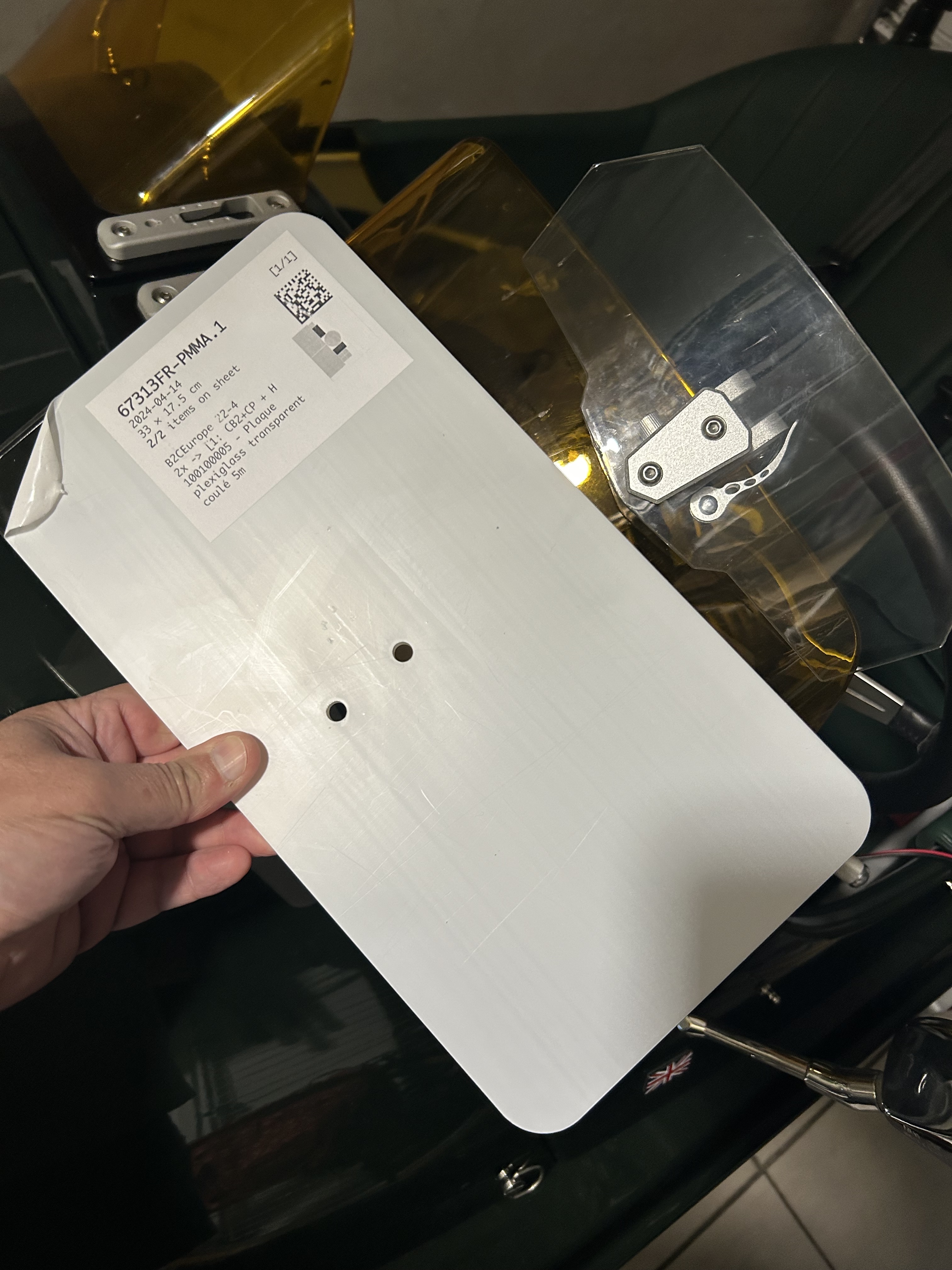

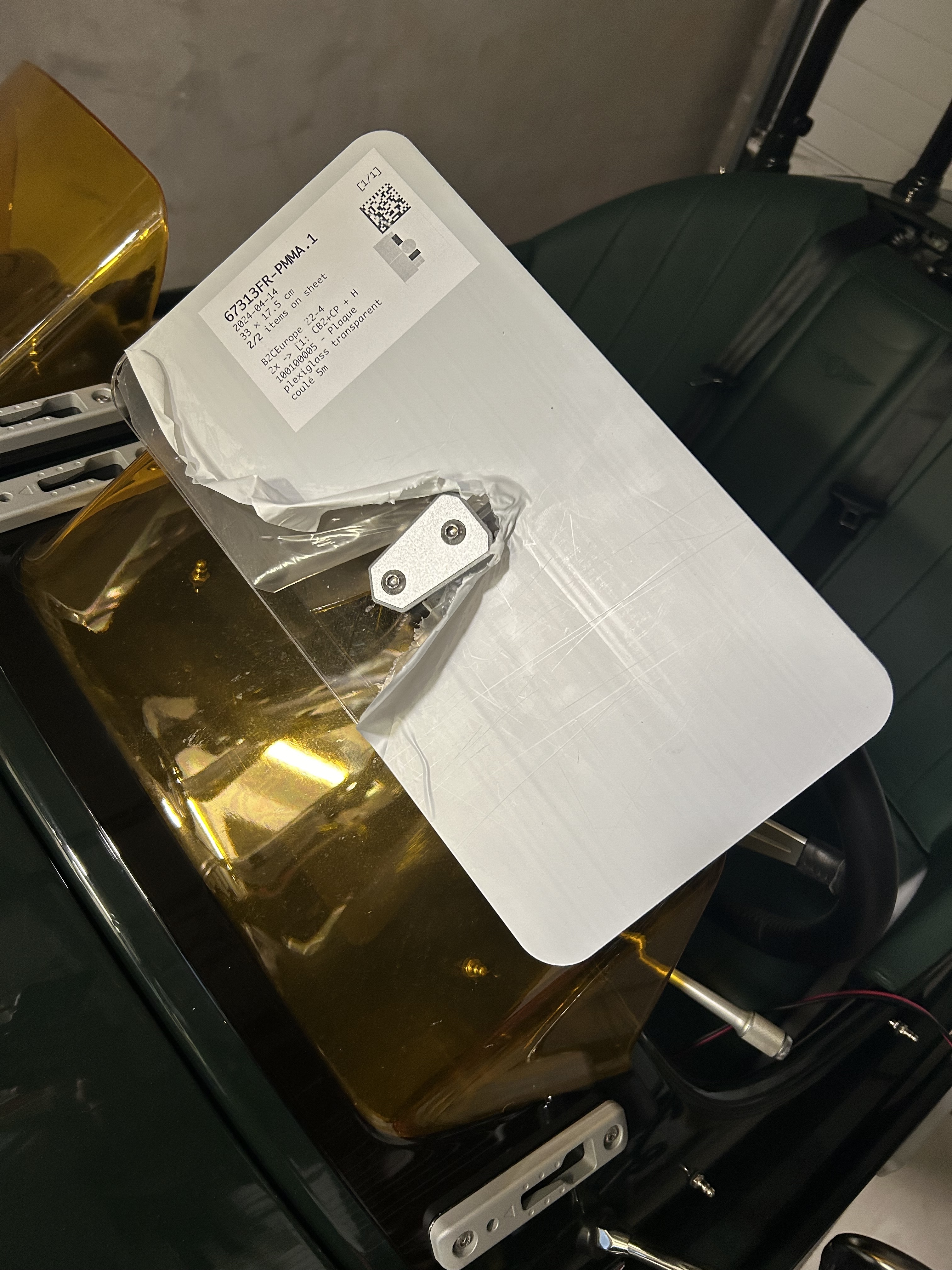

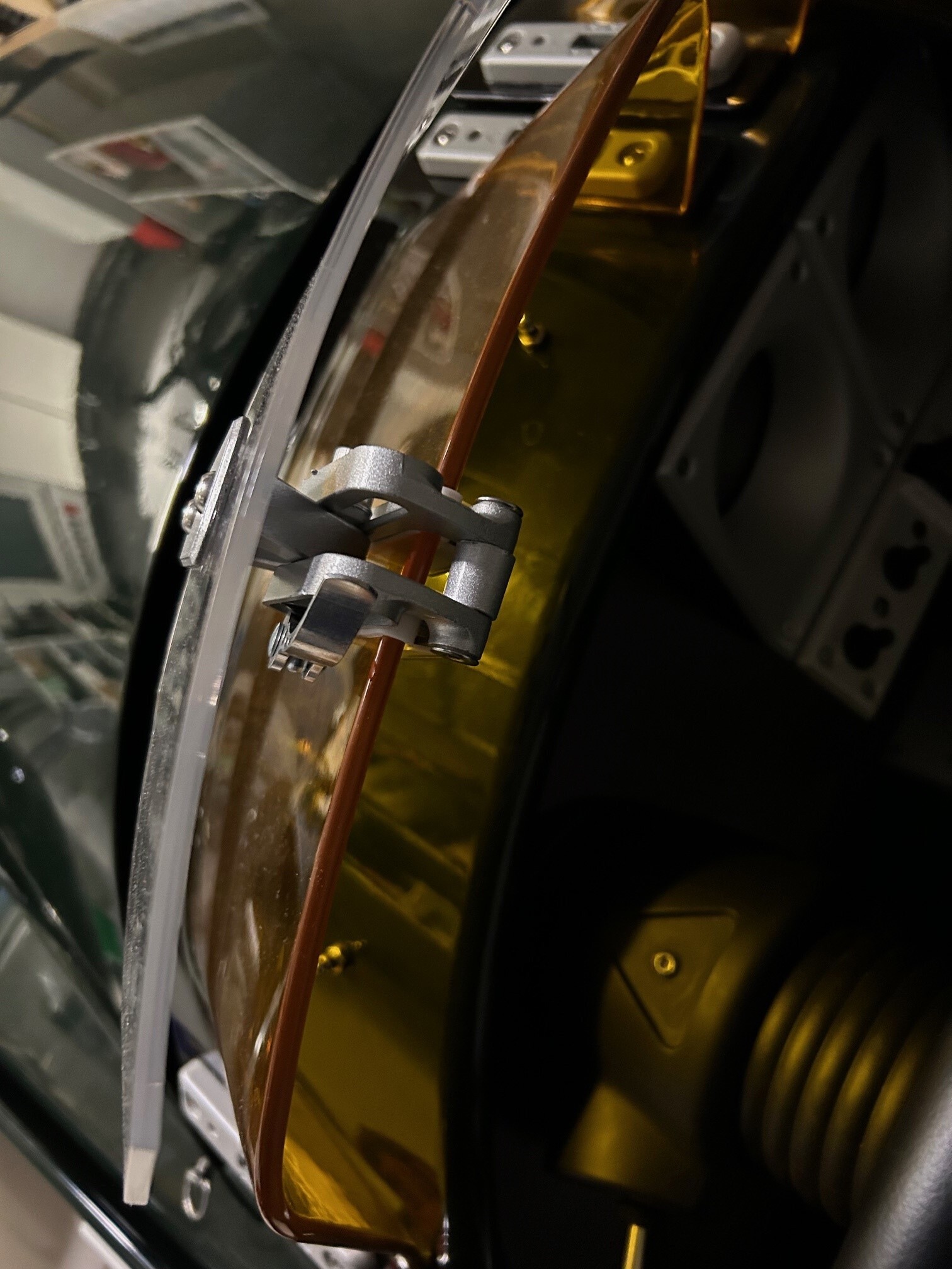

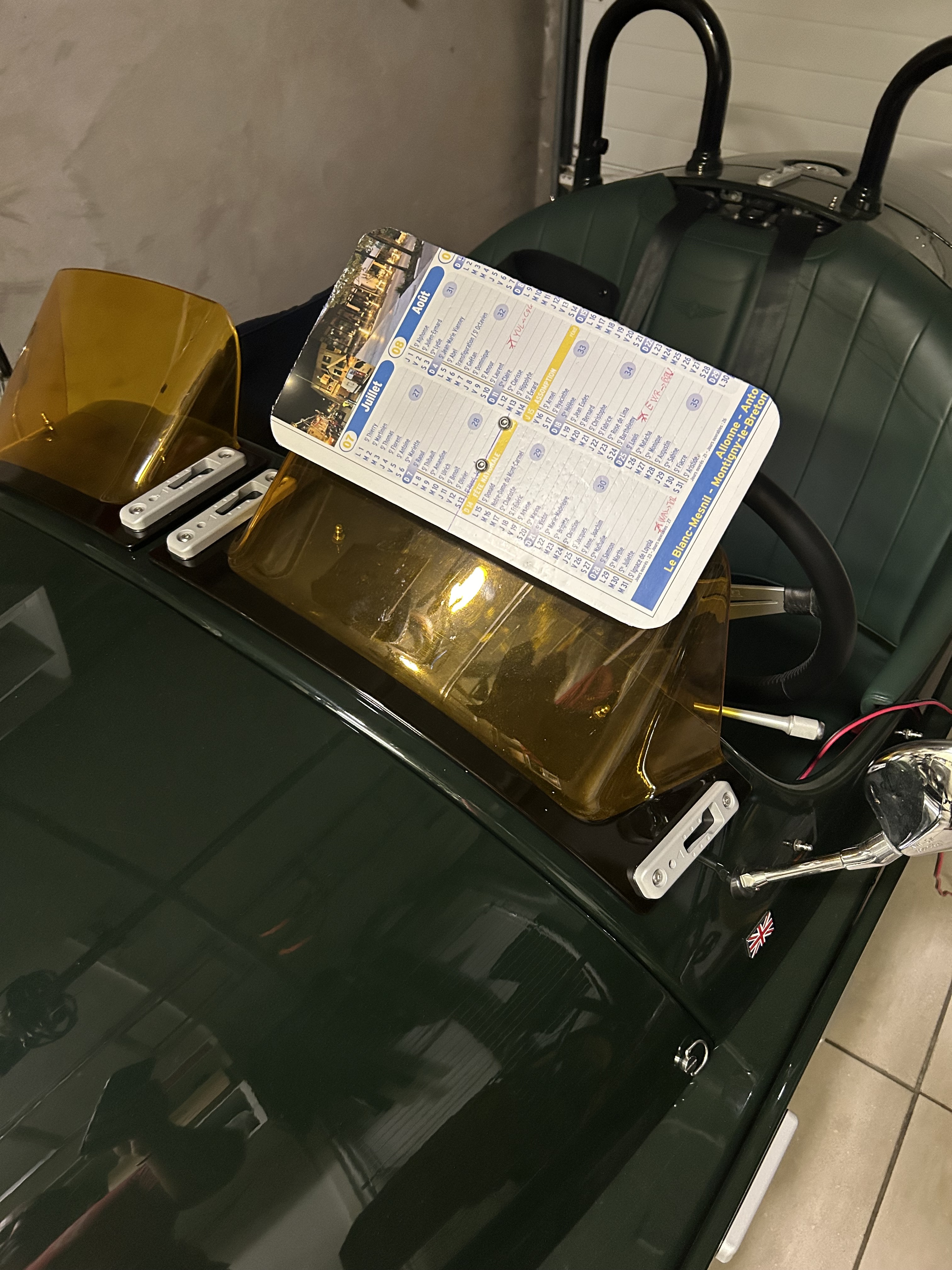

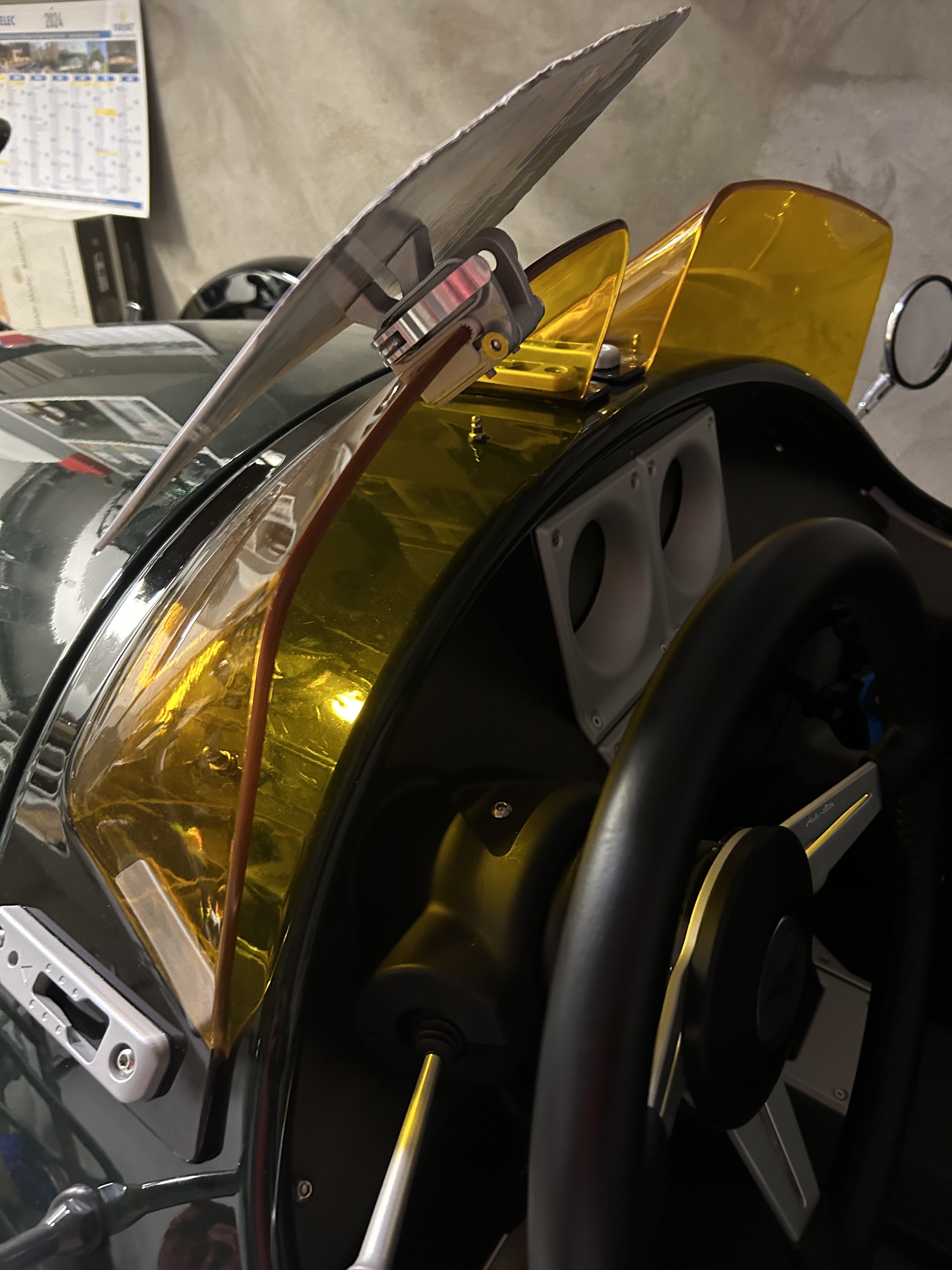

Additional deflector project for the MS3.
I use the attachment of an additional deflector intended for motorcycles, purchased on amzaon, and on which I will adapt a custom plexiglass window :

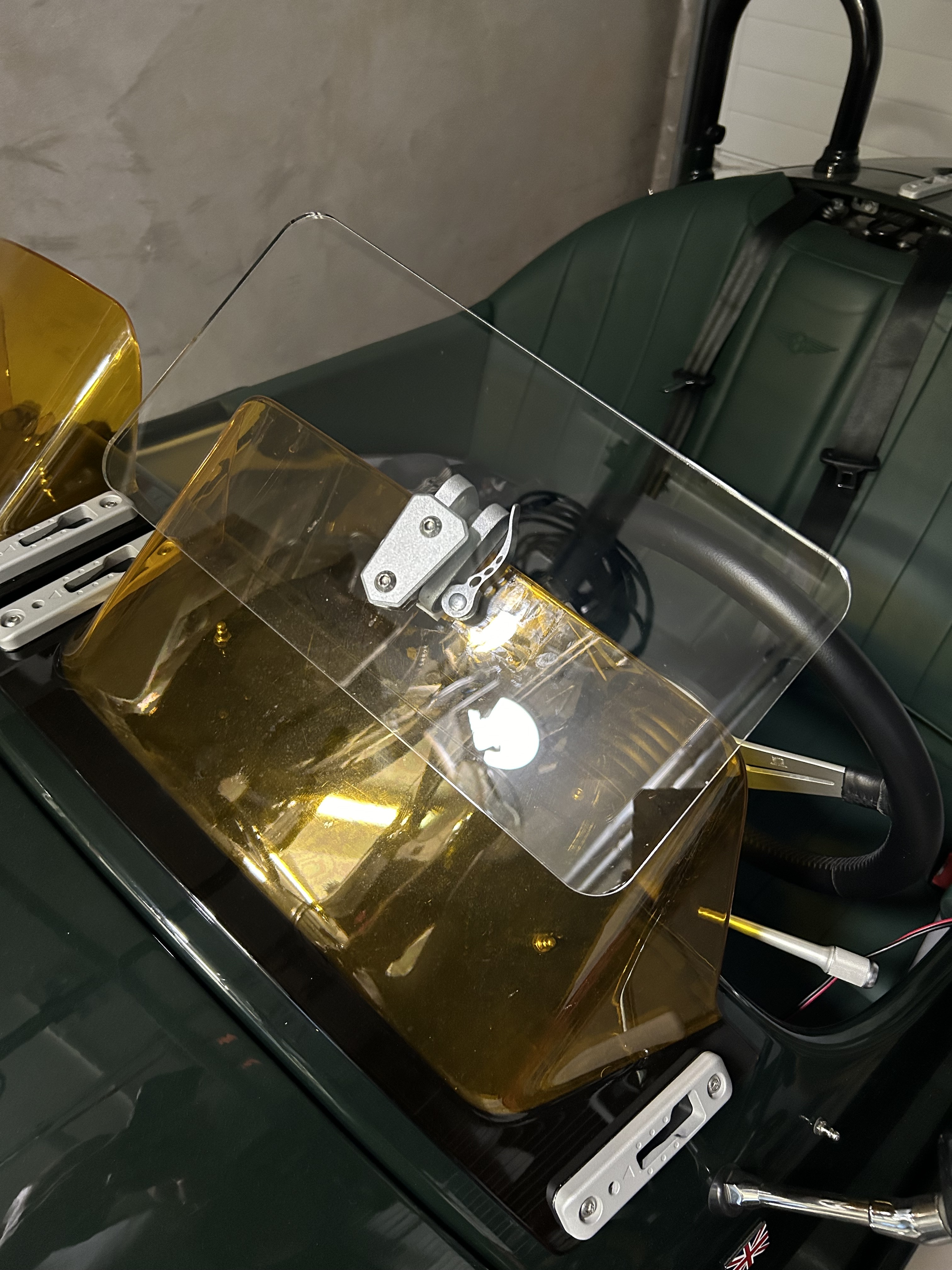

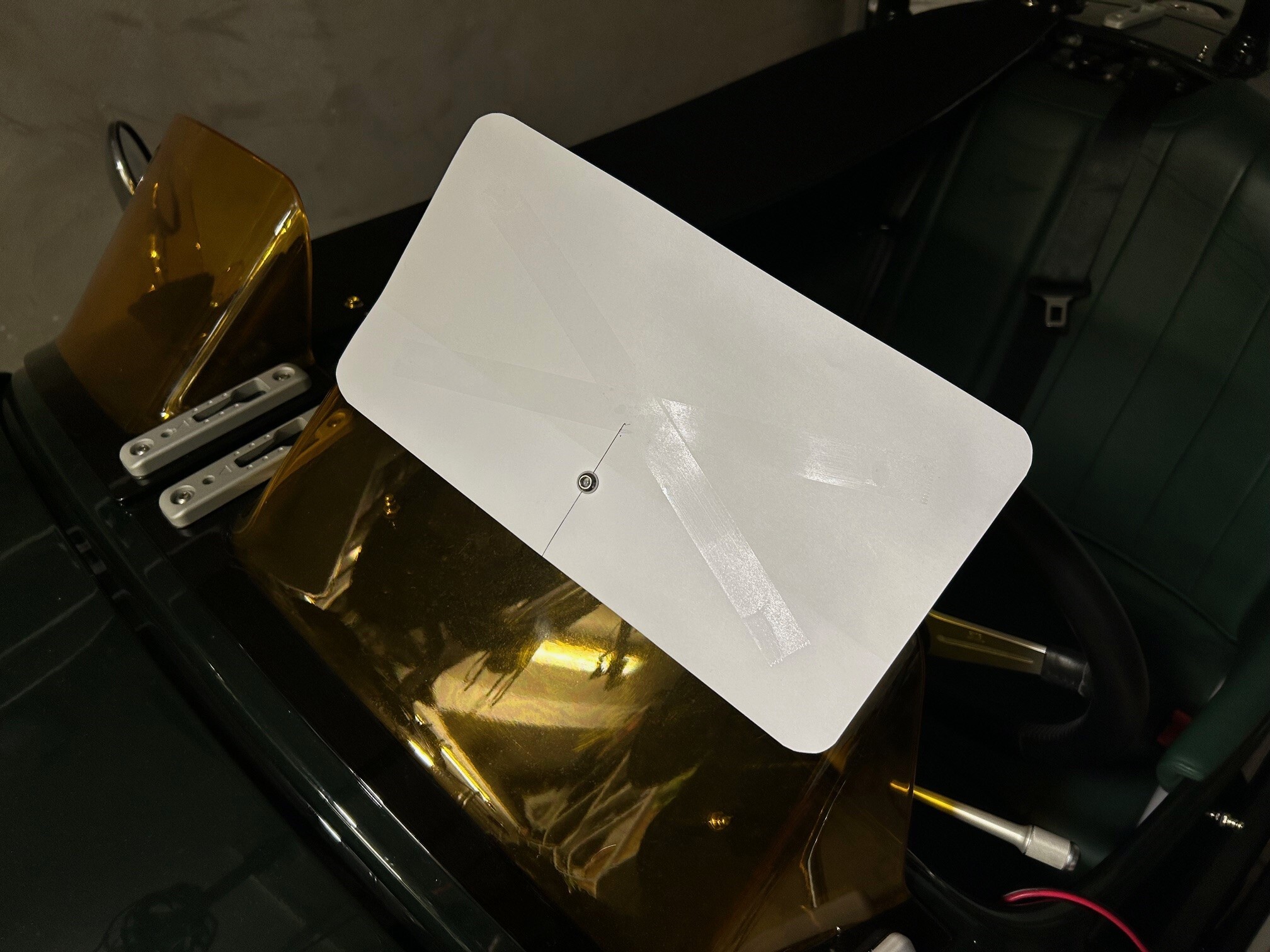

Test V2, size : 33cm x 17,5cm :

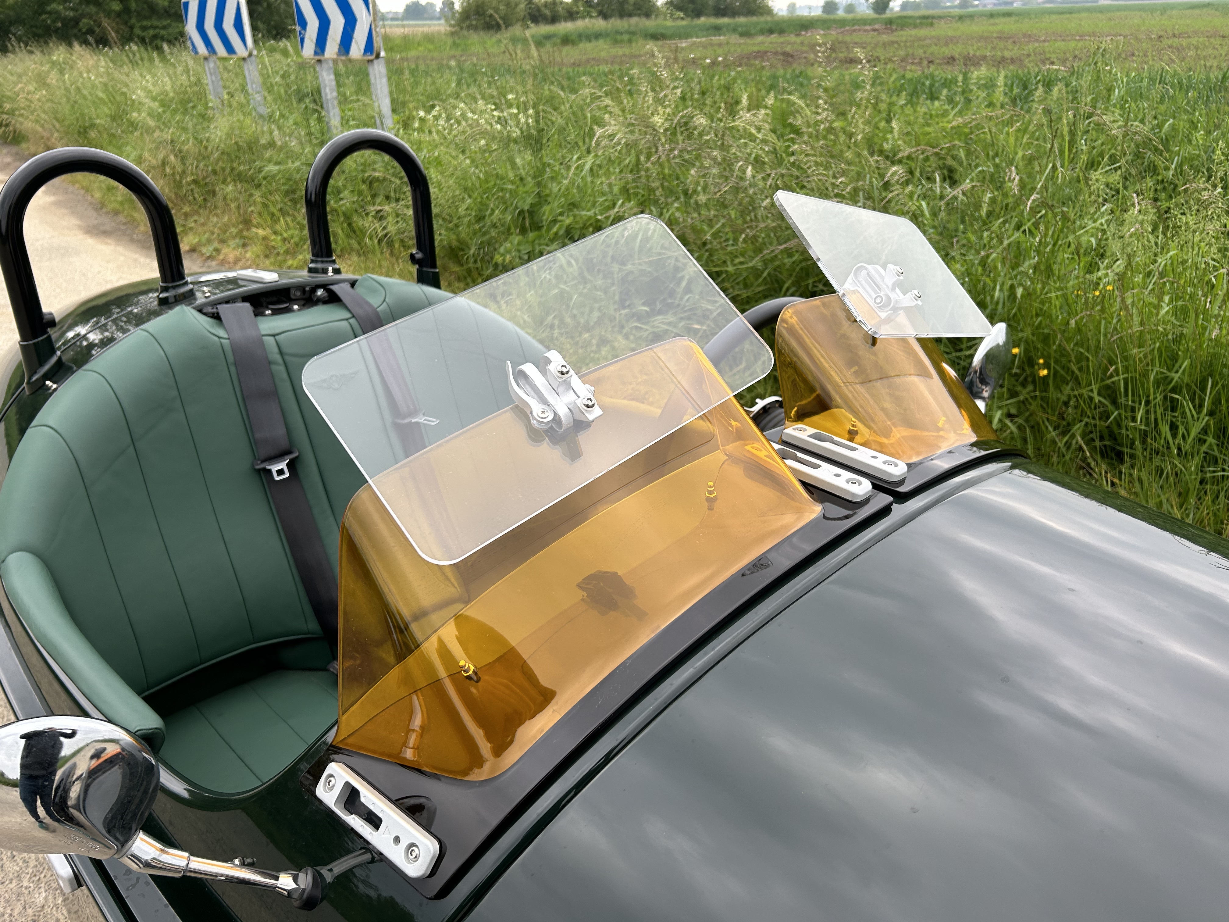

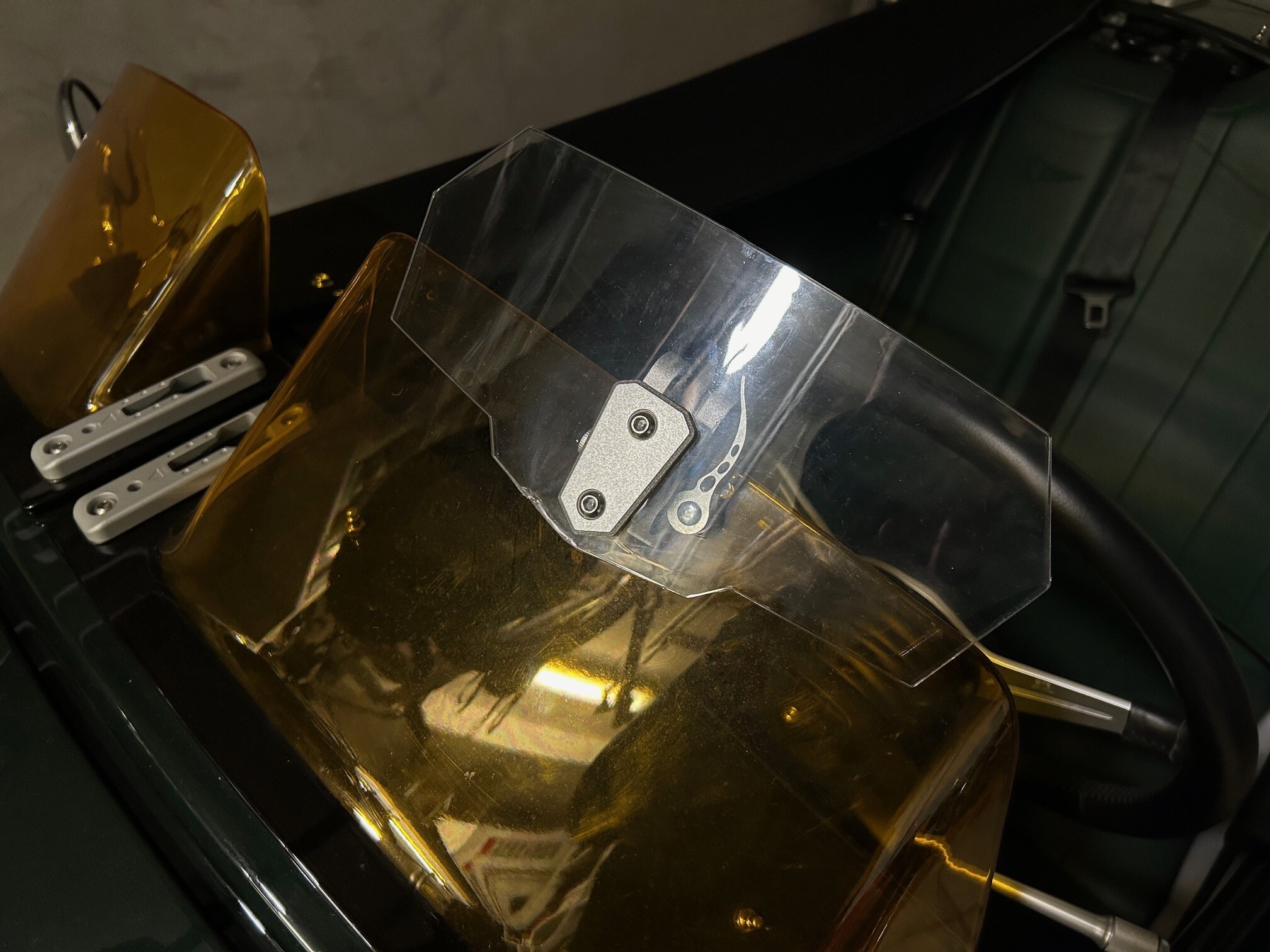

Nice ideas!
But I would prefere PC (Lexan for example) instead of PMMA (Plexiglas etc.)
PC is slightly more shatterproof than PMMA..

it's much more comfortable with this new device, because the original wind screens are much too low... 👌🏼

You have a metal clamp right in the middle of your view, I don't think that is a good idea at all

Originally Posted by RichJames
You have a metal clamp right in the middle of your view...
For us tall folks the conventional S3 screen is below chin level. So this is hardly ruining your line of sight of the road...
...I don't think that is a good idea at all
There may be a better solution... for example Peter L built an entirely new screen for his S3. Of course Morgan seems determined to be super tardy with its official Super 3 large screen.
