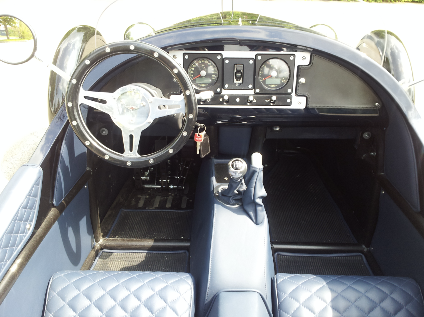

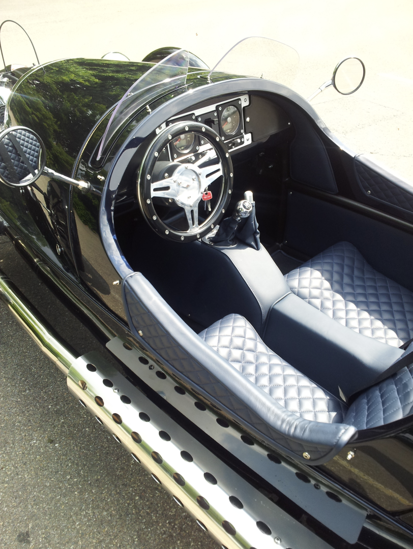

Discomfort with the factory transmission tunnel, which is uselessly oversized, IMHO, led me to fabricate a closer fitting tunnel that adds loads of room to the interior. I posted on this some years ago, but can't find that post, as it appears it was part of a thread someone else had created. In any case, see the attached photos which show the GRP cover I fabbed, before it received its final finish coat of medium gray hammerite. Note I also relocated the shifter forward (as all later cars) by removing the somewhat bizarre shifter relocation mechanism that Morgan appended to Mazda gearbox.

Nice job Bits O'.
I'm reminded of the Morgan Park narrow transmission tunnel:
Andy

Yes, a narrow and lower (at the rear at least) gearbox cover makes so much more sense in such a small vehicle.

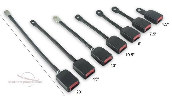

Wilson, an easy mod to help with the belts is swap out the current super short receptacle for a longer one. They are available from seat belt suppliers in various lengths. The ones I fitted are about 18cm long, and make it so much easier to 'buckle up'. I think I've posted photos somewhere here on the forum. I bought mine in the U.S. but there are British suppliers, at least, that sell similar.
https://www.seatbeltplanet.com/images/F198645978

Whether changing the bolted in receptacle or using clip in extenders check they are for a Type A tongue (21mm) and NOT a Type B which is 25mm

i use a 25cm rigid extender which makes clipping the seatbelt in much easier. The buckle is how in front of my hip rather than having to twist and scrabble around by the seat base.
