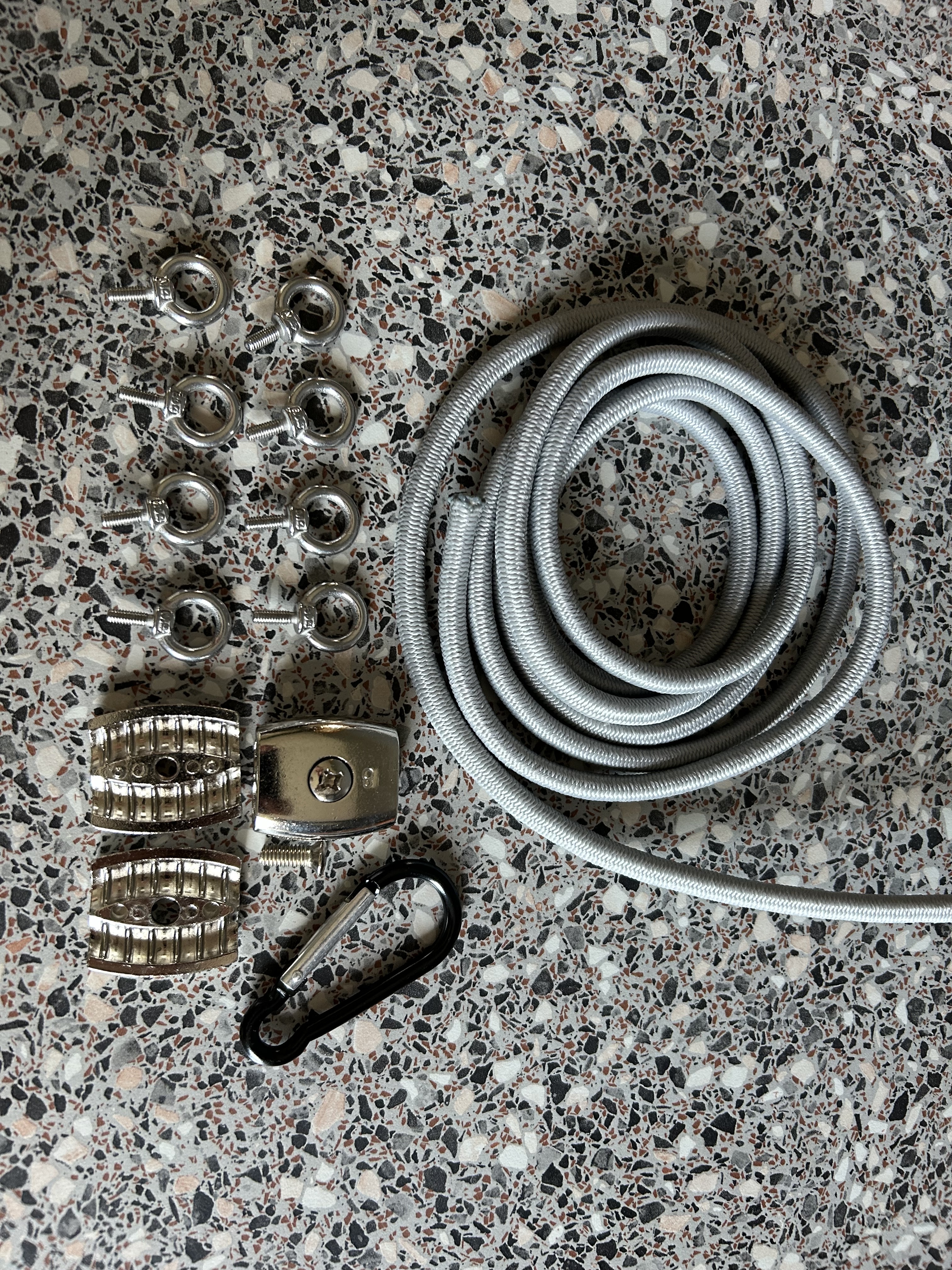

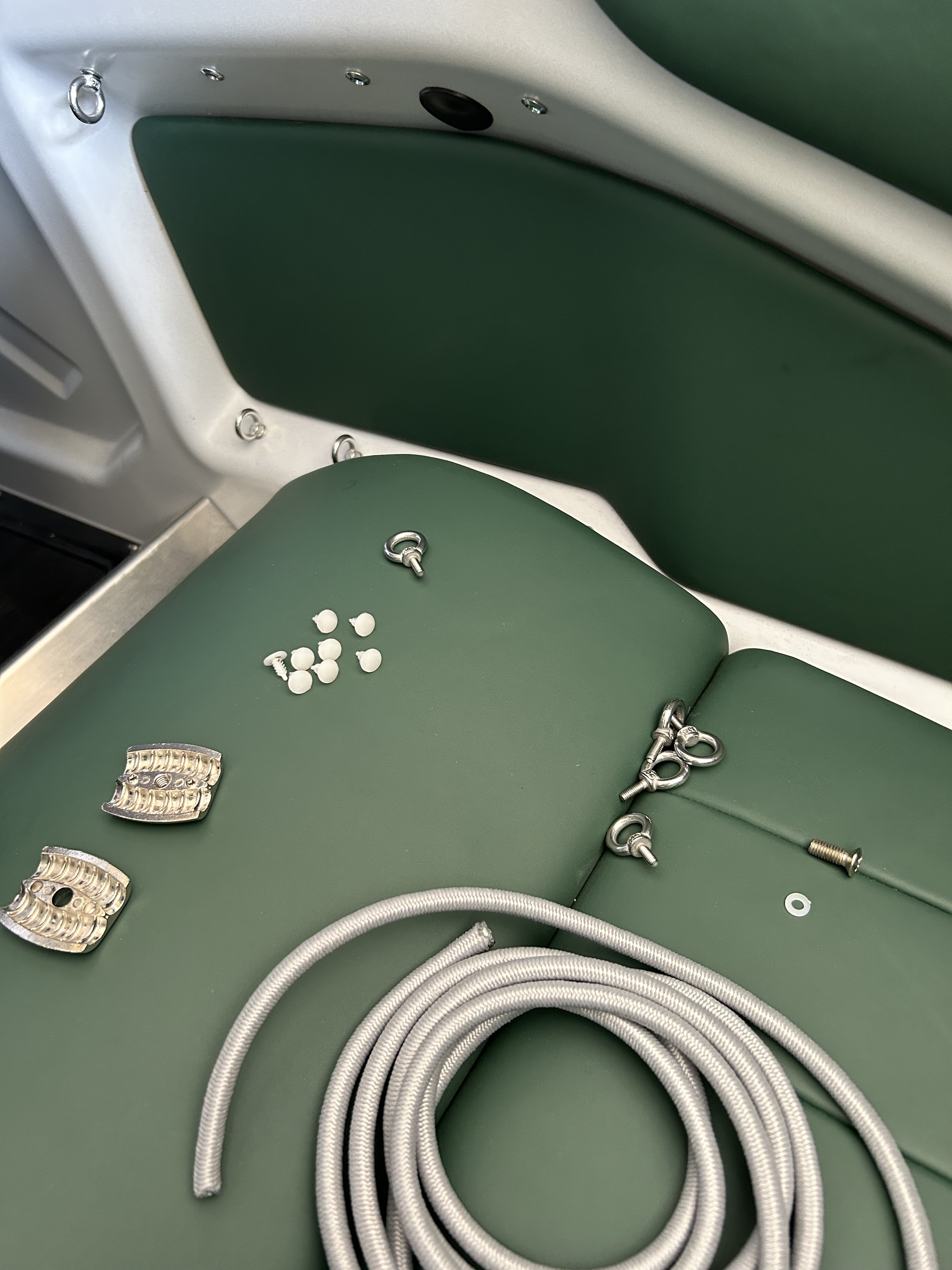

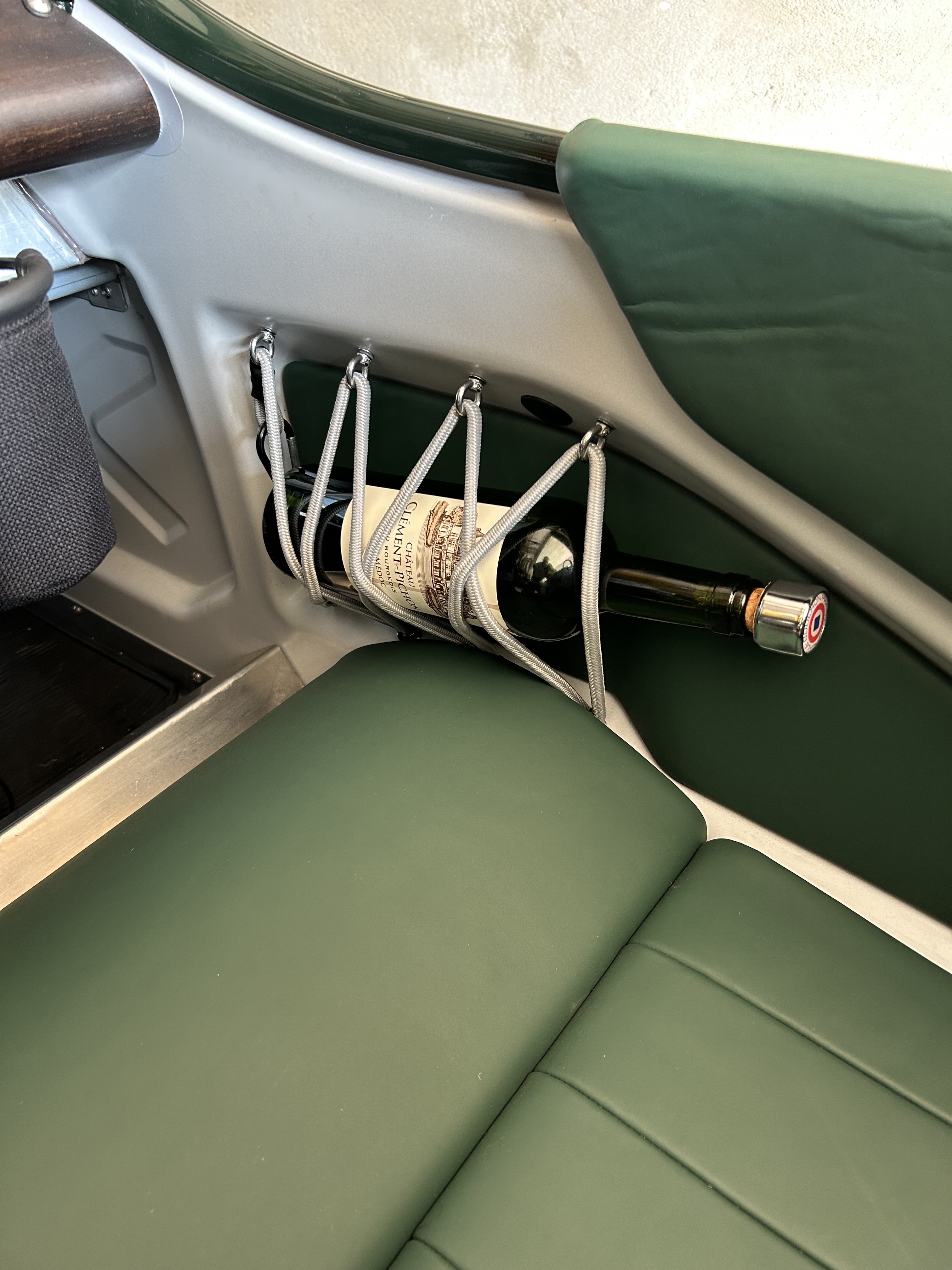

cheap empty pocket for MS3 🤑 :

Don't accelerate too fast laugh2

Any details of where you bought the supplies and sizes etc.??? I want to install this in the car when it gets to my home

- The eye nuts are made of stainless steel, size M4
- the elastic cable is purchased by the meter in a DIY store, diameter 8mm, allow approximately 150cm
- A small mountaineering carabiner
the budget is 20 euros in total, this budget does not include the bottle of French wine wine
I haven't put one on the driver's side at the moment because I'm afraid it might be annoying when driving... drive
