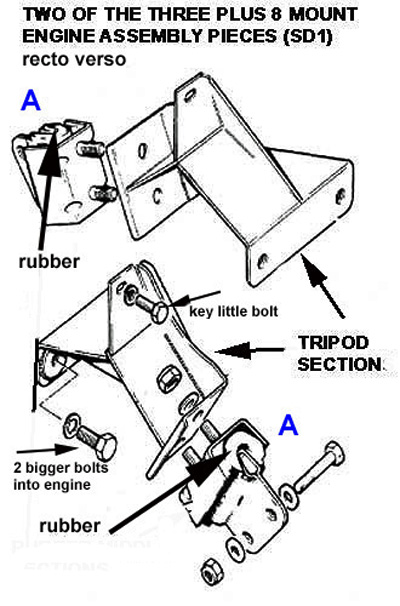

Maybe I can assist you. I have done this job on all my Plus 8s. Twice because the mountings were rotting and once because the super important little 7/16 or 10mm bolt on the engine part of the three

[b]So that is your jack point. I use towels between a wide plank of wood and the sump with the jack underneath. [/b]
(the oneo n the chassis edge is Morgan specific I think) I am guessing you are replacing the torn or dried out or rotting rubber section of the three piece mount. But WATCHPOINT, even the metal sections
can crack if one is unaware of the importance of the tiny bolt of three the section which attaches to the engine. Without the little bolt in place and tight, the two bigger bolts (please change them to graded bolts)
create a wobble plane which will rock and split the metal of something. and likely strip the threads of the little bolt's hole. frown So when re-installing it, put at least that one in with a star washer and loctite red, or
better still green. (guess how I know!!!) ( doh

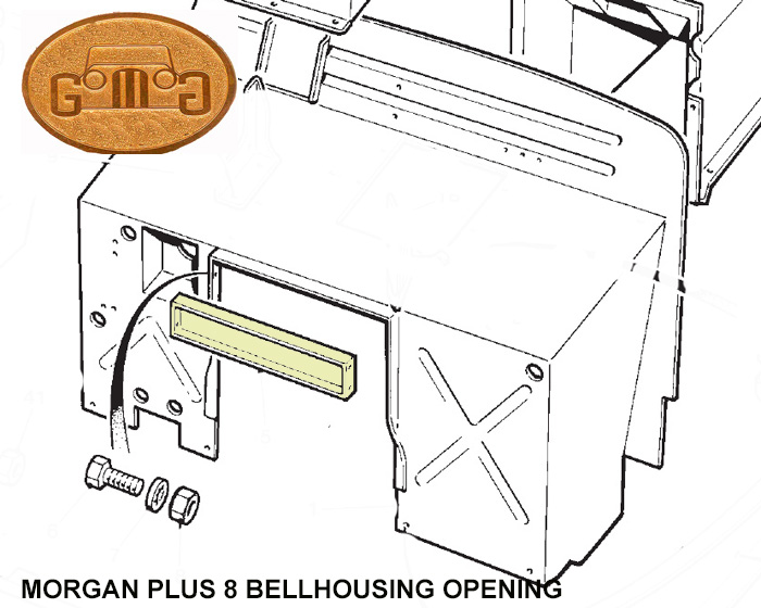

Now for clearance, you don't need much. But if I remember correctly, you must take off the plate that sits at the bulkhead over the bellhousing (pictured below) Because the moment you jack just a a bit, you will
crush it and be justifiably unhappy for a few days. As for the rest, I would remove the upper rad hose, but this is optional I would take the upper rad bolt out or loosen it. Of course, you will have to loosen the bolts

I am adding some explanatory diagrams below. If you have any questions, contact me. I scan Talk Morgan irregularly, but I will eventually get your Private Message here. Or contact me at gomog.
