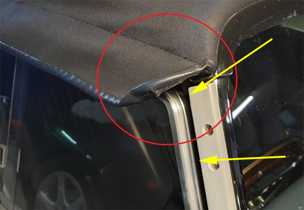

I know we should drive withe the hood down umbrella however the hood has developed these ears not looking that nice. Has there been a successful attempts in straightening them ?

Originally Posted by Cerberas
I know we should drive with the hood down umbrella however the hood has developed these ears not looking that nice. Has there been a

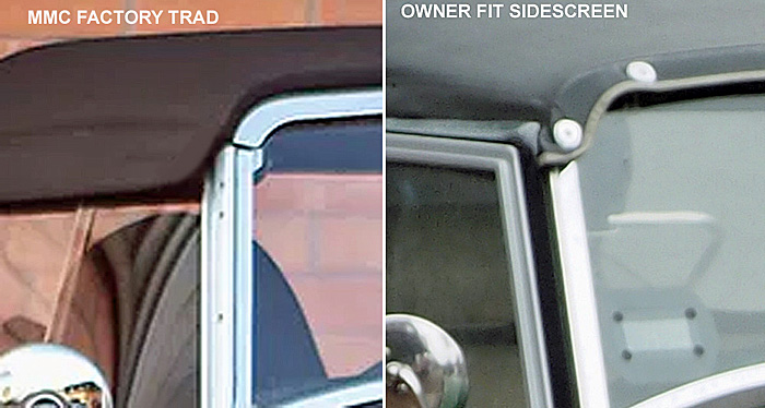

Your problem is a common one. Sidescreens have only two attachments points which creates a single plane. Single planes always have a variety of positions
and, in our case, this expresses itself at the top, where the sidescreen should fit snugly into the soft top pocket and biased inboards. Otherwise an ear will
occur and become permanent and you will often leak. However, nothing needs to be adjusted except the owner. smile After a few years mogging I learned. Merely
pull lightly at the top as you tighten the two attachments. That will allow your sidescreens to sit properly...rather than pushing outward in the pocket as yours are
doing in the image and creating your "ears". We must tolerate the pockets rather than close the doors over them. I applaud you doing that. cheers
Leaking is a function of, how side screens are put on, the lack of the traditional rubber flange and speed. I rate my Morgans by the speed they can achieve
without cabin leaking. I had the Works use the traditional system when they recreated my 1984 in late 2002 which was after they switched to their copy of
the Simmonds hood. That first trad was leakless only until 40mph when it arrived. Now the 2002/3 Factory special is until 90mph and I rarely drive at that
speed on the byways I enjoy most but it happens the odd time I use a Motorway. .
Pity, just as the Factory got it the old weather gear perfect, (7 decades) they changed to another system!
Love your top's color!
Here is your image (below) showing the cause of your problem. Look how far away it is from where it should be seated! This is an easy non-invasive fix.
https://www.gomog.com/allmorgan/allmorgan31.html#PROPERLY
