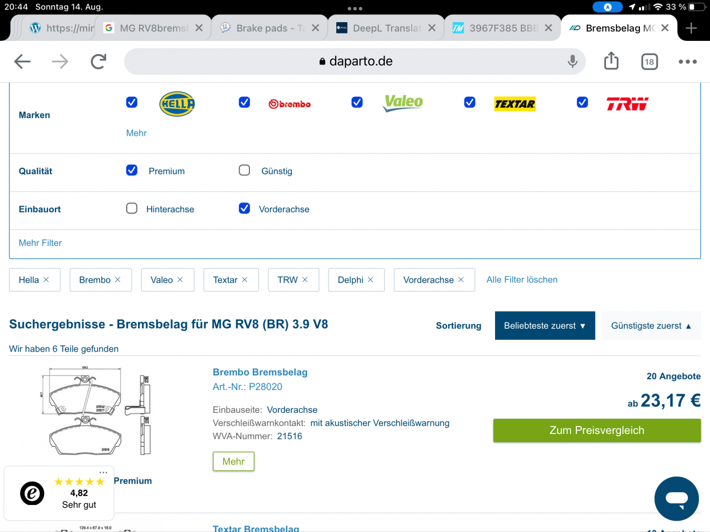

This thread is about high quality brake pads. Therefore, I do not really know if this post belongs to it. I looked at the Mintex catalog because I wanted to see if another car had the same type of brake pad. I came across the 90's MG RV8.
I don't get any hits on the Morgan. When I search for brake pads for the MG RV8, I get a lot of offers from well-known manufacturers. These are not special sports or racing pads but there are good reputable manufacturers among them. Why should I not try out how the 790 kg light car drives on the road with good standard pads for 20 GBP.
https://www.daparto.de/Bremsbelag/MG-RV8-BR/3-9de2ad3f-1549?page=1&f=eyJtYW51ZmFjdHVyZXJfaWQiOls2NzMsNzA1LDc3NSw3OTIsNzk2LDY1N10sIkVpbmJhdW9ydCI6WyJWb3JkZXJhY2hzZSJdLCJkZWxpdmVyeV9jb3VudHJ5IjoiREUifQ%3D%3D

Heinz, if you scroll up to my post dated 12/3 /18 you will see why you did not get any hits for Morgan in the Mintex catalogue!
Also, the pads in the advert you showed for the MG RV8 do not quite look to be the correct shape. Edit: just looked up the Ferodo listings and it looks like the ones you have shown are for the REAR, (FDB917), so I guess these cars had disc brakes all round.
The correct shaped pads (FDB832) were once used on the Austin Princess.They have a couple of shoulders along the top edge for the H clips to locate onto.

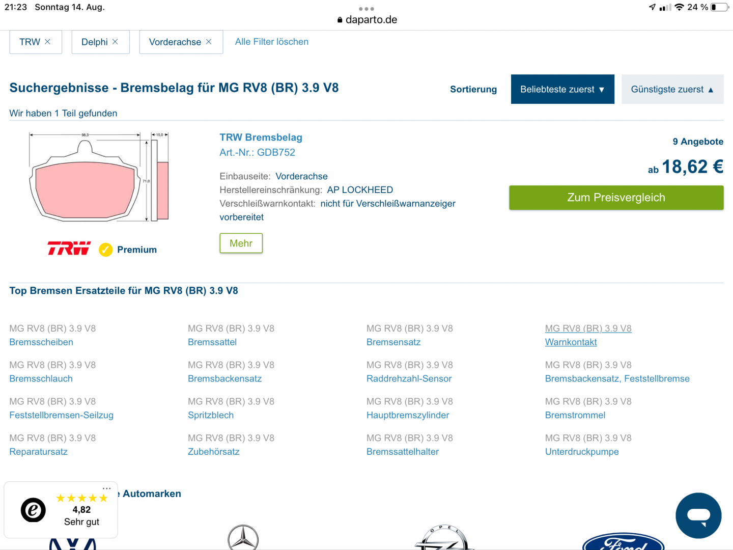

Other alternatives
TRW: GDB752
Ferodo: FDB833
Unless you do track days or are a particularly hard driver, personally I see little point in spending a lot of € on “upgraded pads” Performance pads invariably need some heat to be really effective and also with the weight of a Morgan, I think ordinary road pads are more than sufficient.

Doug, thank you very much for your informative tip. In fact, the brake pads from TRW with the number you mention are in the list whose link I had sent. Then I take the TRW GDB752 to be sure. Obviously, these lists of Internet providers are not really useful. Especially since only with the TRW brake pads explicitly AP Lockheed is noted.

Doug, the German text says "Vorderachse" which means front axle with the Brembo brake pads in the picture. Obviously wrong. But anyway, with the TRW GDB752 I am correct. Thanks again.
