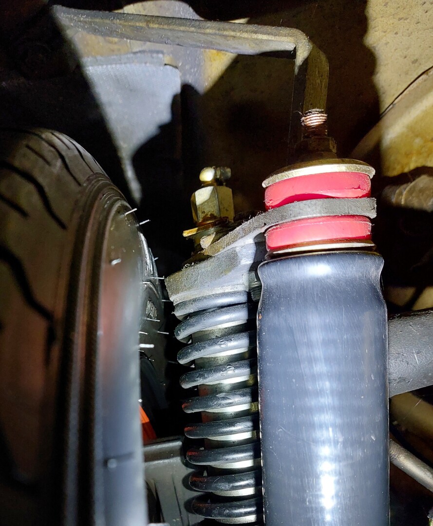

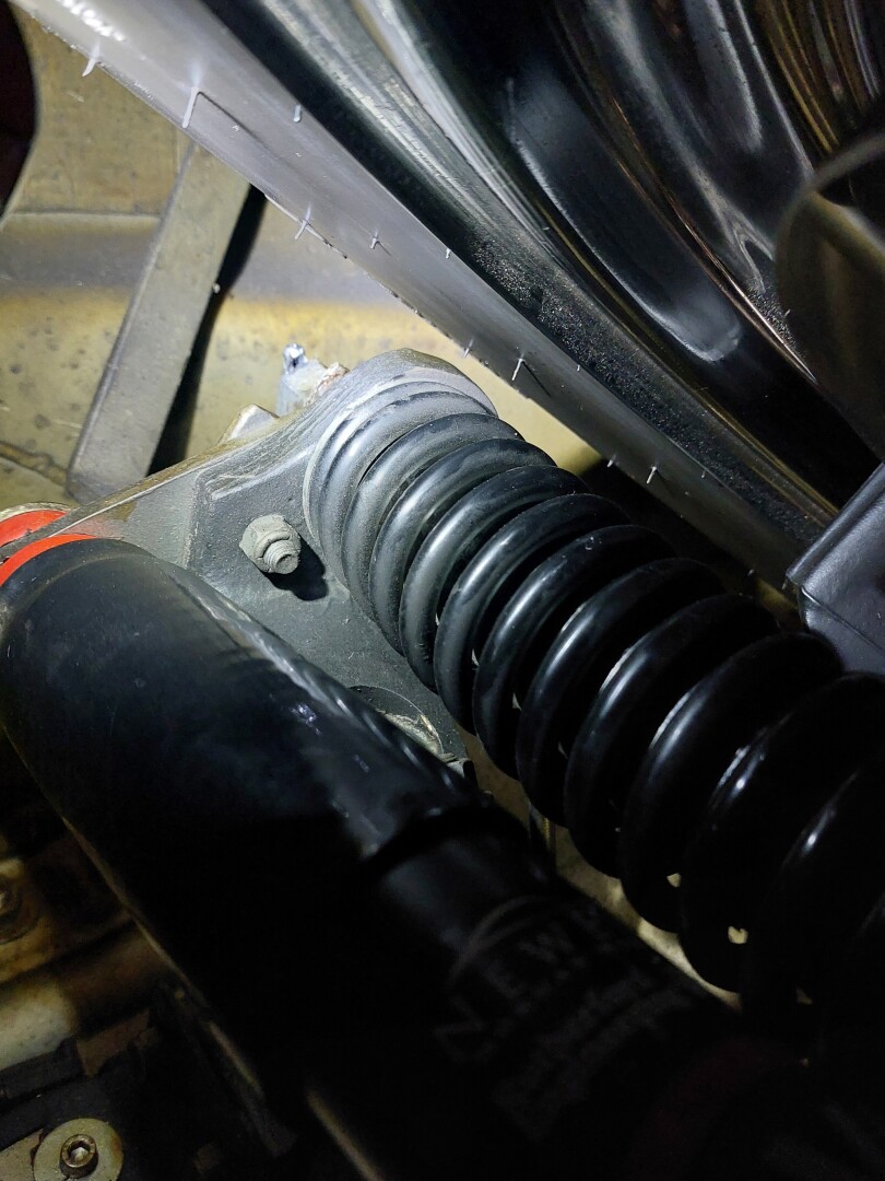

It's difficult to get a worthwhile image of the sidewall clearance to the upper spring mount, but I managed it. This is 2016 Narrow Plus 4 so 4/4 stainless wires, with 185/70s. I hope that it gives a realistic illustration.
Nearside (apologies for the crazy angle)......
Offside:

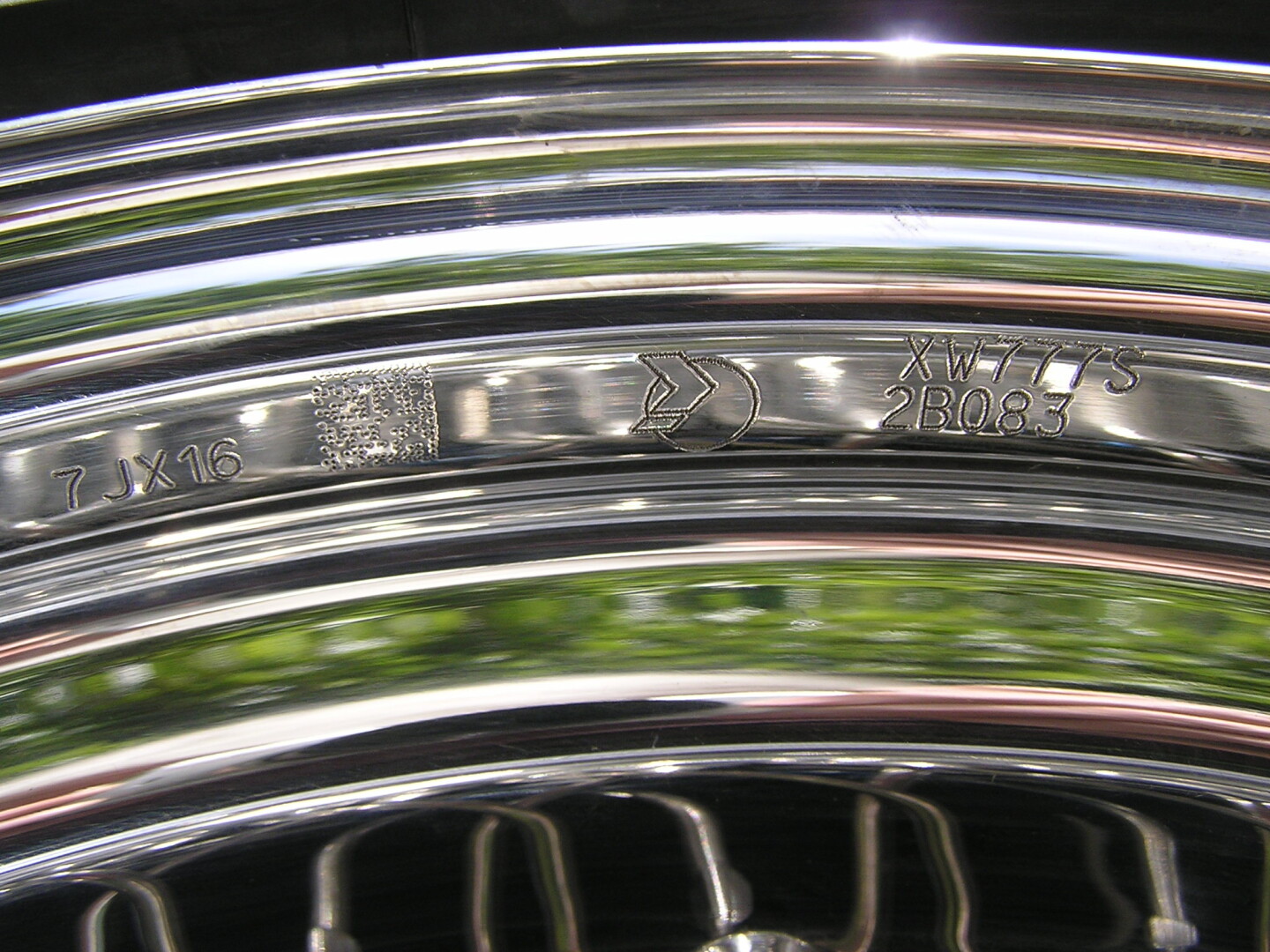

I don't claim to be an expert, and it might be the camera optics.......but the curvature of your tyre sidewall just looks wrong to me. My wires/tyres don't look anything like that. I had to remind myself about tyre/wheel combinations and what can go wrong, for example https://www.rimringz.com/tire-too-wide-or-too-narrow/. What size are your wheels ? There should be a size stamp somewhere on the rim.

Narrow Plus 4's were delivered with 185/70 Avon CR6ZZs on 4/4 rims Peter.
I did try Blockleys but they rubbed the top mount.
