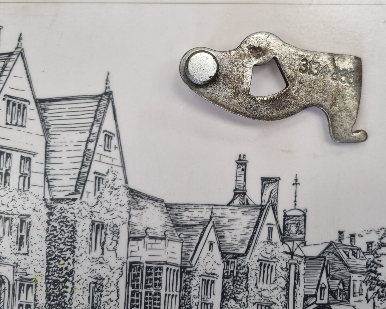

Hoping someone can help me out here....
I'm trying to find a replacement pawl that's used on the self adjusting rear brakes on my 2019 (110 anniversary edition) Plus 4
Matt at Lifes Motors has had a ring round but can only seem to be able to get hold of the entire braking unit (about £250!) when all that needs replacing is the pawl (it works - but misses 2 clicks).
3134-886 is stamped on the item - but doesn't throw up any information I can use when I search on it
Anyone any thoughts as to any alternative part numbers / sources?
Thanks in advance

I read the part number stamped on the ratchet incorrectly - its 3134-860
So found these https://www.ebay.co.uk/itm/174962161994 (LDV Pilot) - and purchased

I wonder if you could get the serrated edge case hardened ?
Posts: 8,695
Likes: 415
Posts: 8,695
Likes: 415
You would need to loose the galvanising Jon.
In any case does the adjuster normally wear that badly if greased?
Ian's one doesn't look so different to new one.

I must admit I was surprised that it was wearing after only 5 years and 12,000 miles frown
