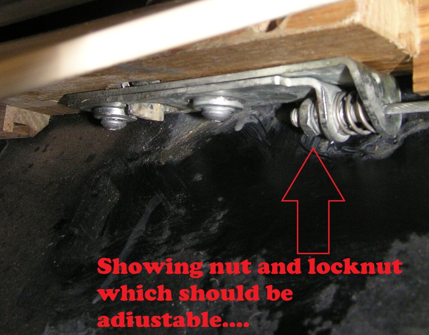

I would think the reason that it (probably) didn't make it into production, is the amount of force it would have taken -- so a solenoid the size of Texas. I was poking about in there yesterday as mine seem to have become stickier lately. I would have liked to tighten-up the nut and locknut that provide the initial tension in the system, but find they are impossible to access with normal spanners and normal-size hands, so lubrication sorted it.

Agreed Peter and it wouldn't have been practical to push down on rear of hood to ease release as you can with lever position.
Note they planned for simultaneous release of catches using individual solenoids though. It could even have worked out cheaper without lever, cable, brackets and adjuster not to mention installation time.
BTW try and get some lube into cable inner as well. There is a lot of friction as cable turns 90° through the routing tube. Also the return springs are collectively unnecessarily strong IMHO.

Having recently replaced a broken cable for a TM member, they are a right pain to access it took two of us a good 2 hrs to complete, it had snapped the nipple off at the pull handle end, but that was because the cable had almost seized at the bend, strangely the link cable between the catches is quite meaty, BUT the other part that takes the full pull load and bend friction is as slender as a bike brake cable
