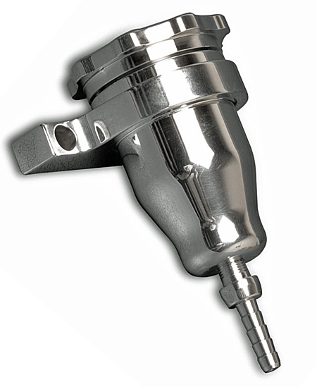

That being said, I have been meaning to replace the MMC's Aero 8 dual purpose brake/clutch reservoir they fit to my Morgan 22 years ago! wink
Tho plastic, it has the standard higher quality cap. Ideally, I guess, one should have stainless steel reservoir, one each for brakes and clutch.
They are very attractive to this besotted nutter fan of shiny metal...and bullet proof. But ideally, they should both have with low level indicators..as
we already have for the brakes.

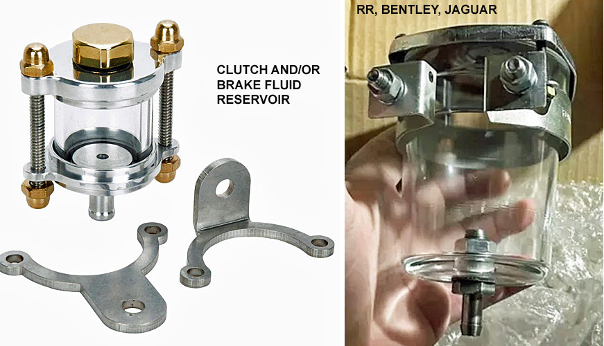

You make good points. A clear reservoir (even cheap plastic) allows one to see whether the fluid has turned colors. However an inexpensive cheap brake/clutch fluid tester is much
wiser. It all depends how vigilant one chooses to be. Dealers will not do this. However, if visibility is desired, there are some pretty class thingies available...Rolls, Bentley and
Jaguar used to use them.
I have now found metal level indicating caps sold alone. And many of the quality ones, plastic or metal, are exchangeable and caps sold alone. Easy to adapt. The nature of
the fluid is not does not make this an area where money should be saved.
I have been using the dual brake/clutch reservoir for some time. I am presently musing whether to continue with the dual reservoir dear MB added to my recreation. I can't think of a
prejudice, off hand. Can you? Is it key to distinguish whether we are missing clutch or brake fluid? Frankly, on most Morgans there is no indication about clutch fluid level and quality
except the owner's degree of attention and a failing foot pedal (the latter being no fun). And there is no harm in better aesthetics.

Thank you Jon. You taught me something important to look for in cars of your era. Dissolved rubber or neoprene could be a brake system killer. I would love to
know whether the MMC cured that subsequently.
I gather you have a remote reservoir. (?) I was sent one after the MMC recreated my car in 2002. Mark Baldwin, a super kind and astute fellow, who was keeping
on an eye on the build, suggested I would need one. He was right. The later braking system requires one if one is using branch manifolds IIRC
.] This is why
they sent me an Aero I reservoir. In the case of the line from MC to remote, I changed the line to heat resistant braided ss on arrival .
I also had a dissolving rubber hose situation in my fuel cell. Normal or neoprene quickly "melts" in petrol as well. In that case, I finally designed a ss tank drawing
on Mulberry advice a few years ago and internally plumbed it with ss pipe. (Yes I have a tendency to overkill...but our children are costless now). laugh2 I keep an
eye on such things more than most. My Morgan mileage taught me long ago that anything that CAN happen Will happen. You have convinced me that glass
reservoirs, like the old expensive ones posted above, are the smartest. If I choose to have level indicators, most of the caps are sold separately and of a standard size.
Thx again. Here is a present.
