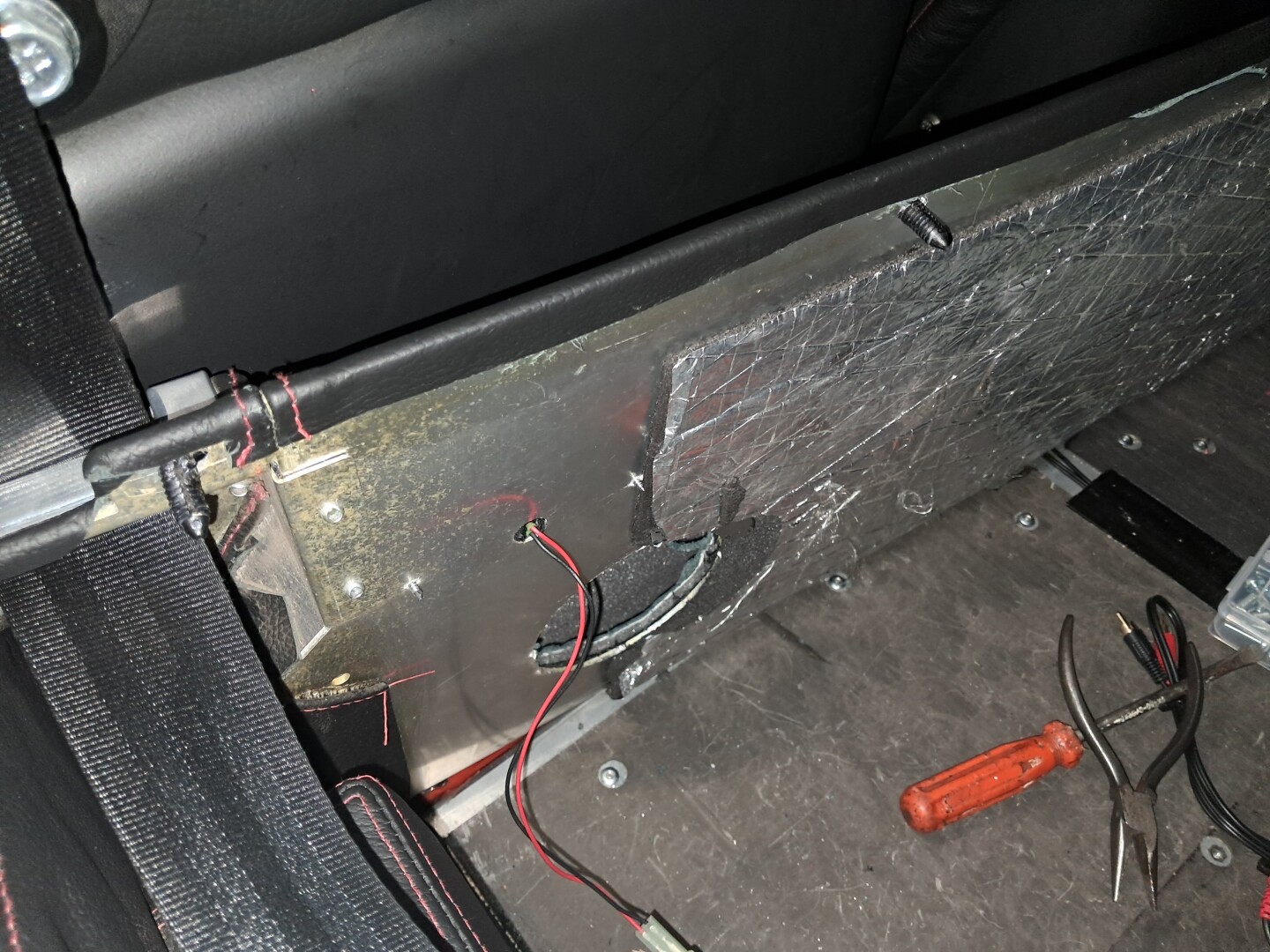

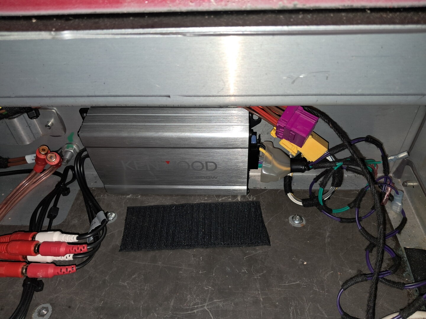

Having secured from a breakers a full stereo system of a 2020 P6 I continued to fit it today.
I already posted fitting the door speakers (here https://www.talkmorgan.com/ubbthreads.php/topics/811187/behind-the-door-card#Post811187) and today I fitted the amp and started on the speakers.
I removed the rear panel and (see how her https://www.talkmorgan.com/ubbthreads.php/topics/809907/creating-stowage-space-on-a-cx#Post809907e) connected up the amp to the loom.
I jury rigged the bluetooth receiver and rear speakers. It worked.
The rear speaker holes exist but mmc seem to have welded the cut out circles of Ali back in at 4 places.
I finished today by sawing through the welds on one and cutting the leather.
I'll post more as I fit the speakers and fit at the front the bluetooth receiver.

I am only attempting it as the wiring loom is in place and the donor kit is wired up. The amp for example has the flying lead to the yellow plug. Off the shelf you need to make that.

At the rear the amp came with the connectors including the male yellow part. But I will need to make some extension leads for the rear speakers to allow the panel to slide forward easily.

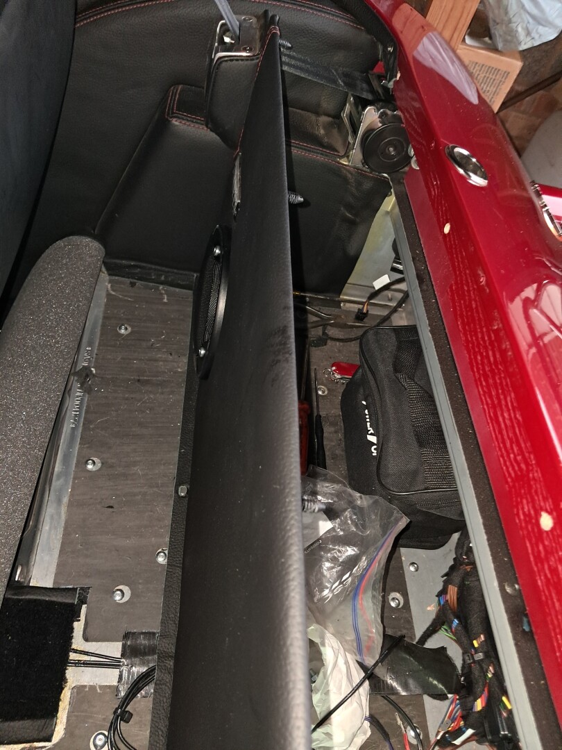

I spent this morning fitting the speakers & testing them.
The upside is they are in position.
The downside is the tools no longer fit behind the panel.
It wasn't difficlut just frustrating as the panel is held in the car by the seat belts so it all takes time compared to working on a bench..
That means my back is a tad stiff. so I'll let it rest before fitting the bluetooth receiver.
Some key learnings. I used bolts I had in stock but they were larger diameter than the original ones so I had to open up the slots on the speakers.
The covers I bought are on an angle due to the holes MMC drilled. I never thought of that when buying them but I still think it looks ok.
You do need speaker extension leads to make it easier to connect them up with the panel open.
