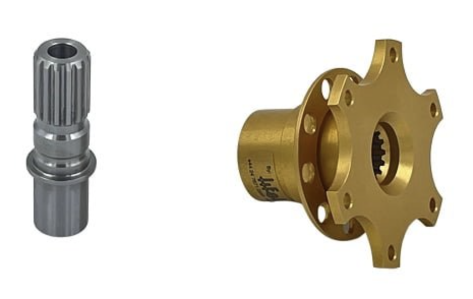

Please could someone kindly confirm the number of splines on a three wheeler steering column?
I'm researching a quick release steering wheel setup for my 2012 Duratec Plus 4, and I'm rather taken with the one handed operation of the three wheeler cental push release version.
If I can find one, and it fits my Plus 4 column, it would be exactly what I'm after drive
Thanks in advance, Dave.

The splines are part of the steering column so you would need to swap the whole column.
The adaptor itself is from Lifeline (Tremec on later cars but this is not deemed as good).
A search on motorsport building websites such as Demon Tweaks, Merlin Motorsport or Car builder solutions might find a retrofit solution.

I've looked at retro fit options, I'd be happy to fit one and may still do so, but the best one I've seen is actually the three wheeler setup.
I like its one handed central push opposition, it's also clearly something the Morgan factory did fit to a few four wheelers as proved here in this recentb Berrybrook video.
It was obviously a factory option at one point, but was it a custom piece designed to mate with the 32 spline four wheeler column, or is the three wheeler column also 32 spines thus making a three wheeler quick release hub a direct fit on my 2012 DuratecPlus4?
In the meantime, if Morgan sourced the three wheeler quick release hub from Lifeline, I'll see if they still offer it?

I would recommend buying the quick release adapter complete with splined shaft. Just google 'Lifeline quick release with splined adapter'. The splined adapter can then be welded onto your existing column, thus ensuring that you'll have a perfect (& safe) fit.
Versions of these are also available with the facility to have a horn-push in the centre of the steering wheel.
At the risk of stating the obvious, make sure you find someone who REALLY knows how to weld!

OK chaps, this is now solved thumbs
Darren from Berrybrook Morgan offered up the quick release hub he sells and it moves the wheel towards the dash by 10mm.
Not only does it allow me to remove the wheel, it actually puts my new dished wheel back where it was with the original flat one, so it's a win, win happy3
I will need to source an alternative horn arrangement, but as the Moto Lita horn push has always been rather poor in operation, this is actually a good thing.
So perhaps more accurate to call the Berrybrook QR hub a win, win, win cloud9

Just to confirm, what Berrybrook sell is the British made QR system from Optimill.
They seem to be well liked by the Land Rover owners who this QR hub is largely targeted at, the following video shows just how short it is, even when the two halves are connected its still shorter than the original Morgan hub I'll be removing to fit the Optimill.
This is how its recovering the 10mm lost by going with a dished wheel.
I'll report back here once I've fitted it thumbs
