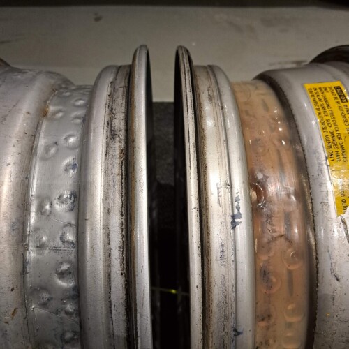

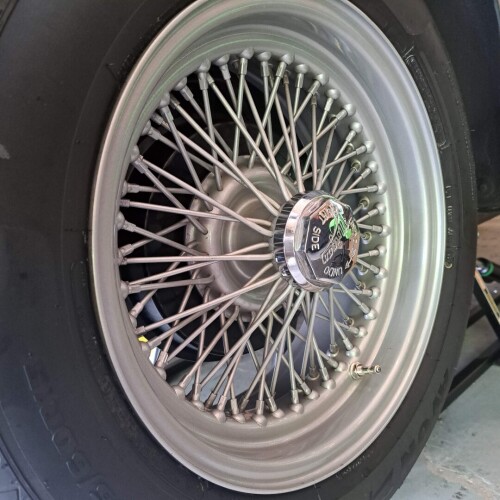

I've powder coated my 1991. Use prismatic powder silver with a prismatic clear coat https://www.prismaticpowders.com. For the sealant, I used several tubes of GE advance silicone (exterior) found in home maintenance stores. The Harley Davidson people use it on their spoke rims. I then used balance beads versus external weights. All works like a charm.
As for the "they flex" issue. modern powder coats will flex within the limits of the rim without issue. I did mine two years ago, 2K miles later, they still look new.
I would suggest that you hand prep each rim with 600/800 sandpaper and a good sandblasting. They need to be as clean as possible. Tape off the hubs to prevent sand from getting in them (and then clean and re-grease when you get them back).
If I remember correctly, the color was British Silver Swatch /Item: PMB-0850S
