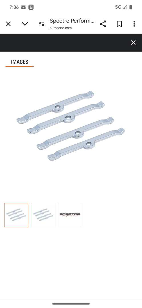

Look for these at your local car parts store. They distribute the force better than the screws alone.

Many thanks for your replies and the suggestions of using Hylomar blue sealant. Paul, I have those types of washer already, although those look longer in length. Arwyn, I take it when you state ' holding down tab washers from the later Pinto engine' you mean the type that Paul has suggested?
