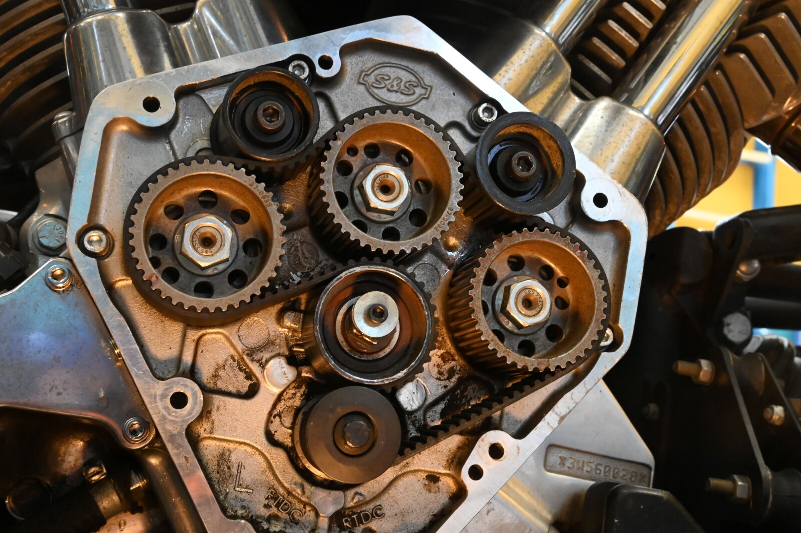

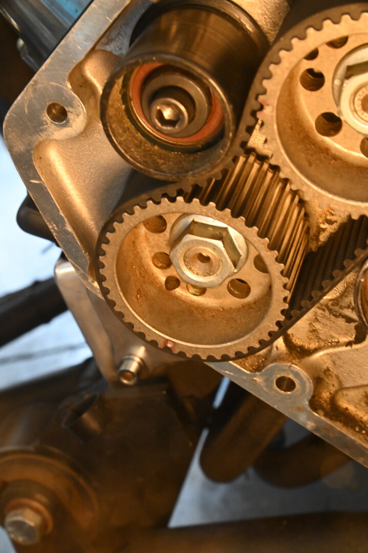

Mistake #2 I see the little red line on the three cams so they must line up with some mark on the engine.... no they do not. So my inner sherlock said they all must point to the center. Well, Watson was wrong as that is 180 degrees off. What the red mark does is indicate (generally) where there is an extra off center hole in the pully. This lines up with a hole in the case and you insert a 3/16 rod and it holds the pully in place. I used a #10 machine screw. While I have a picture of the hole in the pully, I was unable to get one of the hole in the case.
Mistake #3.... well this was not a mistake as the engine must be a FTDC. Of course on our M3W's is not front and back. The left cyinder is the front cylinder. People often mess this up. Left is from the perspective of you sitting in the vehicle facing forward. My picture is actually not a TDC... there is a little notch that line up with a case marking.

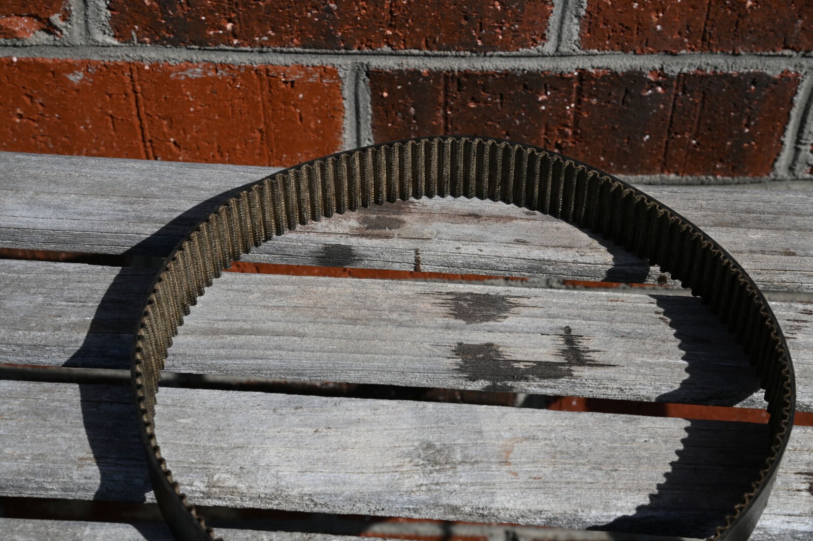

Picture 1 Old timing belt [img]https://www.tm-img.com/image/icCqi[/img]

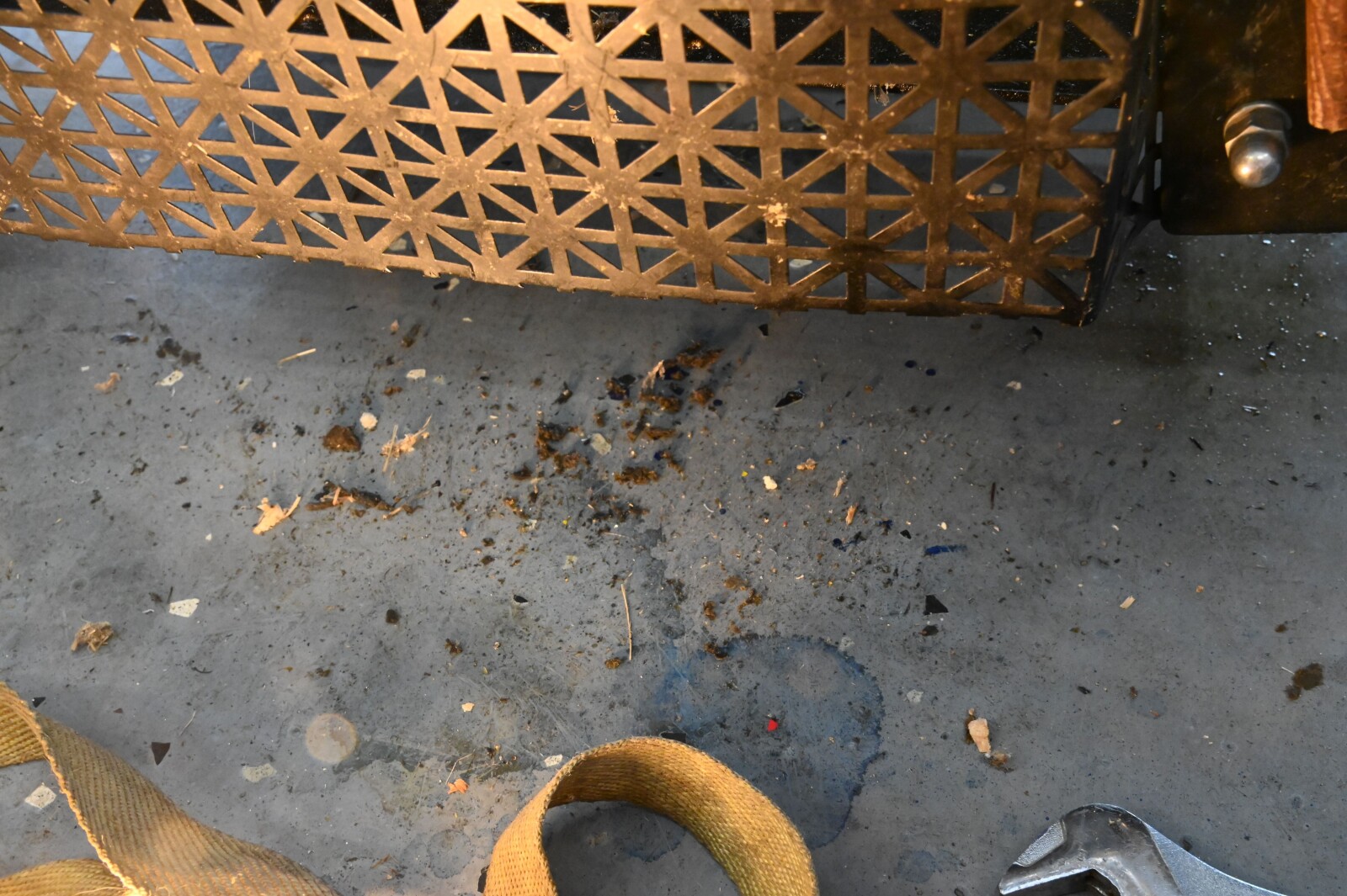

Picture 2 Fuzz from belt wear [img]https://www.tm-img.com/image/ic5AR[/img]
Picture 3 If you look carefully you can see the three red marks on the cam pullys. [img]https://www.tm-img.com/image/icUuN[/img]
Picture 4 The offset extra hole in the cam pully [img]https://www.tm-img.com/image/icwgw[/img]
