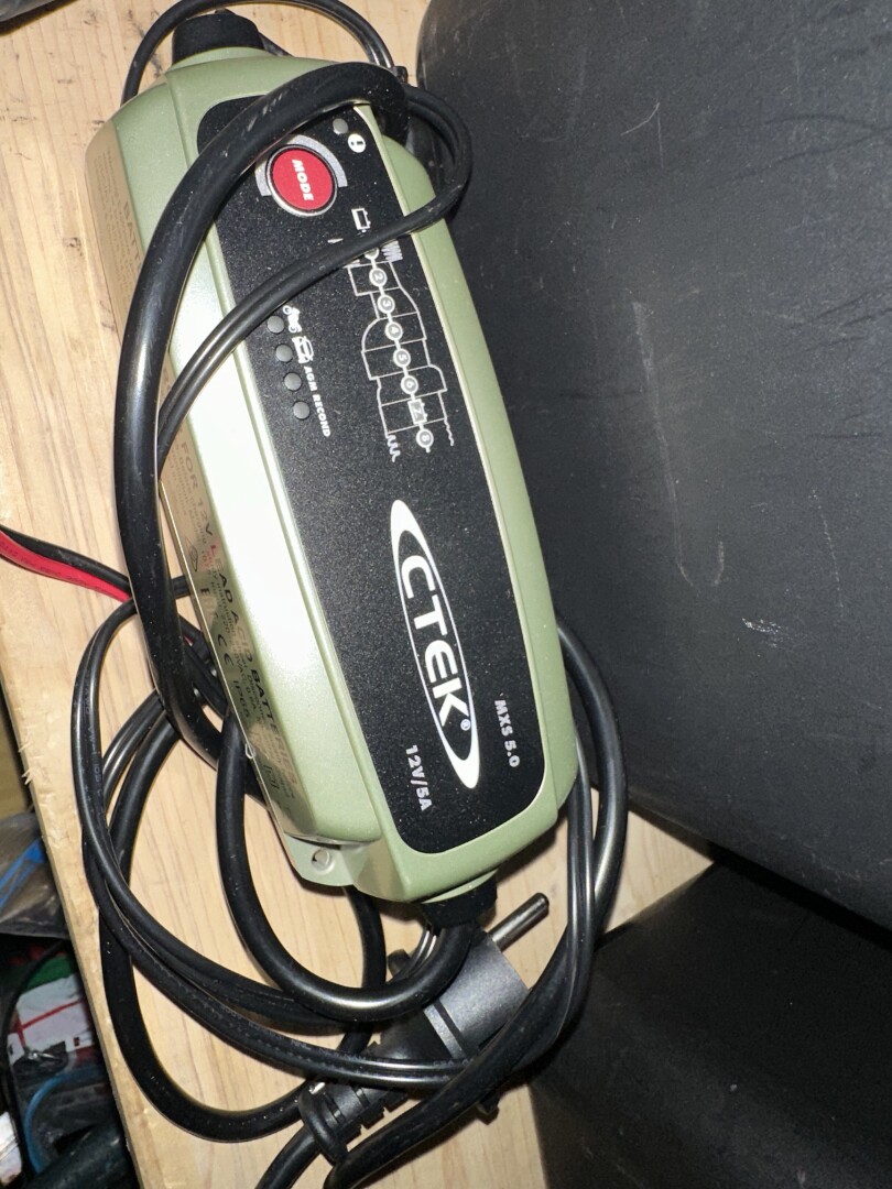

CTEK just like Clemens! MXS 5.0, AGM compatible, so compatible with the modern AGM batteries in CX Morgans. Connected via magnetic adapter, very convenient.

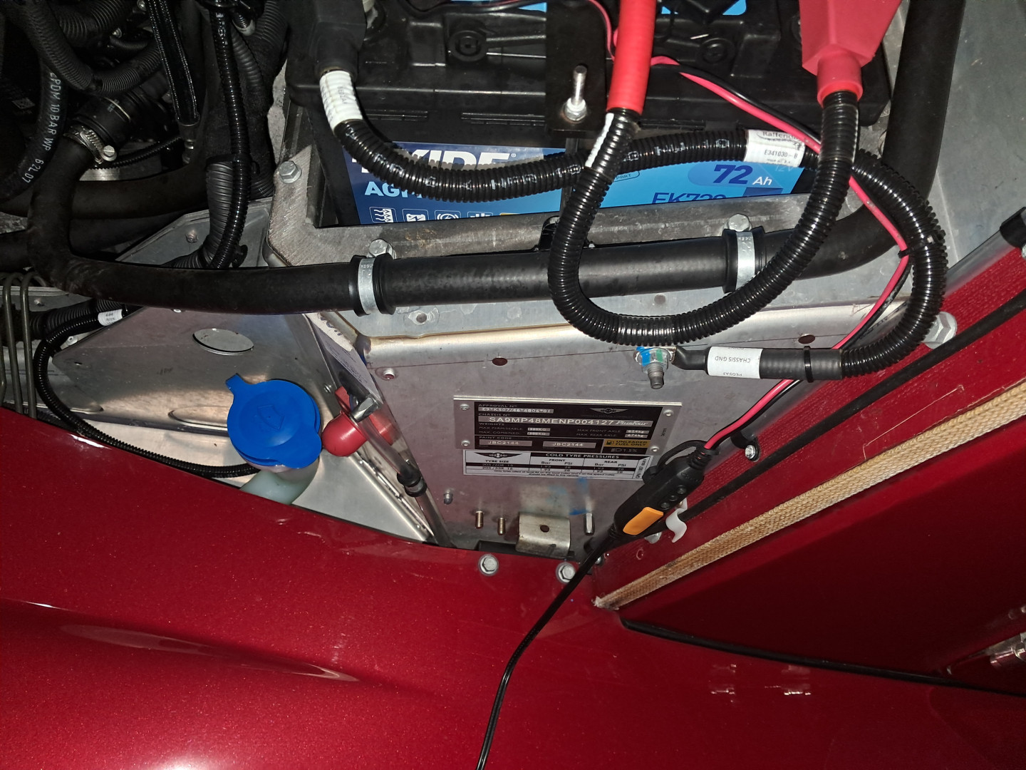

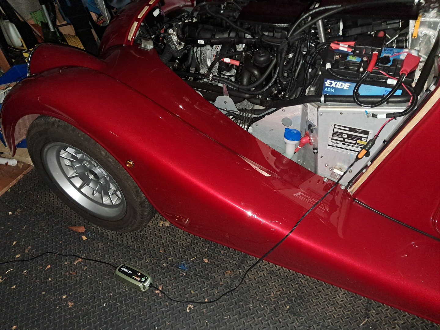

Here is my connection with a fused CTEK comfort plug. The plug has red, amber & green lights to reflect the SOC of the battery.

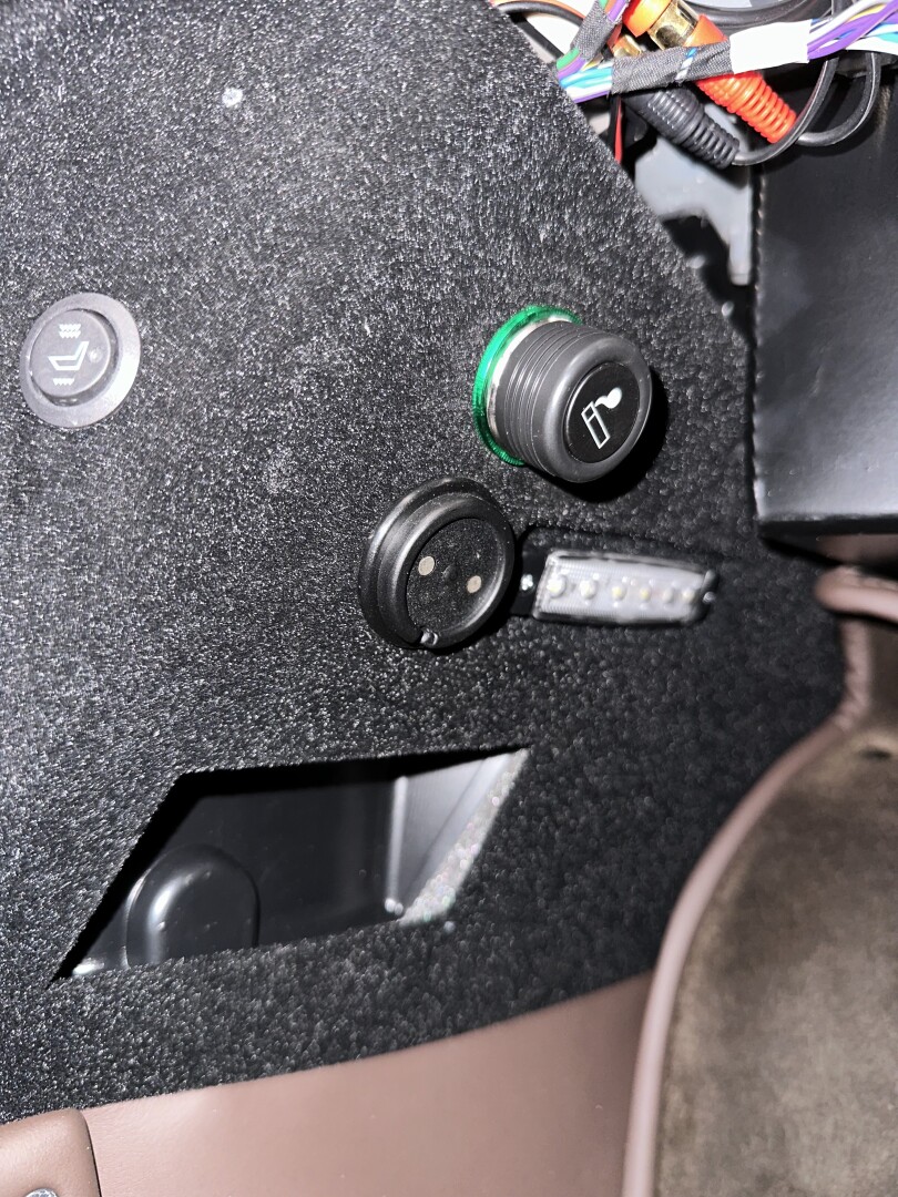

I'm wondering if there is an easy way to route the plug into the cabin, to avoid having to open the bonnet?
