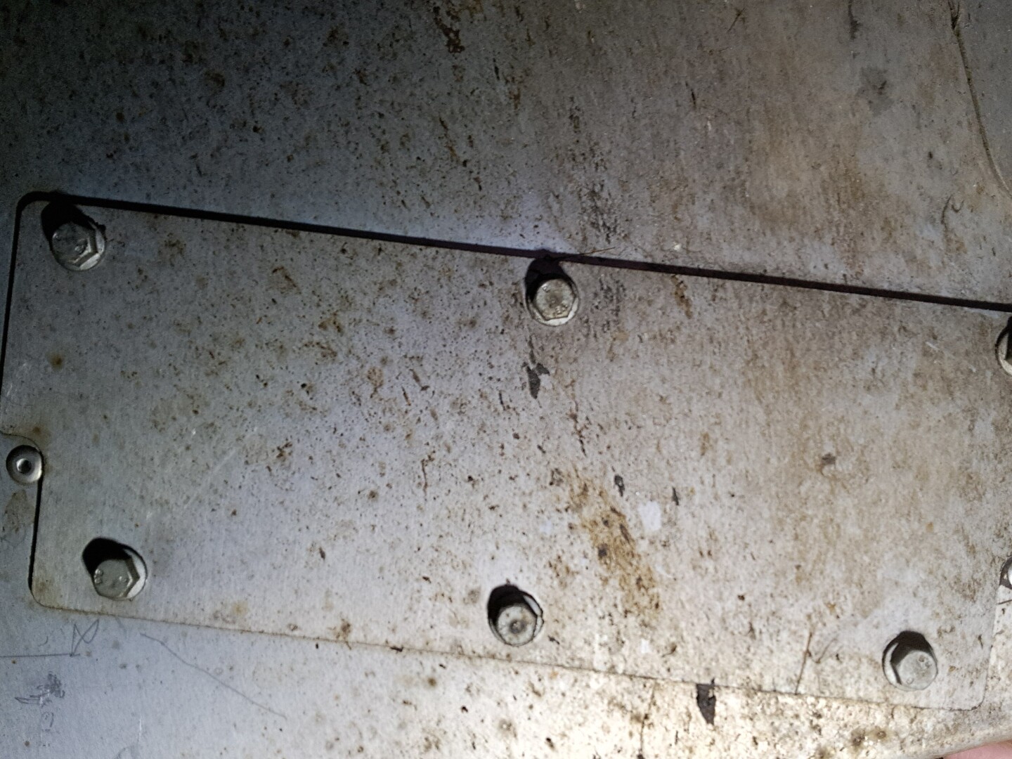

Just a thought.. Is the Plus Four filter and intake located in a smilar position to the Plus Six?.. The Plus Six intake is low down on the right hand side front wing. I have found that if the car is used in wet and mucky conditions ( Somerset lanes ) the lower 3rd of the filter can quickly become clogged. I have changed 3 filter elements in the last 18 months as compressed air could not clear it all out even when dry. I have also water proofed the underwing lower hatch plate that is removed to enable the filter element to slide out..

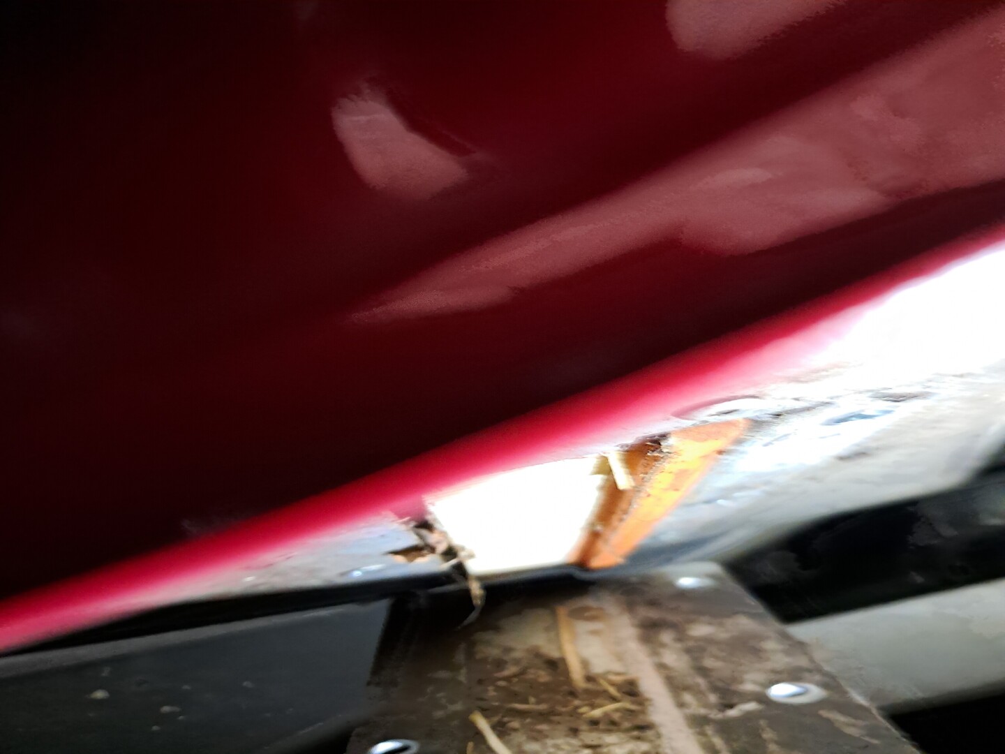

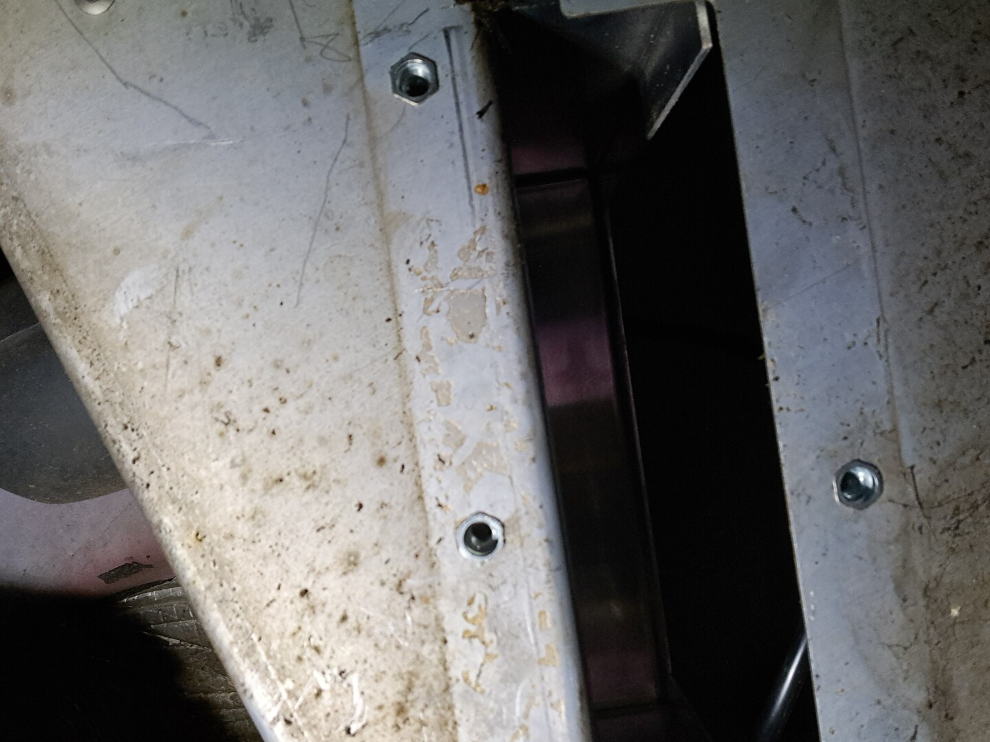

My +4 passed with a K&N filter but it might be a lot of crud on the filter. It is low down on the car & my experience is straw etc builds up. You need to remove the plate on the underside of the wing behind the UK drivers side front wheel to clean it. In the photo of the car at Malvern you can see where the filter sits. Not ideal to my mind. the air come in via those triangular opening in the inner wing sucking in spray etc from the front wheel.
