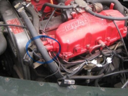

Hot engine not starting?
Had that for quite a while with my Fiat 2.0...
Discovered the cold start kicking in no matter what temperature the engine had.
I will send a photo tomorrow morning, where to disconnect in case. It is definitely a solution for my car.

Found an engine pic...
Try that for a hot start - it must be a typical Fiat thing - learned it at the Fiat workshop.
Disconnect for hot start and the engine will fire...
