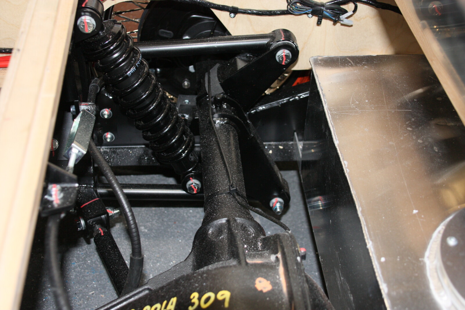

I found both ends of the ATB a real pain to access, especially as I didn't really know what I was looking for. I did a lot of searching online (although frustratingly you'd be amazed how much stuff there is for "Anti-Trump"). I found that the best illustration is in Dave Wellings' excellent book, showing both bars on a Roadster 3.7, early in the build before annoying other bits get in the way ! As suggested previously by Richard, you can really only get to the saddle block in situ with the ATB removed. And it would have been much easier at the front end if I had removed the driver's seat. I should also have spent an extra fiver and an extra hour to go to a charity shop, and buy a tee-shirt and pair of shorts that wouldn't have mattered if I'd got grease and oil on them. Drat ! Anyhow I'm looking forward to getting it back together, not having the springs wind-up, and also not hearing the knocking. smile

L of the W, I'm with Cooperman In that hard starts or launch as they seem to refer to it these days is the only time you would really get the springs winding up! If you drive it like a scolded cat, and why shouldn't you if that's your bent! this won't move the springs too much when in forward motion. However one ATB ie. one on one side of the car will unbalance the car quite a bit if you get any distortion in the Springs whatsoever as this will induce some level of rear steer effect coupled with a height difference between wheel and body either side of the car. I have always thought that the fitting of just one ATB was a ridiculous solution to spring damping by MMC. You may be correct in that the battery cage prohibited MMC fitting the other sides ATB as no doubt all the Cassis' out back had the mountings in place for the battery. You could have a word with Cain at Wolf Performance, he sells ATB's and I'm sure he will offer good advice but for me, well I think I'd take the ATB off if I could only have one and have a balanced car, I'd like to also see if just having the one would allow the potential spring wind up to find the weak spot and in fact cause the unsupported side to cause a greater level of wind up to that spring.

Now that's a different and helpful perspective. I've never done any "wheel-spin" starts with the Roadster, although after the clonking had started (due to the detached ATB waggling up and down and hitting the floorboards) I did pull away sharpish from a junction and had felt a strange wallowy sensation. That would've been tramping I guess. I did have a look, and I'd say there's room beside the battery to install another ATB on the nearside.
Interestingly, you say "However one ATB, i.e. one on one side of the car, will unbalance the car quite a bit if you get any distortion in the springs whatsoever, as this will induce some level of rear steer effect coupled with a height difference between wheel and body either side of the car. I have always thought that the fitting of just one ATB was a ridiculous solution to spring damping by MMC".
In the car's history file, in Nov 2012 at 9K miles / 4 years old, a respected specialist dealer commented (after a service): "it was discovered that the rear offside is 1/2 inch lower than the nearside". I have always attributed a slight difference to spring sag, but I wonder if that's what this was all about.....
