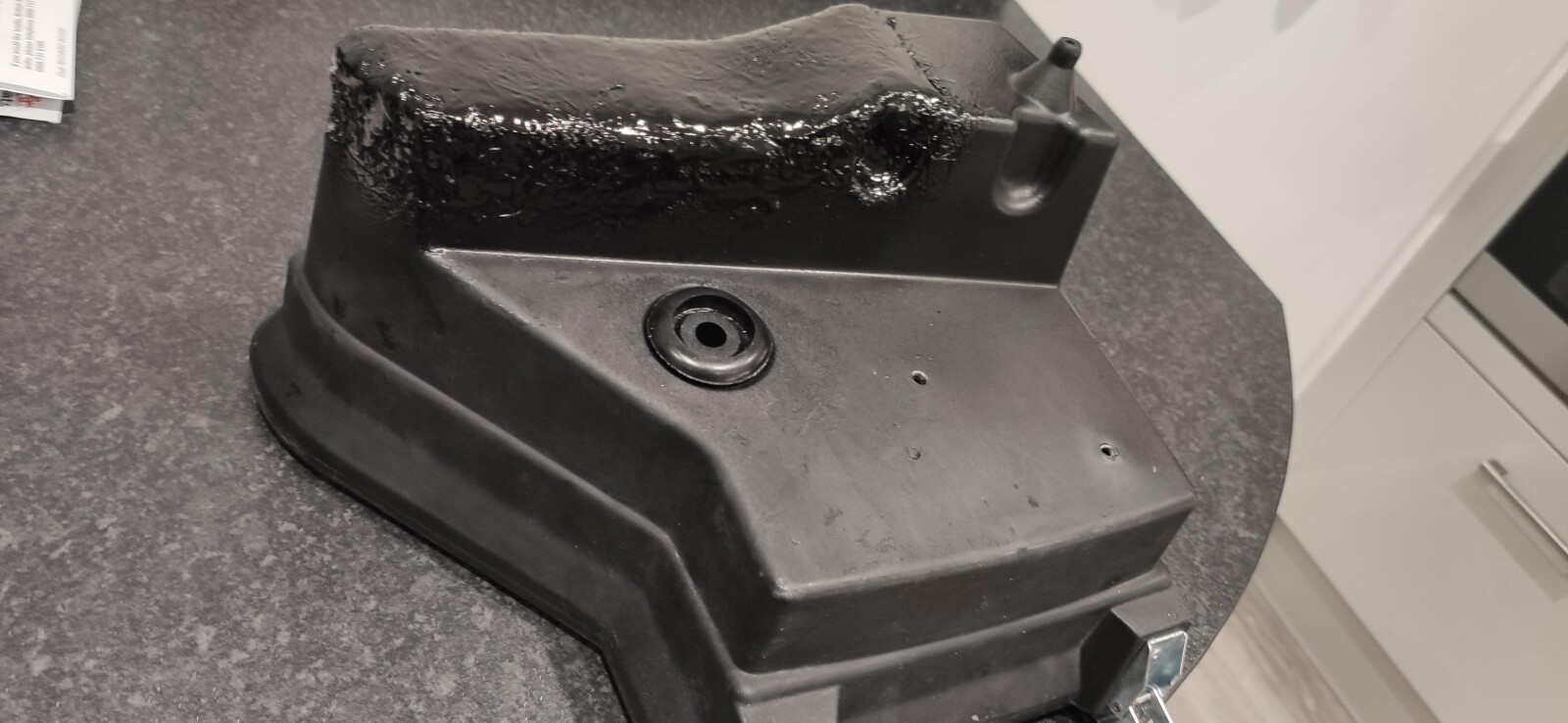

The last time I used fibreglass was to seal the bottom of the ABS plastic air inlet moulding after removing the part that sucked air from back of engine/bellhousing doh Obviously the area was cleaned first but the resin stuck extremely well after roughing the plastic up a bit. Finished item below.
