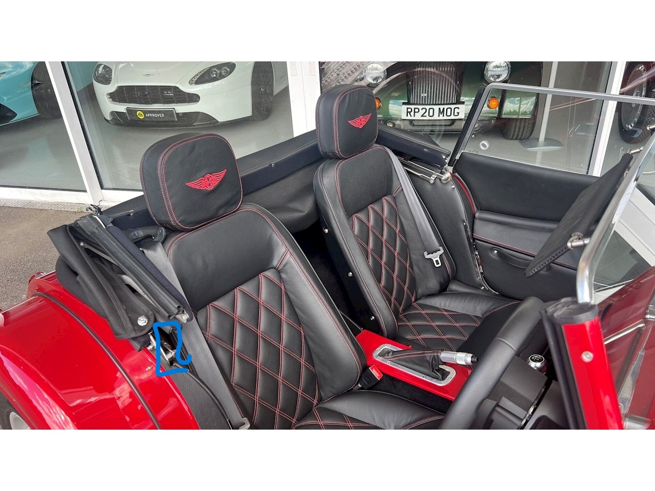

I gues you need two people to move it and only need to remove the bolt holding it to the plates on at the front on each side. See picture. I would use a tie to hold the folded hood together.
You would need somewhere to store it.
Mine though has the hi level break lights in the hood frame but that has a connector.

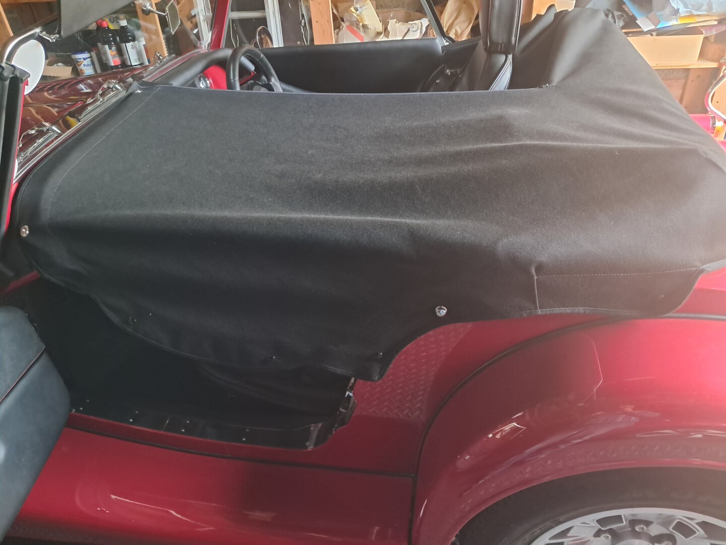

I have a tonneau from Allon White without head rest pockets. It works well.

Many thanks for the pictures. How does your tonneau fit (stud positioning) with the side screens in place?

Like any other on a trad. 3 lift dots at the front. One press stud & tenax at the rear as the others are hidden by the side screens
Posts: 27,809
Posts: 27,809
Here is a photo

Thank you for the picture, very useful.
