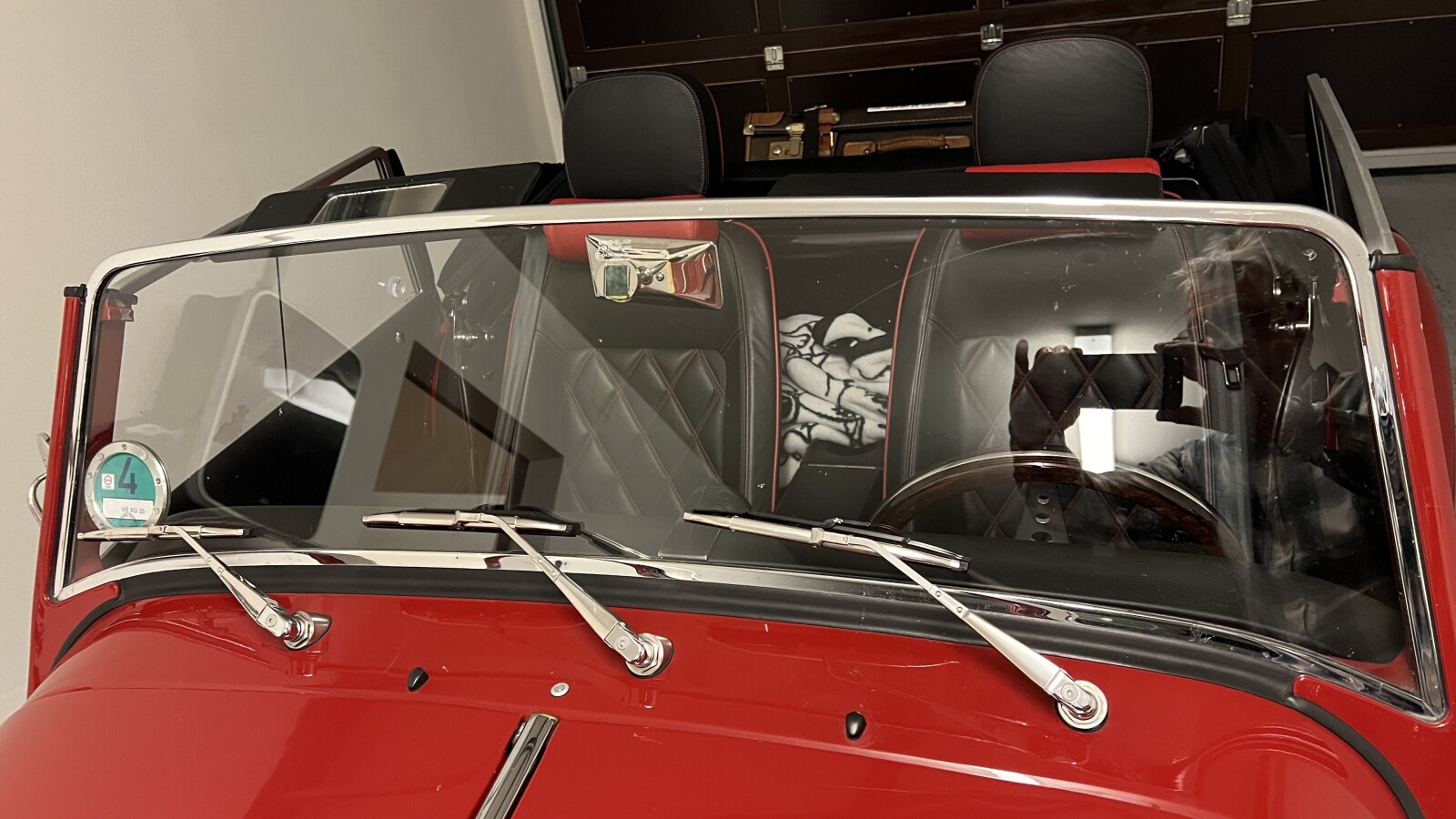

From left to right:
195 195 210
No issues

Are the washer jets deliberately unequal from the bonnet centre line ?
CooperMan #832342 18/10/25 05:14 PM
Joined: Sep 2022
Posts: 1,163
Joined: Sep 2022
Posts: 1,163
Yes, they are.
