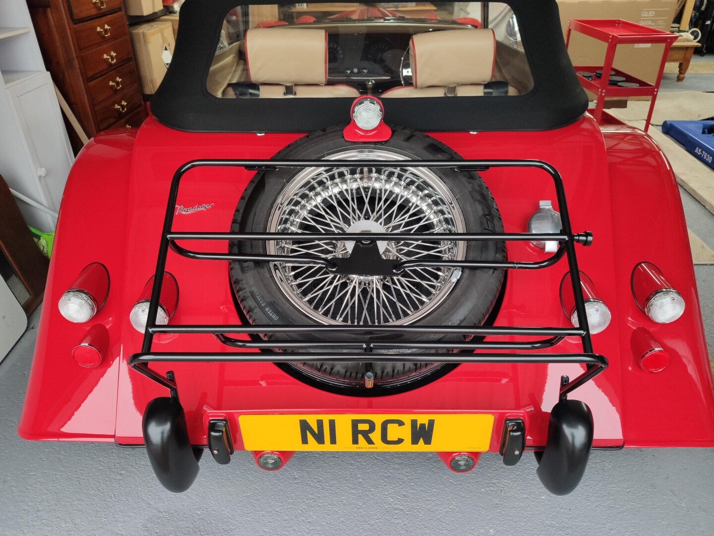

Ben, if you have overriders the factory luggage rack just lifts vertically off support pins on brackets secured by each rear overrider upper fixing. This after removing the T bar securing spare wheel. See mine below which supports sidescreen stowage below luggage.
It takes seconds. Regarding Cobra, once rack and spare wheel are out you should be able to see the four wood screws securing same. A light and mirror may help. The screws are fitted through slots in the cobra moulding allowing it to be slid in or out to fit snug against spare wheel when all back in place. Some expermentation may be needed to find this position so don't fully tighten screws until your happy with cobra position.
