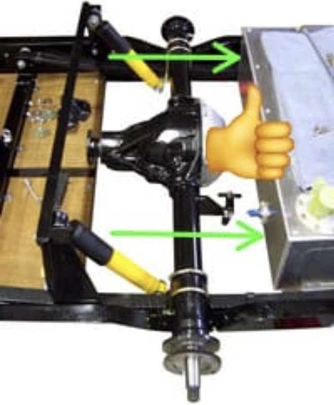

One more try using a different image hosting provider, they're coming out smaller than I'd like but they're definitely visible to me when I preview this post.
Hope you can see then now, although what they show should not be unfamiliar to us all.

This is the correct way to fit telescopic dampers to a Morgan:
Spax are ok but I wouldnt use AVOs, despite this detail Rutherford definitely knew what they were doing, unlike the MMC!

However, to me it's really only logic and I'm confident others can see the same logic too. Forget all the other failures I've shared for a minute, anyone still in doubt that Morgan fitted the rear dampers 90 degrees out need only look at the deaful bush wear I've shown.
The following images don't lie, but serve as an inarguable witness to the dreadful and unnatural twisting forces at play.
Personally I really like the Rutherford kit, unlike the MMC's effort it seems clear the designer of this kit understood the movement of the axle and what was needed from a telescopic damper conversion, here's another look at the Rutherford conversion.
Perhaps the owners of modern trad chassis Morgans overlook the above as we already have telecopic dampers, however, it's such an improvement over what Morgan gave us I think we should also view the Rutherford kit as a telescopic damper upgrade rather than just a way to convert earlier cars from lever arm dampers.
At the end of the day whatever small changes we make such as simply turning the dampers by 90 degrees, we're still stuck with the beam axle and leaf springs, so we really can't expect miracles. However, letting the axle swing unimpeded and in doing so allowing the dampers to pivot freely, is surely the no-brainer starting point to improving Morgan's fundimentally flawed telescopic damper conversion?
