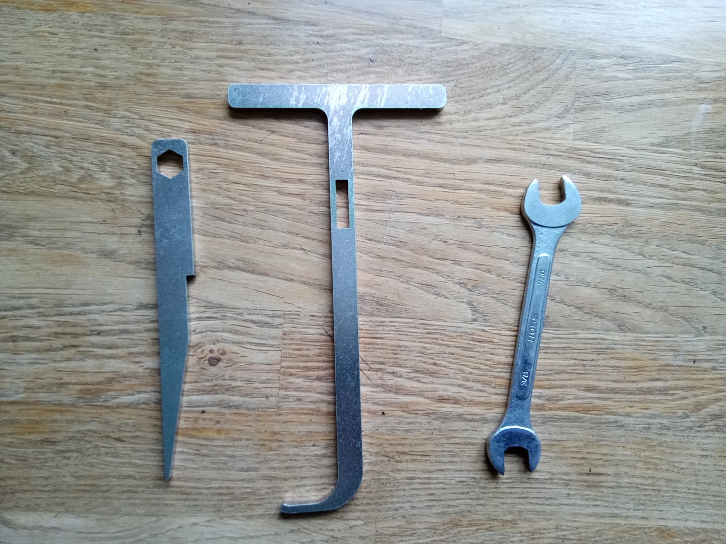

These tools came in the handbook pouch of my Plus Six. Are they factory, what are they for? The spanner is imperial, 3/8 and 7/16.

Page 45 in the manual shows the 2 things on the left are used to select neutral when the car will not start. There should be a hole in the undertray to access the gearbox lever.

I have the same two left hand tools, and also no idea what they do or how to use them. The handbook for my P6 is the same as Mart's, there's nothing mentioned. I leave them at home, and had forgotten about them until this thread popped up. I don't have the spanner, but I know what to do with it pantsdown

They are to disengage the auto box for towing. The spanner I guess is to disconnect the battery if needed to "reboot" the car.
I have a manual but if I had an auto I'd keep them with me
