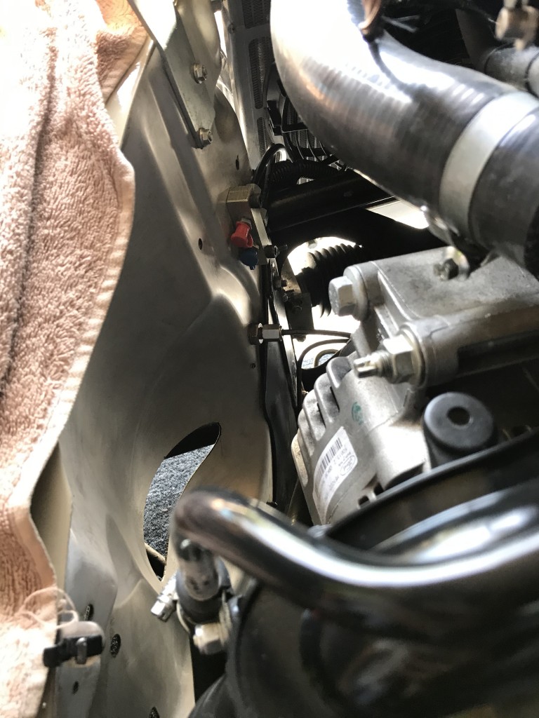

When I had my 4/4, I fitted the remote grease nipple blocks in the engine bay, (easier to connect & pump) I stopped pumping when I heard the first pop sound. As others say you still need to get underneath to clean off the excess grease, but I never needed to jack up the front end, whereas before I had to jack the car up to get the grease gun fixed on. I fitted the swivel type underneath purchased from Cain at Wolf Performance.

Hello Craig,
Did the manifolds come with kits ?
Your Morgan engine bay looks spotless, keep up the good work.
