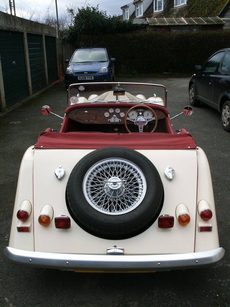

Well, here's another, my 1982 4/4 Twin Cam had a pair fitted, it was also one of the first Morgans to have the frame treated with preservative

Originally Posted by bilibib
Lovely dashboard layout and the cream gauges really suit the car thumbs

Quote
Thank you, Jon,it certainly looks better than the original dashboard
