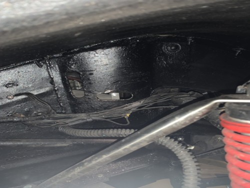

Sideways recommendation
Access on mine was dreadful so I cut a matching vertical hole in the inner wing. Made the job significantly easier, have Pic if you want it
