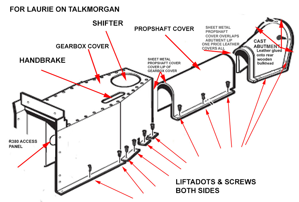

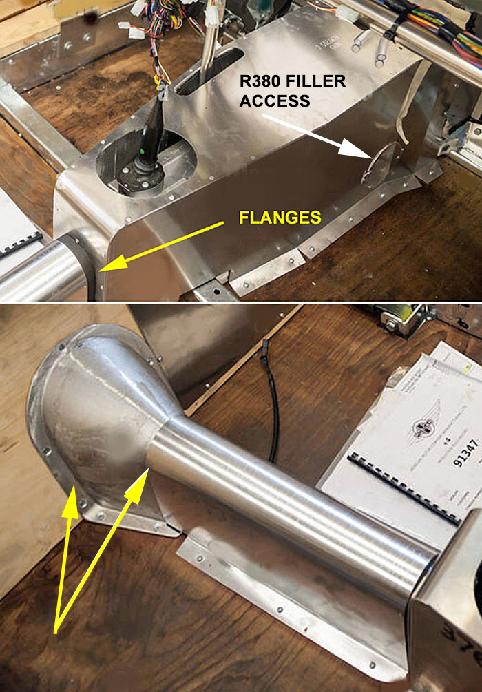

I think the staff made a little mistake with your car.. It happens. I will not dwell on this.
I have prepared some diagrams for you to better explain. (below) I have never heard of a Morgan R380 filler car without the circular little "access door" in the gearbox cover. Those newer covers, illustrated below, reduced a lot of precious footwell space for owners. frown2 But they are much less effort to make than the earlier ones. Beware they also have thick heat insulation on the inside. I am not sure how you can slip your hand, with a plug opening tool, then a filler tube and then fill the box upwards easily. Then you must replace the hotly debated plug. I have never run across that. Even when I installed R380s in my 1984 and my 1990 with their older steel gearbox covers, I simply made little access panels for the R380 fillers. My 2002 came with the panel. See below.
The problem will come if you cannot find have sufficient access. Without an access panel or any compromises, the seats, the propshaft tunnel, the propshaft tunnel abutment at the rear, and that big bulky gearbox cover must be removed (which on your later car may require the removal the heating system along with the top of the safety brake). The later cars do not have much room above the gearbox over and the plug is towards the rear. Though I have done these tasks for other reasons, I have honestly never attempted this sequence for a gearbox refill.. Removing the engine is easier. laugh2 And I am far more familiar with that!

Here are your made-order-diagrams. Lorne
