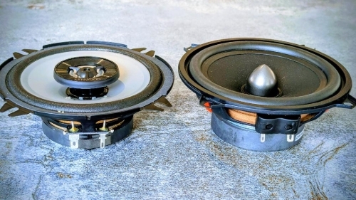

For my needs the basic configuration is fine, And I decided the simplest and optimum value way to proceed was to upgrade the speakers - and see if that produces worthwhile improvements.The first constraint to consider was clearance for the door speakers, given I could see from the spec drawings that the Kenwoods are very shallow implying not much clearance in the door mounts. So the choice for the fronts was limited to similarly shallow options. This led me online via Car Audio Centre to select Focal ISU 30 - a 2 way component Speaker System at £150 - reduced from £200. This comprises a relatively shallow 5 inch woofer with a separate tweeter with a crossover filter for the tweeter integrated into the feed wire.
I also bought for the rear Focal Access 130AS- a 2 way component speaker system at £100 reduced from £225.
At this stage I have just fitted the fronts - and will report back later once i've fitted the rears. However, I can report that the front fitment has already transformed the sound.
The photo shows the OE Kenwood beside the replacement Focal - the Focal is around 5mm deeper but does fit without fouling the door skin.

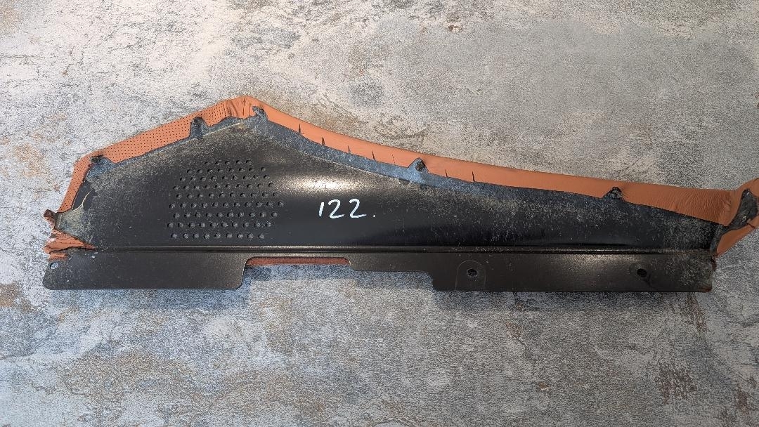

Now you can start on the upper card. This is retained by two self tapping screws near the door catch, and then by 4 or 5 of the plastic plugs which are friction fit into the wooden door frame. I promise you, they do come out - eventually yielding to far more force than you imagine is desirable - basically I pulled and tugged and applied leverage with a variety of improvised tools until they suddenly release their limpet like grip.
The photo shows the inner of the upper door card with the plastic retaining plugs visible along the top edge.

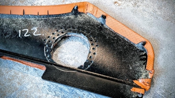

With the 2 part door card free it soon becomes apparent how poor the factory speaker installation is. No wonder there is so little sound from the front speakers. The speakers mount to a metal bracket attached to the wooden door frame, and only partially behind the perforated section of the leather trim covering the upper door card. The sound from the speaker must pass through the sandwich formed by the door card itself - rigid composite material around 5mm thick and punched with quite widely spaced holes probably reducing the card mass by only about 50% where it sits next to the speaker. What sound escapes these holes then has to travel through another 5mm of foam padding, and finally through the perforated leather with much more leather than its needle fine holes. No wonder you can't hear them! That is the basic problem, but equally there has been no attempt to improve the acoustic properties of the door cavity. No sound deadening. No wadding. No speaker isolation. Having gone to all this effort, it seemed sensible to make a few acoustic improvements - so I bought some Canopus sound deadening material and cut it to shape and stuck it to the door skin, and generally filed the voids with some speaker wadding I had from a previous installation. I also purchased a "Roadkill" speaker insulation kit for later fit.

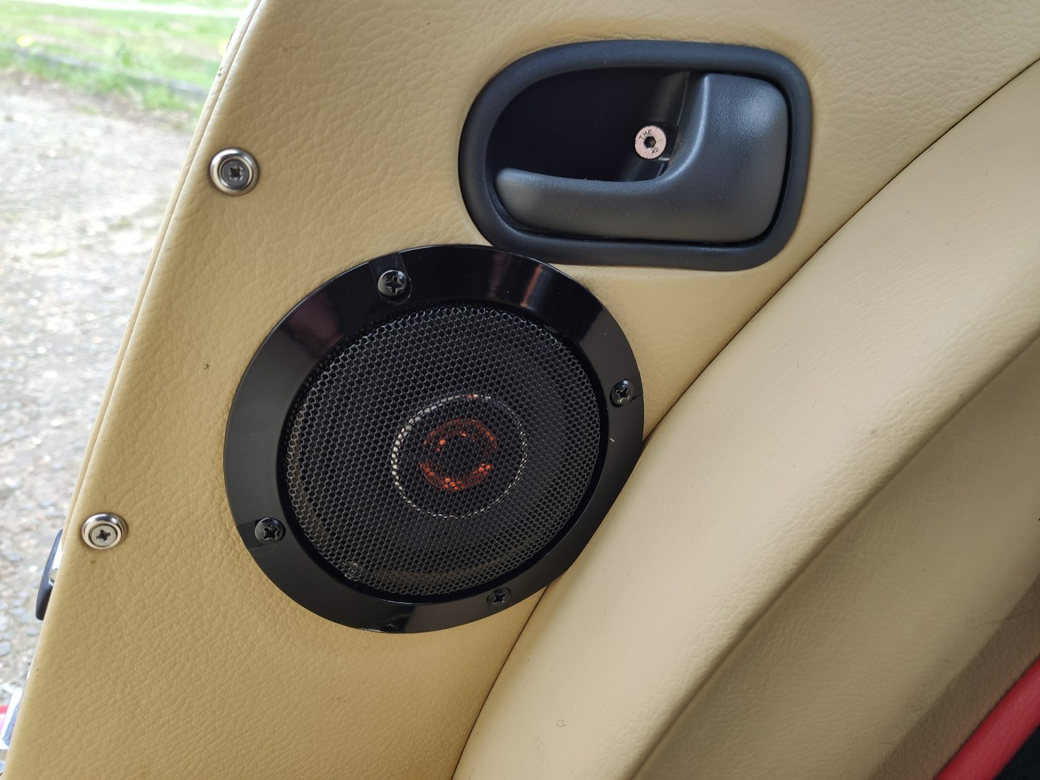

The photo shows the upper door card with the hole I cut adjacent to where the speaker sits in order to improve sound transmission into the cabin.

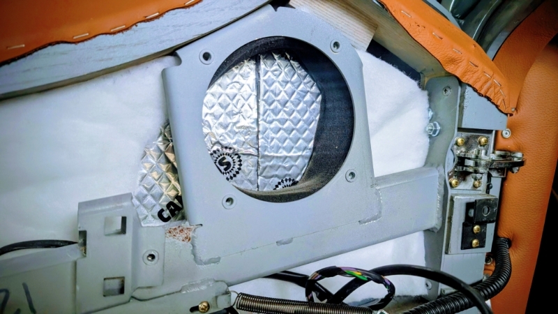

So attached to this post is a photo showing the door minus the upper and lower door cards, and with Canopus sound deadening lining the door skin. White acoustic wadding fills as many voids as is practicable.
The new 5 inch Focal woofer simply screws into the existing OE speaker retaining frame. I used some piggy back spade connectors to allow the existing speaker wiring toi attach to the Woofer terminals along with the additional wires to feed the separate Tweeter.

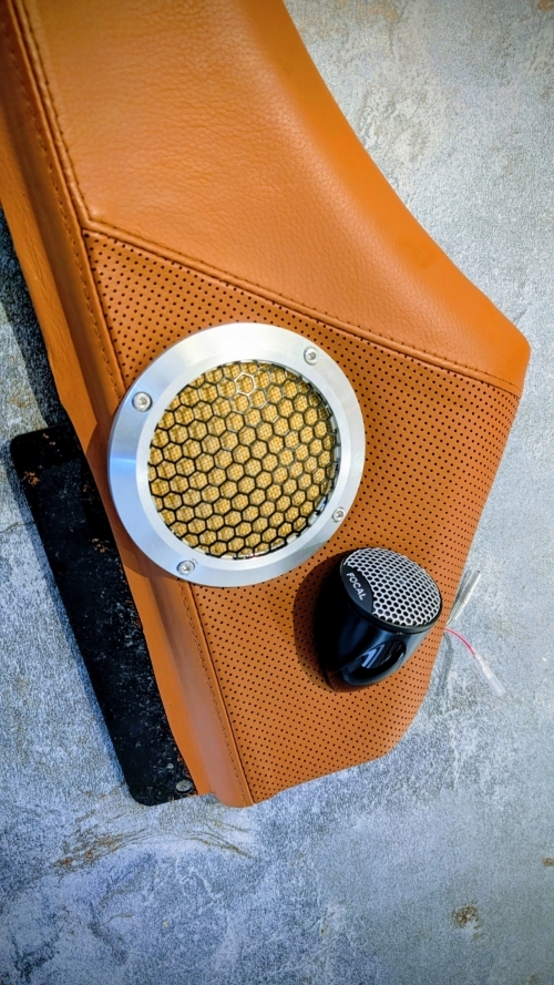

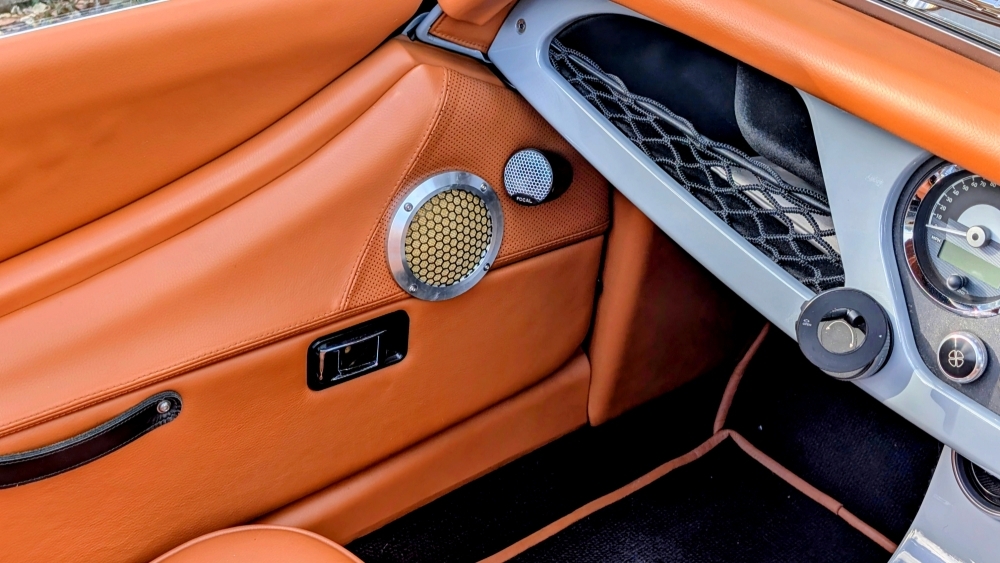

The installation is completed by fitting a pair of alloy speaker grilles (obtained for about £15 via amazon, and some speaker cloth. This tidies up the external appearance of the aperture cut in the door card. The Tweeter attaches to the outer face of the door card with screws and the wiring passes through a hole cut in the card.

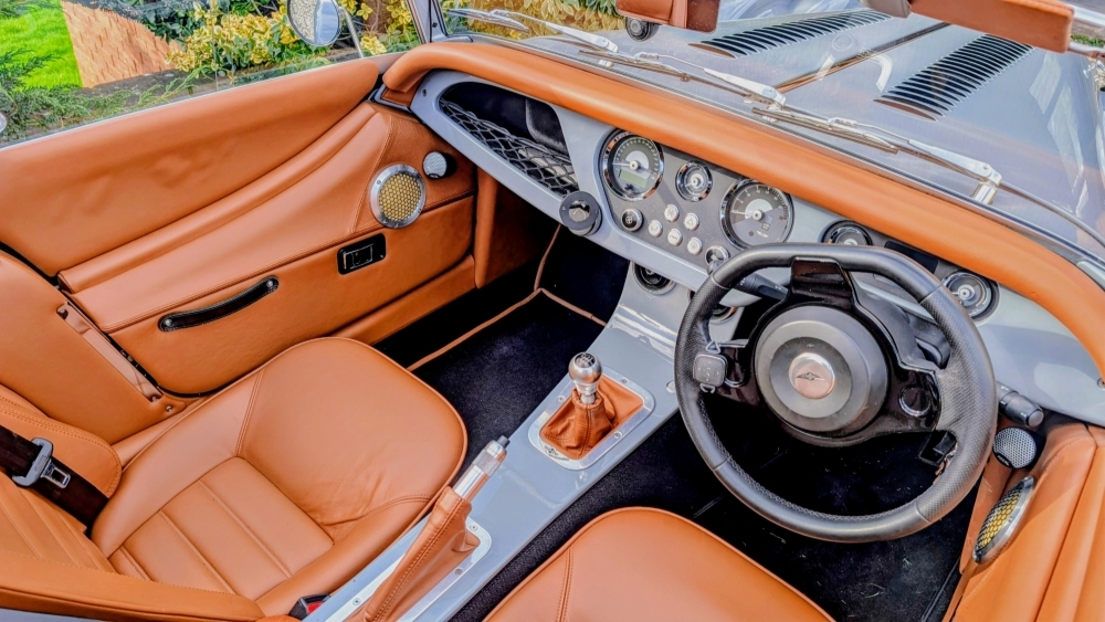

The finished installation looks quite neat to my eye, and the sound transformation is excellent. I will make a further post showing a wider angle view of the cabin , and will later report back with progress on the next phase to replace the rear speakers.

iI should probably have added in my original comments that whist the actual speakers are 5 inch units the external aluminium speaker grilles are 4i nch units - meaning that the hole I cut in the upper door trim is slightly smaller in circumference than the actual speaker that sits behind it (although the hole is plenty large enough not to hinder the sound emitted). This is because the actual location of the speaker does not align particularly well with the perforated section of the door card, and the hole you must cut if you centre it on the centre of the speaker takes the hole down to the waistline edge of the trim. This becomes more pronounced and intrusive if you opt for 5 inch grilles which will not fit as neatly and will look visually misplaced despite being perfectly aligned with the actual speaker.
