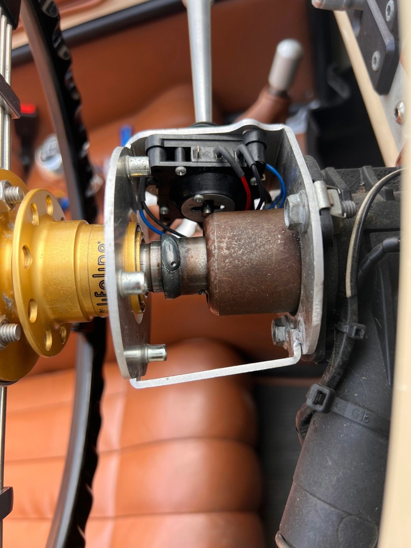

This morning I degreased the quick release setup and regreased. The steering wheel still wouldn't go in. I took the steering wheel off completely and gently tapped the quick release fitting in. It did eventually go in but I am unsure if it went in properly as I heard no click maybe because of the tapping. Anyway here is a picture of how it looks now. It feels tight but let's face it this is what could have been done before ie tapped in but not properly into position which is why it came away. Is this in far enough?

It looks to me as if your steering wheel mounting bolts are too long, preventing the release collar from being pulled full back. That release collar (the part with all the holes in it) needs to move about 8-10mm to operate properly.
