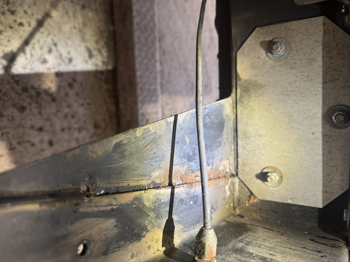

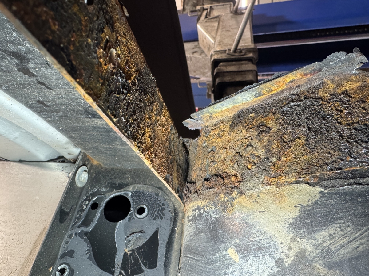

Hi,it came to my attention last year while servicing various customer cars that and only on the non galvanised chassis cars(2015 to the end of production)that corrosion was creeping out of the strengthening panel under the washer bottle,after investigation and one customer allowing me to cut the panel off I found a lot of corrosion and can only assume the panel/chassis wasn’t painted with a weld though primer before being welded on,I have repaired three cars now and all low mileage,only real option is to cut the old panels off and repair properly,

To those who are unable or unwilling to take studious care of the chassis this is a real concern. I regularly inspect particularly after each winter for the slightest sign of rust streaks which shows up well against the black underseal. Such areas on chassis as mentioned above and usually where extra welded strengthening has been performed on chassis get treated with ACF50, indeed any gap does. For cavities and box sections with access I also use aerosol wax oil available clear or mixed with black paint, tenacious stuff given how difficult it is to get off your hands. Note the 3.7 Roadsters, and maybe the 5 link ones more so, with need for greater strengthening likely require greater vigilance. Mark's pictures below.
The introduction of electrophoretic coating after chassis was completed was just a cost saving over galvanising IMO. Sadly the ensuing corrosion is unlikely to be limited to one or two cars.

Just to add all of the cars are low mileage,the mileage doesn’t really have much to do with it as if the metal wasn’t treated before being welded on,it will rust regardless between the panels,I have another car in the workshop today with the same issue,if anyone wants to see a more detailed pictures have a look on my facebook page

I hear what Richard is saying about the regular maintenance aspect of Trad ownership, and yes, some general housekeeping is certainly necessary.......
'Most' modern Morgan owners aren't going to be inspecting every inch of their cars, especially if they hardly drive them......
However.... the rust in picture 2 is outrageous for a low mileage 'cosseted' Morgan. It wouldn't look out of place on a farmers abused Land Rover........πŸ€·πŸ»β€β™‚οΈ
