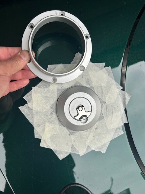

Fitting it to the Plus Four isn't possible at the moment banghead
The Newton cap fits well in the ring I bought from Morgan hippy
However, the aluminum ring from Morgan doesn't fit the original fuel cap swear
The original cap is 94mm wide, and the ring's inner diameter is 90mm mad2
I'm hesitant to modify the Morgan ring because there isn't much material left over scared

After trying the modified ring again, it turns out that a 3.5mm chamfer isn't enough mad2
I'm going to make a 5mm chamfer stirpot ...

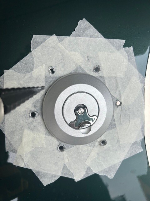

The next step in the project is drilling the bodywork for the installation of the ring scared :

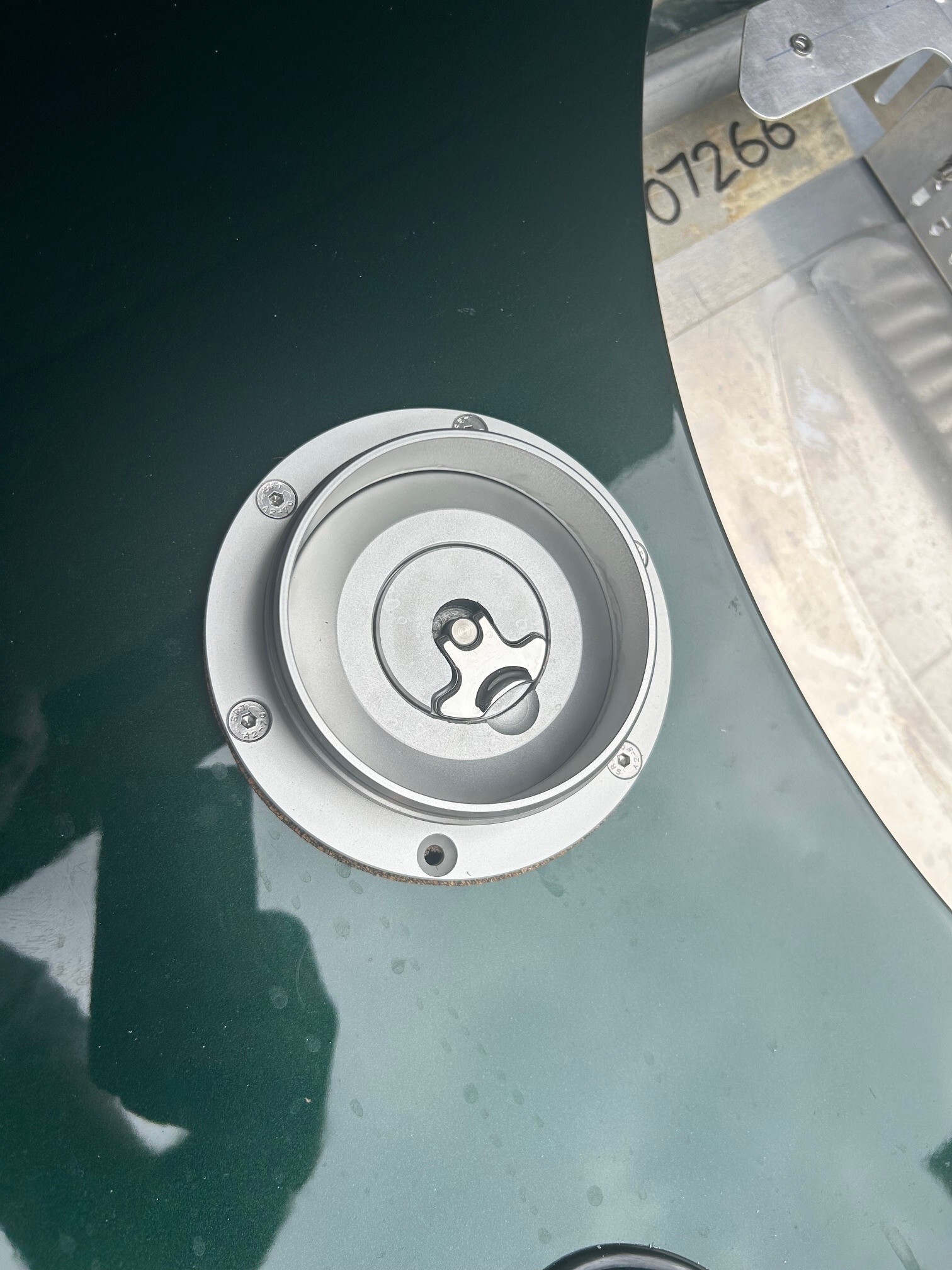

I installed the ring last night.
But the 6th screw at the bottom left is very difficult to access banghead :

That looks really nice.
Perhaps some dielectric barrier paste on those stainless screws where they break through the rear panel might be prudent?

Good job, Nestor 👍
Glad everything worked out in the end 😎

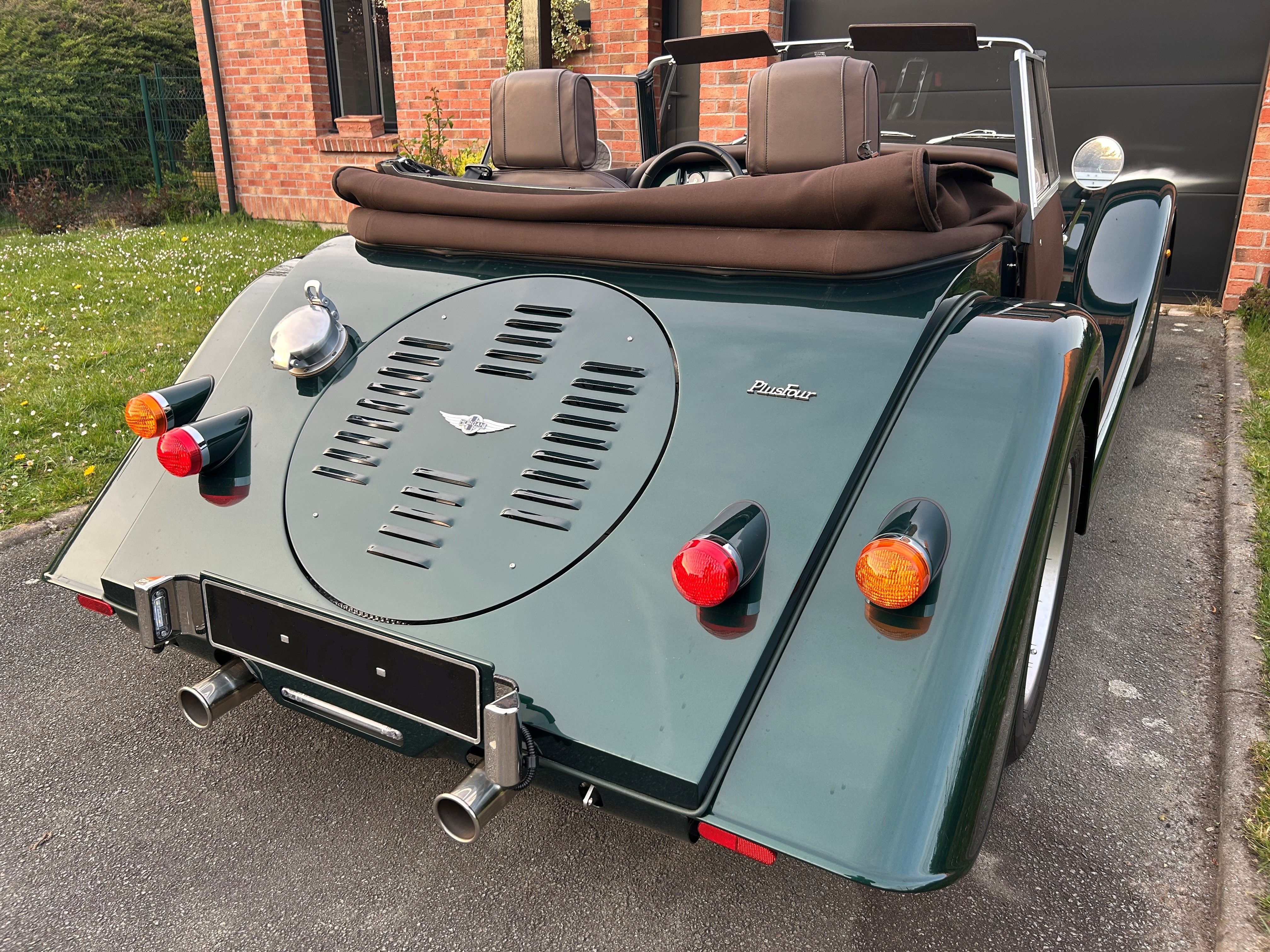

coffee :
