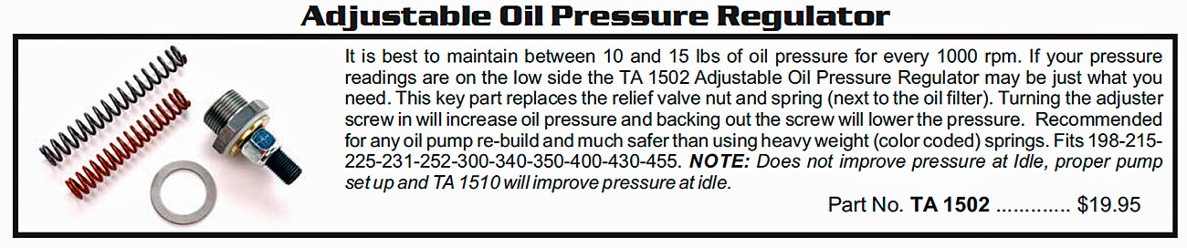

P.S. I would buy a new pressure relief valve spring along with the pump gasket just in case. I use a copper crush washer on the plug.
P/P/S I am very familiar with all this. I rely primarily on British V8 community lore. US lore of old can be ingenious but it is VERY old. With the UK tadpoles rather than the thimbles, I use a cute thingie from an performance Buick 215 supplier. It allows me to adjust my oil pressure with an Allen key on the road. ; )
