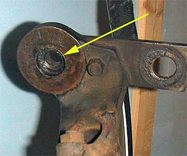

Something important to note. Considering the front forces present in a sports car, no degree of torque could stop the kingpins from moving without the following design feature.
The top of the kingpin fits into a recessed indent (more accurately a "detente" in French) which is cut into the upper support plate welded to the cross frame. When securely fit into this slot, the kingpin cannot move with sufficient force. One merely torques to the amount to the amount that reflects the quality of a well-chosen top bolt. https://www.gomog.com/allmorgan/bolttorque.pdf Sadly the MMC did not give out such the grade information for bolt or kingpin, in the day. I use either 8 or 5 bolts and hard-chromed C1045 or C4140 bar stock (the "C" stands for carbon steel) . These cost no more than anything the MMC has ever used.
Below is bad (very old) images of the slot from a snackered crossframe, and an example of what can happen with ungraded sadness.
