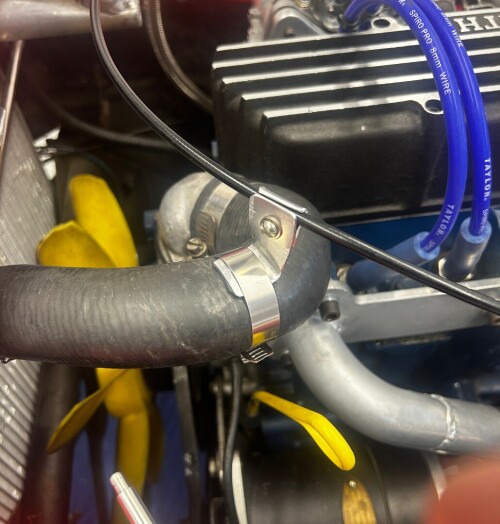

Jon, Thank you for the update and excellent photos. thumbs
Looks to be an inexpensive and effective arrangement.
I like not having to drill extra holes for attaching...

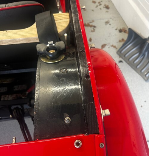

I repaired, prepped and painted the the elbow top rail getting it ready to install new welting, and made a little bracket to keep the accelerator cable off the header.

I got the welting installed. A couple of the first few brass nails bent, so I marked and predrilled the holes with a bit slightly smaller than the nail and it worked great...

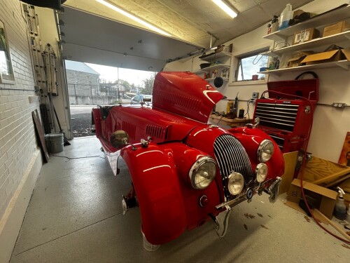

Got the carburetors dialed in and the bonnet back on. Wheels on and back on the ground tomorrow...
