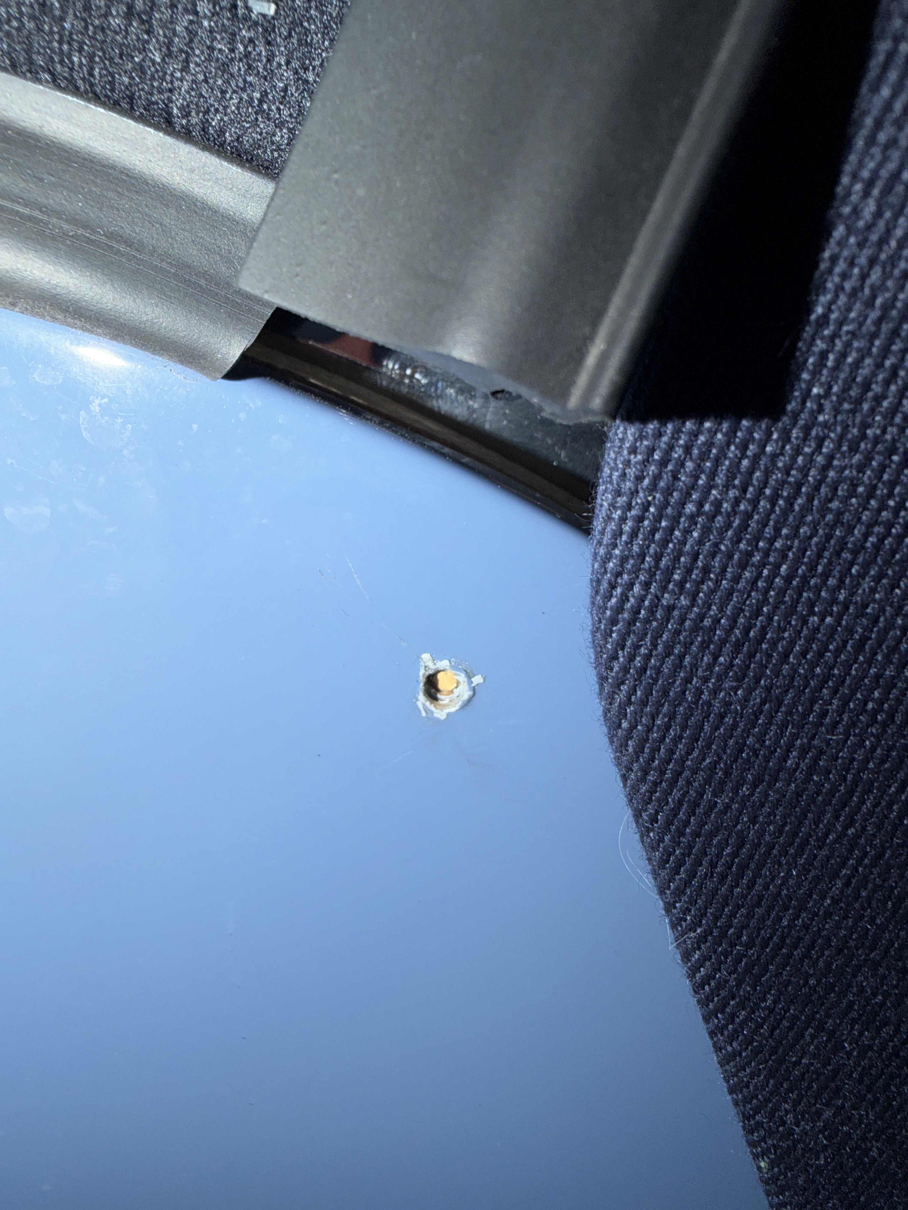

And… 2000 km done! But the car will probably be stored for a while now with the current weather in France and all the salt on the roads. Still, it’s an incredible car to drive. I did run into one issue though, entirely my fault. I saw a few threads here mentioning the same thing: I broke the passenger-side bolt that secures the hood when opening it (I forgot to detach it first 😩).
Do I need to go through the dealership to replace it, or can I fix it myself? If it’s doable at home, where can I find the exact same bolt reference, and how can I remove the broken part that’s still stuck in the hole?

It is a tenax fastener. Ship chandlers or ebay sell them. You need to drill carefully out the old thread
