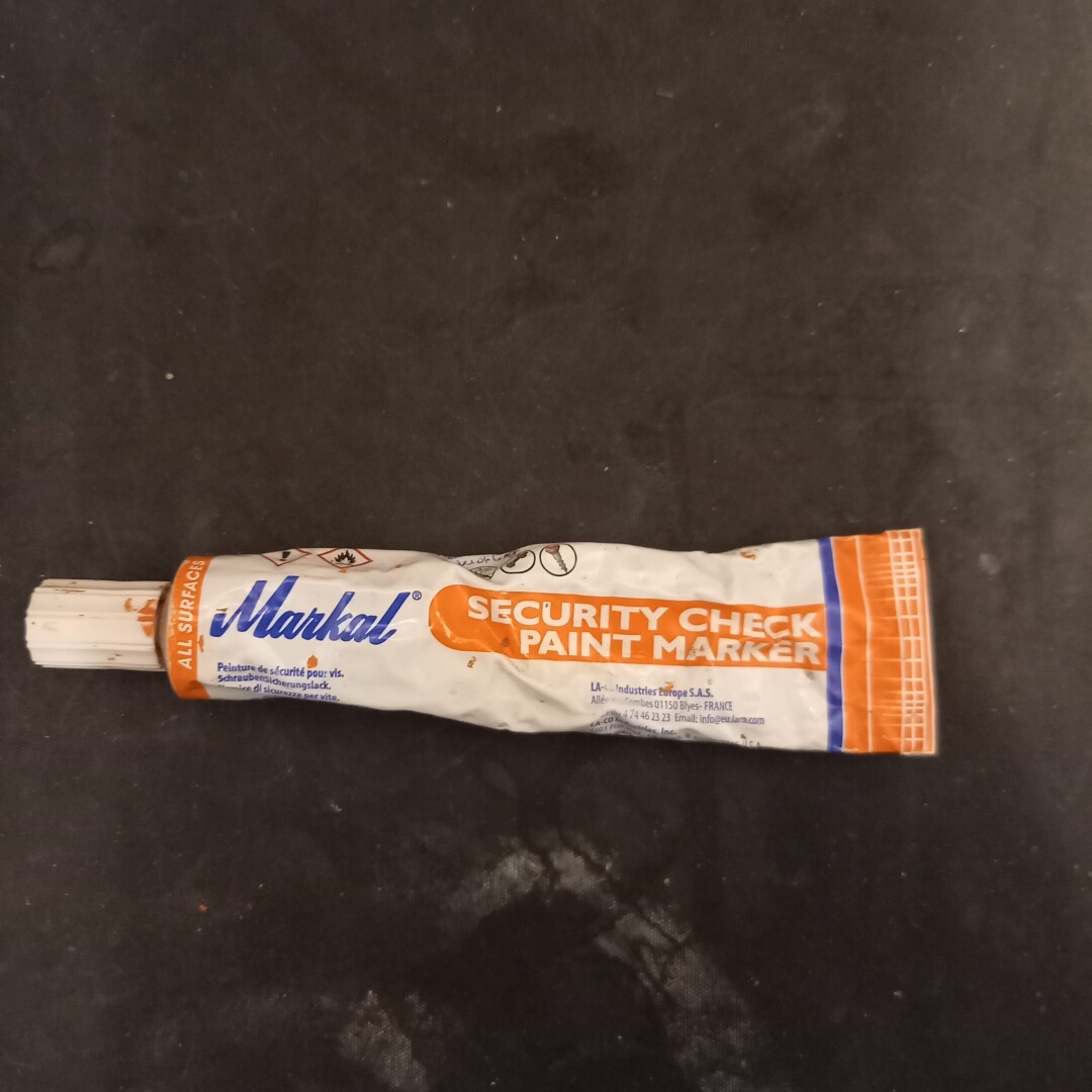

Richard and Sewin given your comments on copper, I think I will fit a copper washer regardless of what I find behind the head of the drain plug bolt and then, when re-fitting, torque it down to about 34Nm (25ft lbs) and see how I get on. According to the internet that's about right for these bolts.
When torquing down bolts and fittings to the correct spec I often feel it's not enough, but it always is. For peace of mind I use security check paint (see below) across the heads of critical bolts and fittings after torquing down so I can keep on eye on things to make sure they are not coming loose. I use this stuff on the sump drain bolt 15Nm on the Zetec engine. On the gear box drain plug after an oil change, on nuts and bolts I have removed around the steering assembly when fitting a new steering rack gaiter. I also use it on the wire wheel nuts. I put a spot across the nut and wheel centre opposite the tyre valve so it is easy to find for a quick check. I also use it on the oil filter ½ to ¾ of a turn once seated, again does not seem enough but always is. If you look closely at the photo you can see the small orange spot. I will have to use a mirror to check the diff drain and fill plugs when the car is on the ground but that's no problem.
Regards Tony
