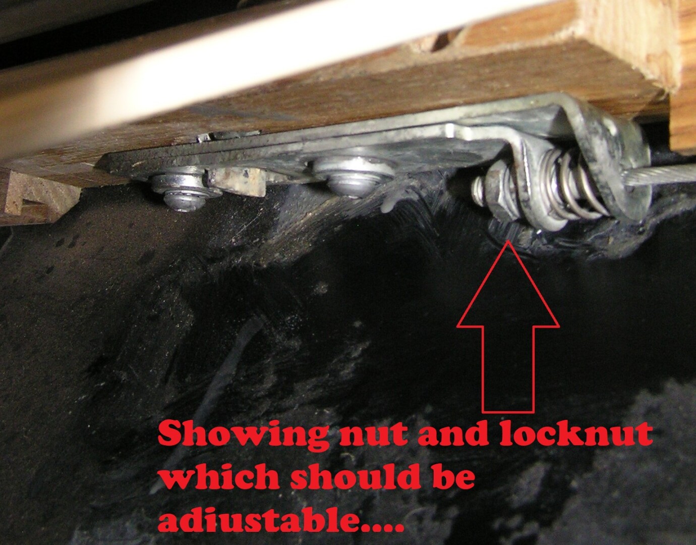

Image here if same as Classics which I believe it is. You won't have a spare wheel on a Plus Six but hopefully louvred removable panel.

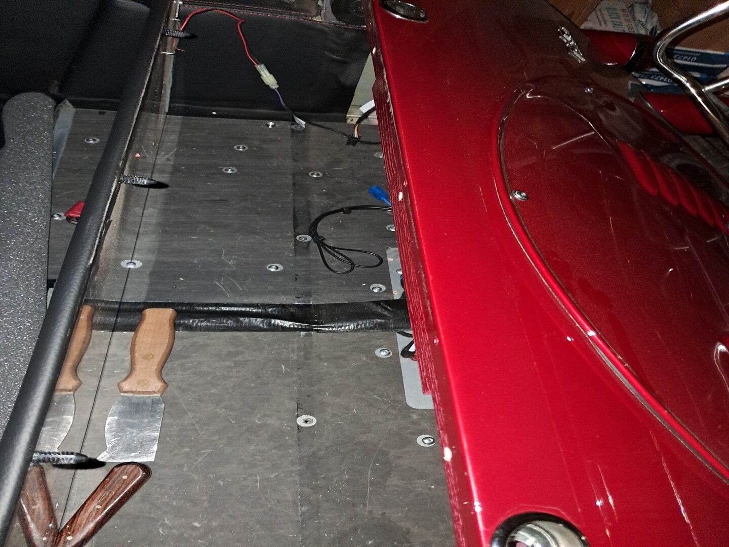

you need to remove the rear upright board with the speakers. 4 allend screw plus a pallet knife to ease out the plastic plugs in the wood.
Here are some pics of getting to the mechanism. I was fitting speakers so didn't play with it.
