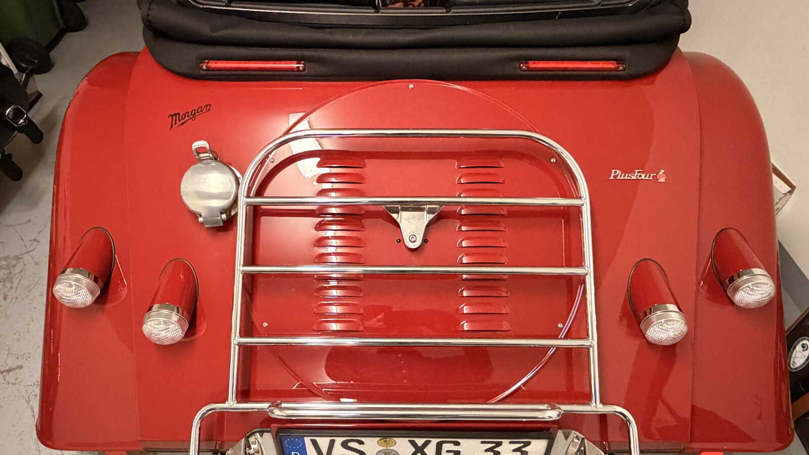

Hi moggi,
Here are the answers to your questions, based on my experience with retrofitting the disc:
2. Yes, the disc is painted to match the car’s color.
3. There are 6 screws used to secure the disc. A rubber pad is attached to the underside. So the disc just needs to be screwed on. If the threaded bushings aren’t in the chassis, your dealer will take care of it (that’s how it was done in Germany).
4. The hole is already there, and there’s a Morgan logo to cover it.
Note: The luggage rack that is mounted with the spare wheel cannot be used when the spare wheel is removed. You will need two racks if you want to use a luggage carrier for both configurations.
Here is a picture of my retrofitted disc. I also have both configurations—one with the spare wheel and one without.
I can’t help you with your point 1. but your dealer should know the answer to that.
