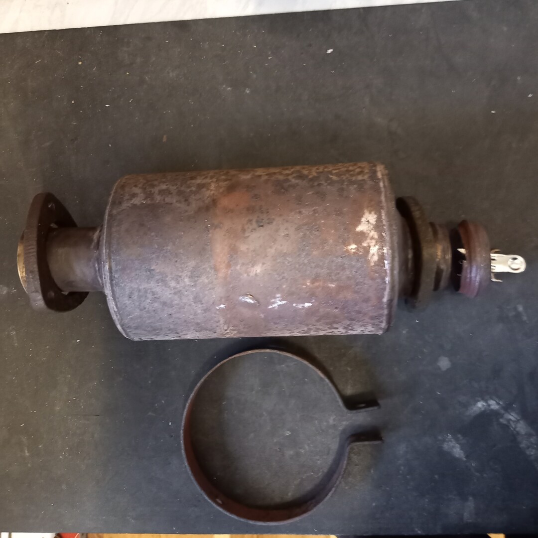

Earlier this month whilst driving along, the exhaust suddenly started to blow. This turned out to be a failed ball joint clamp knuckle adapter that is welded to the Catalytic converter output pipe. The pipe itself looks to be in good condition.

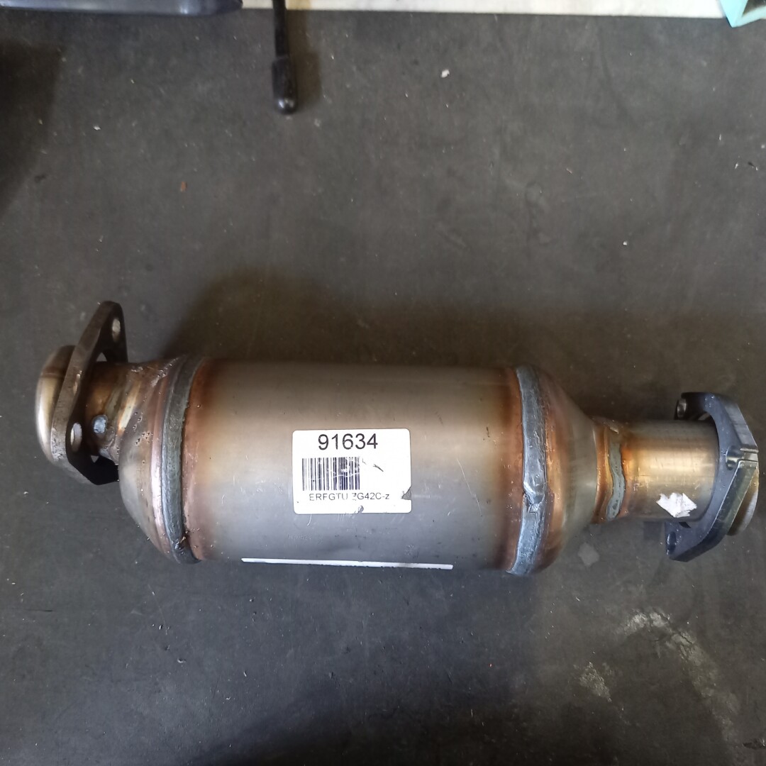

Sourced a new cat converter made by BM catalysts part number BM91634 from this place https://www.ebay.co.uk/itm/143524186403 It cost around £290 but I have since found other ebay companies that sell it cheaper.

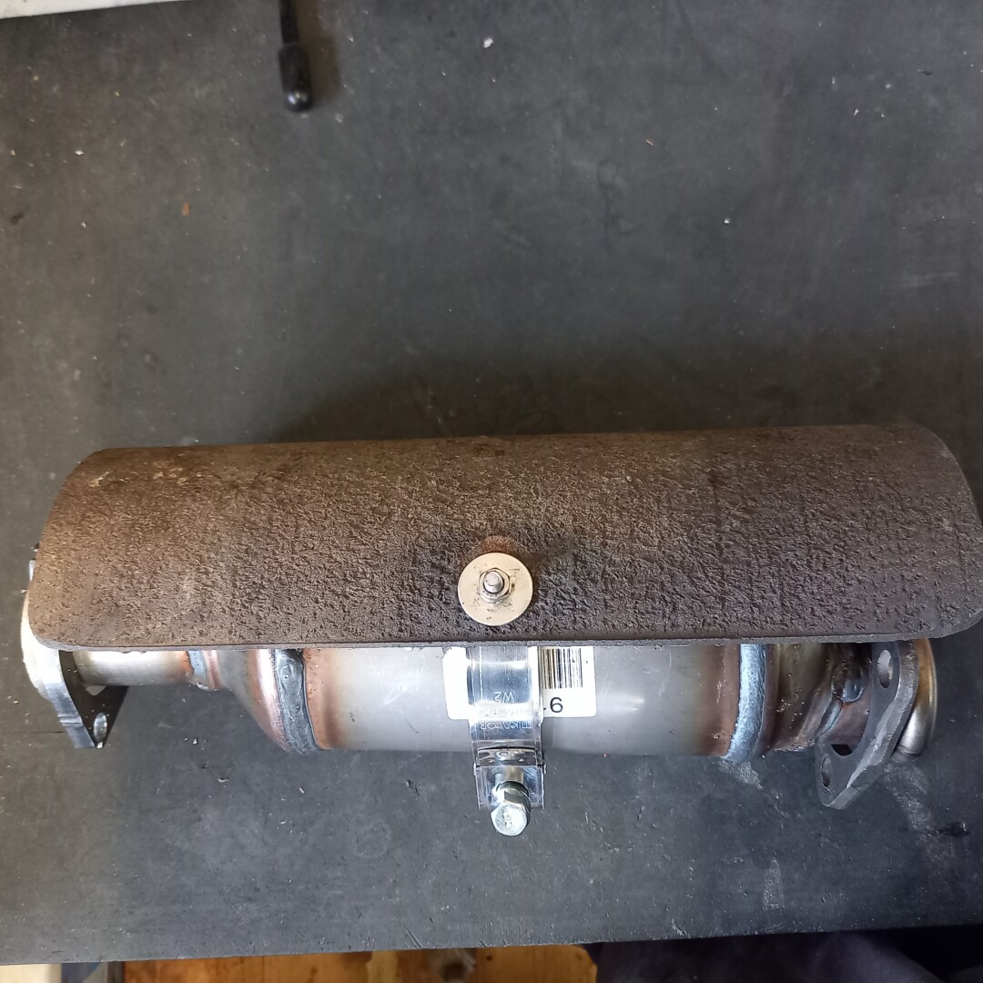

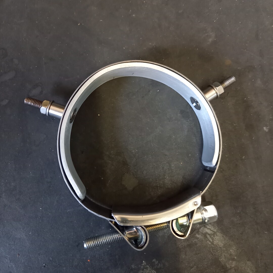

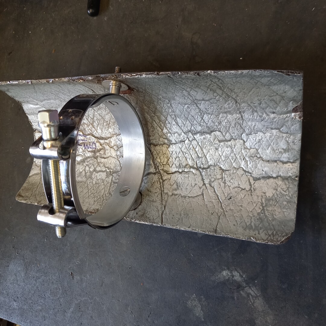

The cat converter has a clamp around its canister that has two M6 bolts countersunk within it, to which is attached a heat shield. The clamp was badly corroded so decided to replace it with a large Mikalor supra W2 heavy duty stainless steel hose clamp and a aluminium spacer made from a 3mm x 25mm strip cut from a piece of 3mm sheet aluminium. I managed to form this strip into a “C” shape around a 4 inch sewer pipe straight coupler. I sourced the clip from this place
https://www.bearingboys.co.uk/Mikal...r-Super-W1-Heavy-Duty-Hose-Clamp-86215-p
The original cat converter is about 130mm in diameter across the canister, the replacement is smaller at 100mm diameter. I turned out a couple of stainless steel spacers to fit over the M6 bolts so that I could use the original mounting holes in the heat shield see second picture.
Out of curiosity I spoke to Andy at BHM and enquired about the cost of a MMC replacement cat converter. That was in the order of £1000. Andy said they fit the BM ones and they are o.k. as long as you get them nice and hot for the MOT.
Also interestingly the one listed on Melvin Rutter's site is £1075 plus pp and the listing states they are slightly smaller in diameter than the original. I can't help wonder if this is a BM one. If so someone is adding an eye watering mark up!!
I think the original cat converter is salvageable as it looks to be in reasonably sound condition. The question is, is it possible to grind off the remains of the adapter and its weld and weld on a new one without damaging whatever is inside the cat converter we will see.

Tony, looking at the old cat I'd call it dead!. Think you've gone in the right direction and to be honest I think the Morgan option is only just good enough hot anyway. I have a spare new Morgan option for when the time comes for may current one to slink out the door. When I acquired my spare dealers were quoting £1300 for it so guess what.... looks like classic spares are coming down. Anyway I didn't pay that, just £300 so couldn't refuse it and you are so right, the general mark up for nothing remarkable is truly atrocious!

Sewen its not just because I am a tightwad (which I am) but the old cat looks a lot worse in the picture than it really is, the corrosion is just surface rust and its only done around 30K miles. The failed ball joint adapter is mild steel unlike the cat itself it sticks to a magnet. I can get a new stainless adaptor for about £25. The thinking is the old cat has got the car through the MOT every time without fail, the new one is an unknown quantity. As it happens I get on extremely well with my local MOT man Stewart. Unfortunately he recently had to undergo spine surgary but is expected to make a full recovery, however, for the moment is off work. My plan is to wait until he is back and then get him to run the car through an emissions test and see how the new cat performs. There should be plenty of time to do this since the MOT is not due until November. If all is well then I will probably ditch the old cat. If not then have a go at getting the old cat repaired. The only question is would it be possible to grind off what's left of the old adapter weld and weld on a new one without damaging the cat's contents.

Just an update. I took the car to my local MOT man today. The MOT is not due but I wanted to check whether the new CAT works OK and that the car's emissions are within limits. Happy to say that BM CAT works fine, however, I have a slight exhaust leak at the joint between the outlet of the CAT and the exhaust pipe this upsets the lambda reading. I believe the joint is referred to as a 'ball joint'. The CAT has an adaptor welded to its output pipe which has a ring around its perimeter. The ring fits into a bell shape on the end of the exhaust pipe and this joint is held in place with a triangular shaped thick steel plate either side of the joint ( see right hand side of my first photo and left hand side of the fourth photo ). The plates are pulled together with three nuts and bolts, one at each corner of the triangle. Does anyone know if there should be some kind of 'sealing ring' fitted between the two faces of this joint, or is there any compound that will not affect the CAT converter that could be used to help seal the joint.
