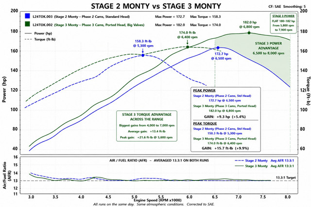

That’s some good gains - area under the graph - especially the torque lift. It really hangs on at the top.
If I read your graph right - that’s 2000rpm’s worth of 160-170 ftlb
To help better bring the gains to life and make them more clear to read, I've taken the true data Stage 2 Monty recorded a couple of years ago at Surrey Rolling Road, and the true data recorded by Stage 3 Monty also at Surrey Rolling Road last Staturday, and fed it all into AI.
The idea is create one final comparrison graph as shown below that clearly demonstrates what we've achieved from adding the A.L Developments ported big valve cylinder head and Newman Phase 3 cams.
As we can see, despite not hitting the peak horsepower number we predicted, we took the already very torque focussed Stage 2 Monty recipe, and created the even more torque rich Stage 3 Monty.
But it's not just about torque, Monty properly revs now too. Unlike Stage 2 Monty who fell over at 6,500rpm, Stage 3 Monty now cleanly revs out to 8,000rpm. Stage 3 Monty holds onto to his horsepower advantage from 6,500rpm to 7,900rpm and because Stage 2 Monty gave up at 6,500rpm, the gap between Stange 3 Monty is huge and just keeps increasing!
A pub bragging rights peak horsepower number is all well and good, but I hope the above graph now clearly shows why I wasn't that bothered Stage 3 Monty failed to make 213hp?
As we can clearly see now, Stage 3 Monty is making more horsepower and more torque everywhere, and right where you can actually use it, in some areas the gains are huge for naturally aspirated tuning, so I can now genuinely say.....
"My work is done" woohoo

You now have a fantastic “wolf in sheep’s clothing”…ft. lbs where you need them and enough horses to do the job exceptionally well.
If it were mine, I would stop there and enjoy it as much as possible. You have met your challenges superbly.

Dave.... you're there! you've skinned the cat and I think in your wildest dreams you had only hoped for the performance and manners you have achieved. Remember that extra 30bhp was a target figure of what might be possible and I think you have achieved the absolute whilst retaining all the advantages of the current system. The mog is so light I don't think that you would feel that little extra in that you have to put it down on the road to benefit!
Now is the time to enjoy monty! A truly remarkable car!

Thanks chaps, great advice from all three of you clap
Creating the cleaner dyno comparison graph has really helped to identify the true horsepower and torque gains from Stage 2 to Stage 3 Monty.
What's super rewarding to see is, to some degree or another, there are genuine horsepower and torque gains literally everywhere.
1. While we're missing data from idle to 3,000rpm, Stage 3 Monty is definitely smoother and more flexible in this important drivability window, so I'd speculate the 10 lbs/ft advantage we can see at 3,000rpm is also present lower down
2. From 3,000rpm all the way out to 6,400rpm Stage 3 Monty not only hangs onto this torque advantage, he decisively builds on it so by 6,400rpm Stage 3 is now serving up an impressive 16 more lbs/ft of torque over Stage 2 Monty
3. During the same pull Stage 3 Monty is also delivering a meaningful horsepower increase, rising from 5hp more at 3,000rpm to a healthy +10hp at 6,400rpm
4. From 6,400rpm where Stage 3 Monty is not not only serving up 10 more horsepower and 16 lbs/ft more torque the gap between Stage 2 Monty gets even wider, by the time Stage 3 Monty reaches 7,000rpm he's making a whopping 33hp more than Stage 2 Monty. As you might imagine, because that additional 23hp is delivered over a very small 600rpm window the push it produces is noticeable
5. From 7,000rpm to 8,000rpm the horsepower difference surges rapidly from +33hp to a game changing 50hp horsepower more than Stage 2 Monty at peak. Not only does Stage 3 Monty hold onto his horsepower in this top end zone where Stage 2 Monty would have long since given up and gone home, the torque difference between the two states of tune is now also huge, at 7,300rpm Stage 3 Monty is serving up 45 lbs/ft more grunt than Stage 2 Monty!
In summary, it's clear to see there are good gains everywhere and where I can genuinely enjoy them, with 30 more lbs/ft of torque arriving 6,800rpm and 33 more horsepower at 7,000rpm, this is the sweet spot where during enthusiastic driving on the road I would be looking to select the next gear and then enjoy that additional push all over again.
On the track where more revs can be used safely, taking Stage 3 Monty further is a no-brainer, with an additional 45 lbs/ft of torque arriving at 7,300rpm and 50hp more horsepower at 8,000rpm than Stage 2 Monty could muster at the same engine speeds, because Stage Monty 3 Monty has held onto all the power he made 1,000rpm earlier, it's now definitely worth taking the engine to 8,000rpm and beyond.

Nice work Dave and a superb result. Those graphs are a testament to your skill and knowledge. Monty must now be a delight to drive.
