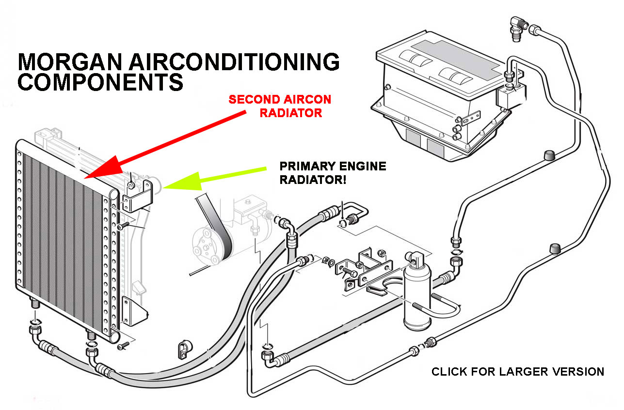

Thanks for the helpful replies. A physical inspection showed nothing bashed or broken. On the basis of a little knowledge is a dangerous thing but no knowledge at all is worse, I found this schematc elsewhere on TM and some useful info online https://appliancesfirst.com/what-does-car-refrigerant-smell-like/ It's booked in to to local A/C place next week, I'll report back.
