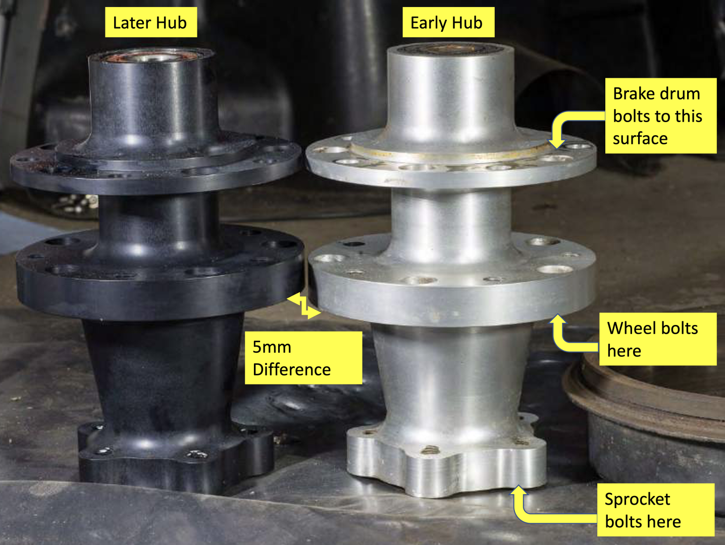

The drive belt should run fairly much on the sprockets if they have guide plates on both inner and outer faces, front and rear. Not easy to achieve but it can be done, a straight edge along the sprocket faces helps a lot when setting this and the bevel box and/or swing arm may need adjustment to get it all in line.
Early cars didn't have the belt guide plate on the rear wheel sprocket outer face but they also had a different spacing for the sprocket on the rear hub, silver hubs, later cars had a black hub with different offsets. If you have the early set up then the belt will run about 3 or 4mm off the outer edge when set up correctly.
For later cars the guide plates should be just that, guides, not restraining plates. Once aligned and tensioned correctly the belt should stay within the guide plates without any excessive side loads. You should also have about 3mm clearance between the belt and the tyre sidewall, although some tyre brands are a bit "fat".
Just for clarity, the only difference between early 'silver' hubs and the later 'black' ones is the position of the wheel mounting flange - with the later one (theoretically) giving 5mm additional clearance between the belt and tyre. The sprocket mounting flange is identical between the two.

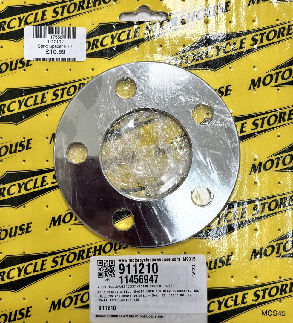

On my early 2012 car, I run a 1/4" spacer between the sprocket and the hub flange and my belt tracks quite nicely. This is with a black hub and Fabian sprocket. The inner diameter of the spacer does need to be machined out slightly for fitment to the Morgan hub. This isn't necessarily a recommendation by the way because we all know that each car is different!
