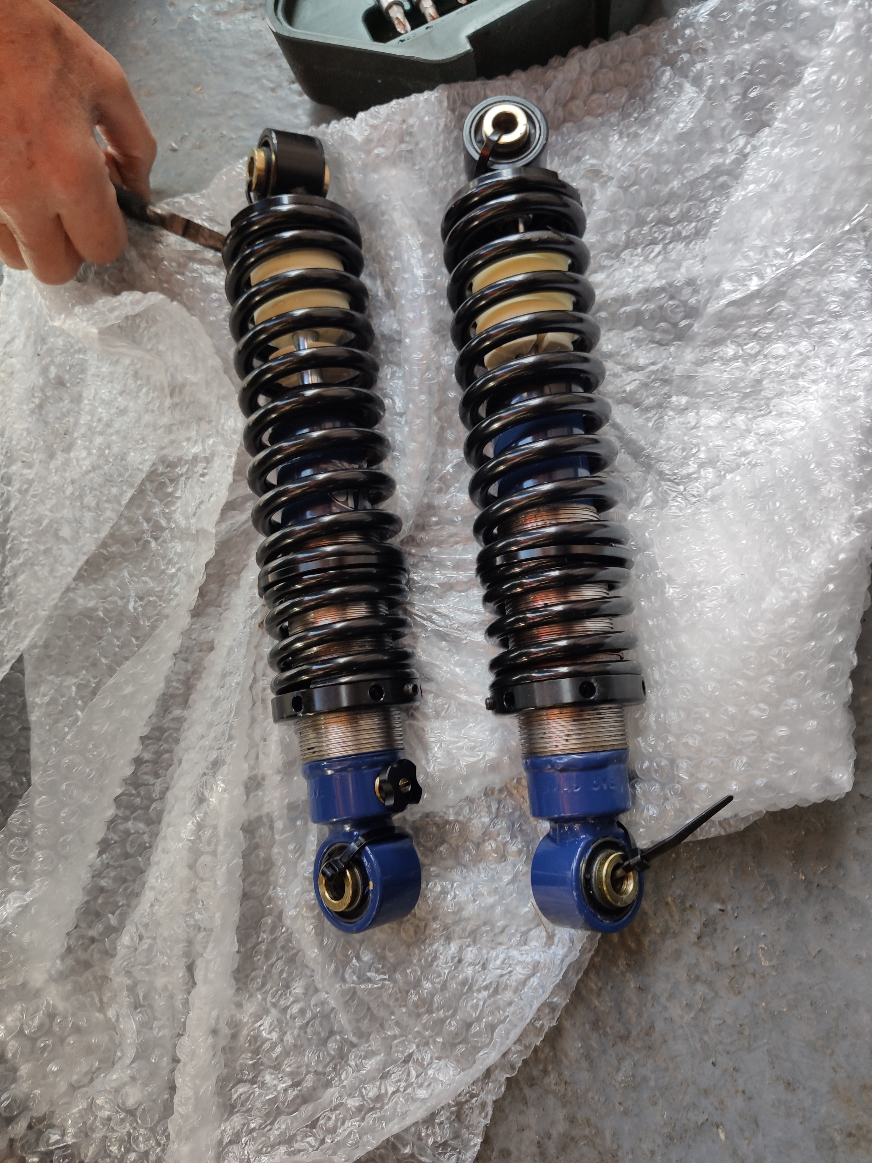

Yes the factory five link 3.7 Roadster uses stiff rear springs to limit roll which causes an over firm ride given you're close to sitting on the back axle. Adjusting the SSL front damping will make little difference therefore and needs to be several clicks above minimum (about halfway) to control front adequately.
The answer are the dual rate rear coil overs offerered by SSL specifically for the factory five link Roadster Reg. These give an initial soft ride then stiffen up on greater suspension movement to limit roll better than OE. Best of both worlds. They also offer adjustable spring pre-load and adjustable gas assisted damping. I've never needed to adjust the spring pre-load on mine as absolutely no issues, even two up withswmbo's huge suitcase on the back and full tank, from supplied settings as shown below.

Reg I think it is very subjective. I prefer the leaf springs but I have driven a 5 link Brooklands Roadster & I didn't find the ride harsh at all. Though that was the SSL kit not the MMC one.
Certainly it was more controlled under load but not enough for me to change. Richard has the set up so I would follow his advice.

I can concur with Richard's comments as I have the same spec on a 3.7 and too felt the need to upgrade the rear coilovers to SSL's version which greatly improved the front / rear damping balance

Just to add Reg, I was told by Dan at SSL I was his first client to have the rear suspension of his Morgan attended to before the front. It seems a knee jerk reaction to blame the front end for any comfort issues and it took a third party to confirm to me it was in fact the rear suspension causing discomfort over Norfolks worst potholes - take your pick. After his prototype solution to the rear was fitted I noticed the improvement to ride before even leaving the drive of his premises. The first bend I took gave an instant through the seat of your pants improvement in cornering as well that I wasn't expecting. I quickly realised this was due to reduced rear roll giving improved tuck in.
The improvements to rear then focused my attention on the front suspension deficiencies and I purchased and fitted the SSL RS kit to work in harmony. I understand you already have this fitted and were expecting such alone to improve ride comfort - you really need both.

Shouldn't take you more than 30 minutes to fit them yourself Reg. Remove tool tray. Jack up under diff. Then add axle stands each side and a second jack to just take wheel weight on one side then the other which will allow each coil over, one by one, to be unbolted, slid off and replacement fitted.
