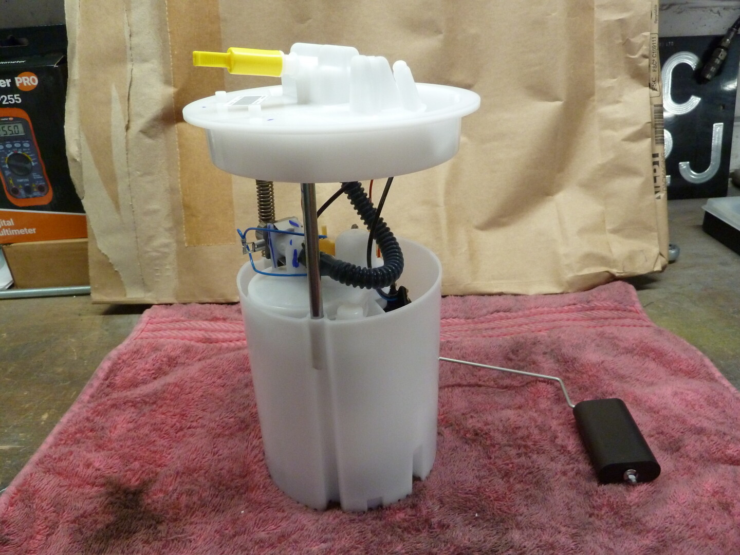

Now it starts to get difficult without being able to look for fault codes, but of course MMC locked off the GDI ECU to dealers only. So I’m a long way from any dealer with an undriveable GDI. I decided to try one final thing. BHM have had a couple of GDIs with fuel pump issues. I ordered a fuel pump. BHM didn’t have one and neither did Morgan, so that took a couple of weeks to arrive. Fitting a fuel pump into a GDI is a challenge. This will vary across models because the tanks changed shape. But the problem with mine, is the the tank unit is tall, and clearance is not. Over the top of the pump is an ash crossbrace. So either that comes out, or you drop the tank. Such fun. The ash crossbrace thankfully is not glued, but has two crosshead screws at each end, buried under the slope of the cockpit rear panel, and the edges are covered by the trim panels which are glued in place. The only way, is to use an offset screwdriver in the confined space and take each screw out, basically at a quarter turn a time. Under the spare wheel aperture, is about six wood screws. Then peel back the trim, and attempt to free off the ash crossbrace. It eventually gave way. The pump is complex and includes the sensor, but only has a single electrical connection and the output pipe, which is held in place by a sneaky and rather fancy ‘C’ clip. After freeing off the rather large plastic ring fastener, and freeing off the rather fancy rubber seal, the pump then lifts out with a pint of petrol going everywhere. Obviously before any of this happened, I disconnected the battery. The new pump then slots in, noting the correct position, and I lubricated the seal with a smear of vaseline, because it is ribbed and a rather tight fit. A torch inspection of inside the tank showed nothing unusual. No contamination of junk, and no trace of water globules.
After re-assembly, I was rather disappointed that on starting, there was no change, and I began to realise that it was time for the experts. Finally, I tried a new relay, the one which resides under the spare wheel, and that made no difference. So here’s the thing. The fuel pump in the tank is a conventional low pressure pump. It’s a bit fancy because there is a solenoid in there, but it’s not the high pressure delivery which the GDI needs. The high pressure pump is mechanical and is driven off the offside camshaft. From the high pressure pump, there is a steel fuel pipe which feeds the fuel rail on the nearside of the engine and this is where the injectors are. The high pressure pump has a bleed return to the tank, controlled by a solenoid on the pump. This solenoid is controlled by signals from the crank sensor, the cam sensors, and the ECU, which will be compiling a load of data I guess, about speed, throttle position and O2 sensor readings, and probably more. Something in that system is faulty. It might be the connection between the accelerator and the throttle body, but without looking at the error codes, I could end up changing everything and still not find out what’s going on.

Fuel pump details
"Access"
When the frame crossmember is removed - just enough wiggle room.
