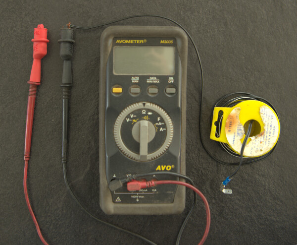

A pic of my meter`s extension lead, the Halfords price label denotes £2.29 so my guess is that I may have had it for quite a while, I suspect something similar may still be available and at less cost than a pucka set of leads...? Of course the crimped on male/female connector was an extra cost... (-:
